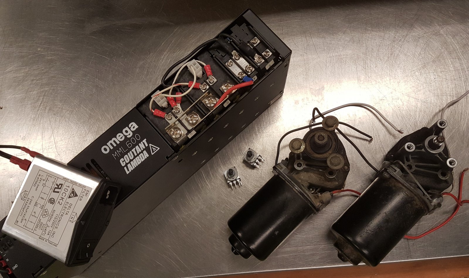

    Pic of PSU is attached.. I do not have grounding on my 220V in my house. (Maybe that's also the problem) I'll see if I can isolate them/ and how.
    Thanks mate.

    If you do not have a grounding system in your house (which is very dangerous) it would be enough to put the simulator in a different socket of the g27 and the computer.

    Grounding only in the wet.....bathroom. I'll find out how to isolatie it

    I put the pedals on a piece of wood. Put the PSU on a different socket...and it all works fine. No bad smell from burning cables anymore.
