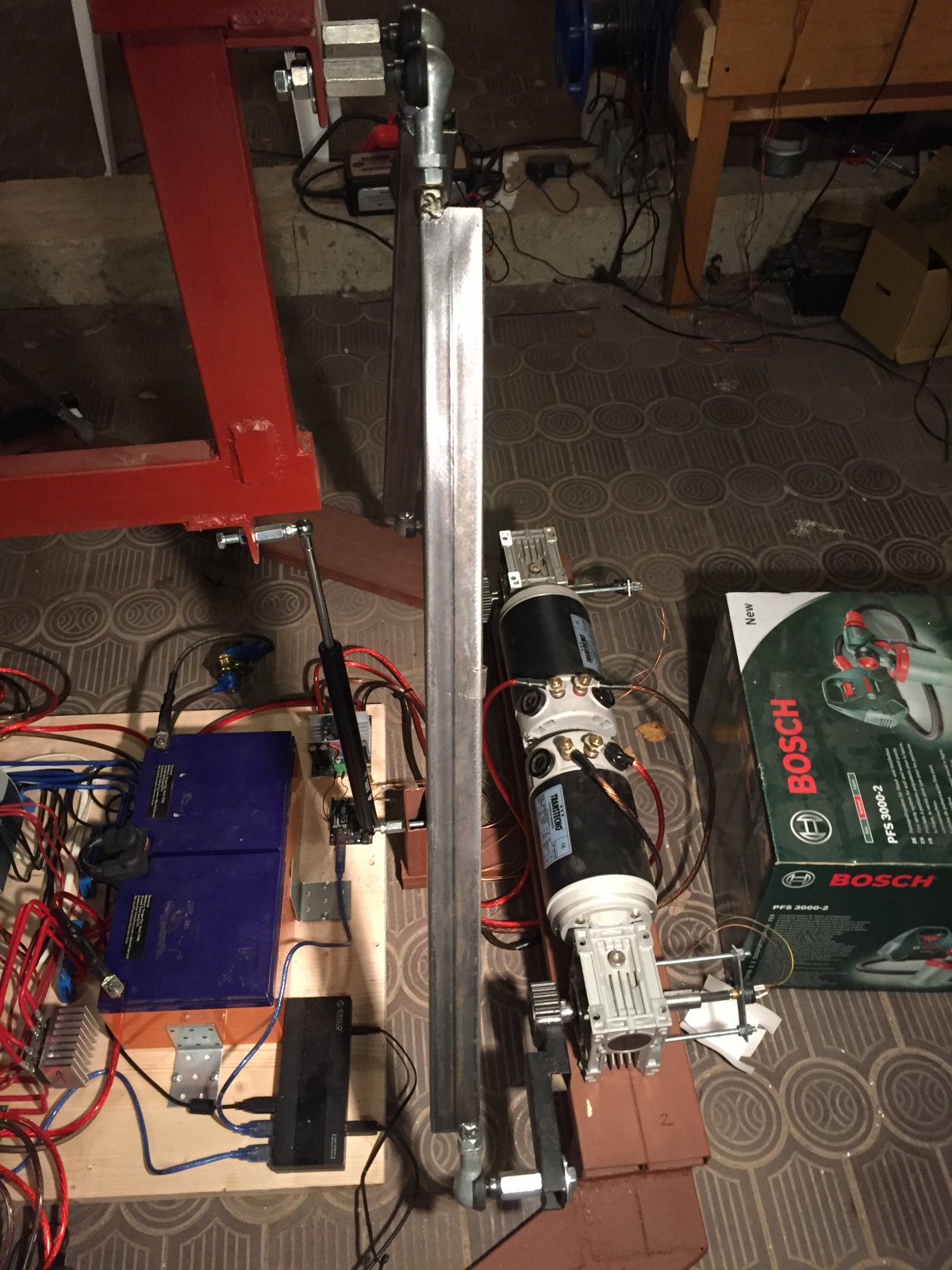

    Decided to replace the threaded rods with rectangular tubes for more rigidity:
    Unfortunately there's still quite a bit of wobble due to huge backlash in my gearboxes:
    I tried the rig with No limits again today and the movements are not smooth at all. Not yet sure if that is because of poor tunings or that backlash.
    Here's how it looks with my wife riding:

    All wormdrive boxes will have some backlash, and while I have no experience with the gearboxes you are using it does seem excessive, exacerbated by long levers.
    This is what I consider normal backlash:

    I had to fight yet another problem when testing the rig yesterday.
    The issue was that when two motors controlled by a single Arduino were positioned so that one pot returned something close to 0V and the other one returned something close to 5v, Arduino's analog input connected to the lower voltage pot started to show terrible noise.
    I checked the wiring, tried adding capacitors -- nothing helped.
    Eventually the problem was solved by modifying the SMC3 Arduino code to make three consecutive analog reads instead of just one. I do not have an academically formulated explanation of the cause, but it appears that with the frequency at which SMC3 operates, the input of Arduino does not have enough time to make a proper reading when there is a large voltage difference between analog inputs. Issuing several analogread commands in a row takes care of this.

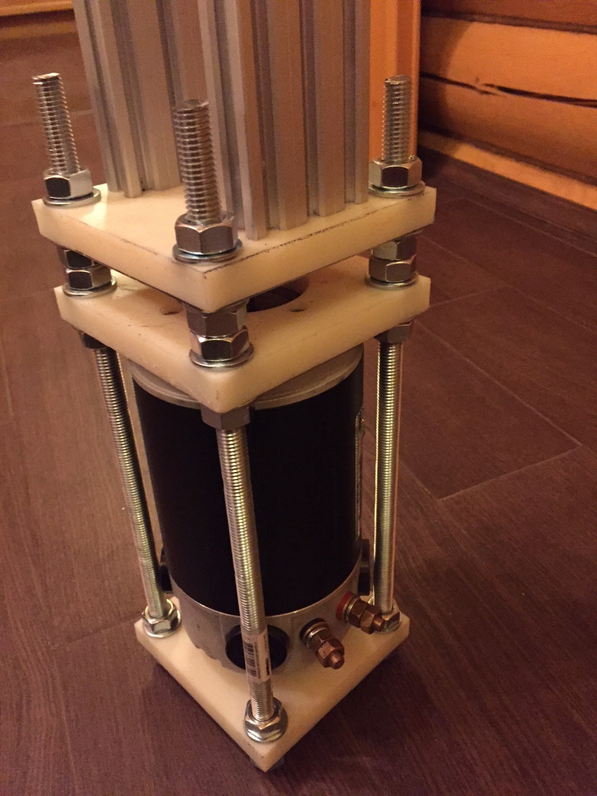

    Instead of learning to live with the gearbox backlash I decided to treat it in a radical way and to move the whole thing to linear actuators.
    Big thanks to @wannabeaflyer2 and @SilentChill for very detailed info on how to do it!
    Here's what i have now. The screws and some other stuff should be delivered this week, so I hope to have first prototype ready during the weekend.
    • Like Like x 6
  12. SilentChill
    2,653
    20,658Coins
    +3,592 / 34 / -0
    Looks lovely and neat, did you use a CNC to cut it all out ?
    Don't thank me I just jumped on the band wagon :D its all @SeatTime and @wannabeaflyer2 hard work
  13. Grigory
    Grigory Active Member Gold Contributor
    Jul 6, 2016
    202
    Moscow
    224Coins
    +305 / 1 / -0
    3DOF, 6DOF
    Yes, I have a small tabletop CNC router, which cuts PA6 plastic just fine. With PA6's relatively low friction, I may be able to do without linear bearing on top.
    Well, it was your build that inspired me for the whole process, so thank you for that anyway :)

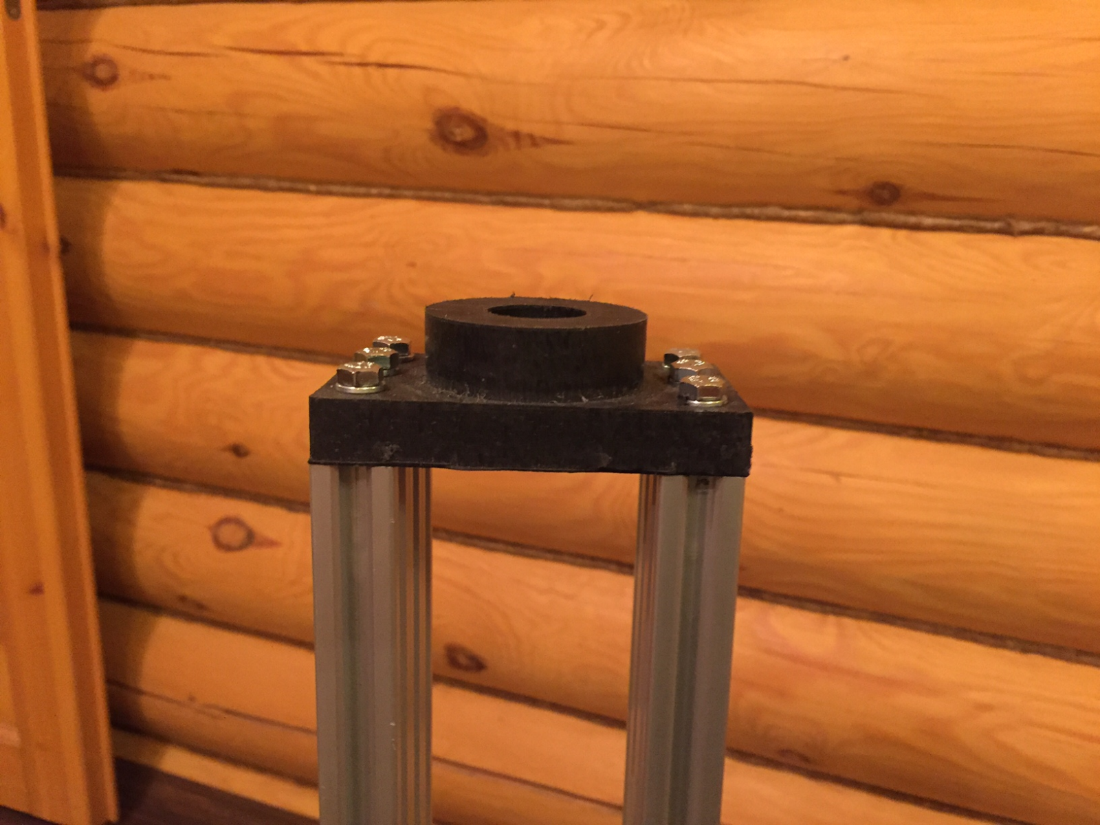

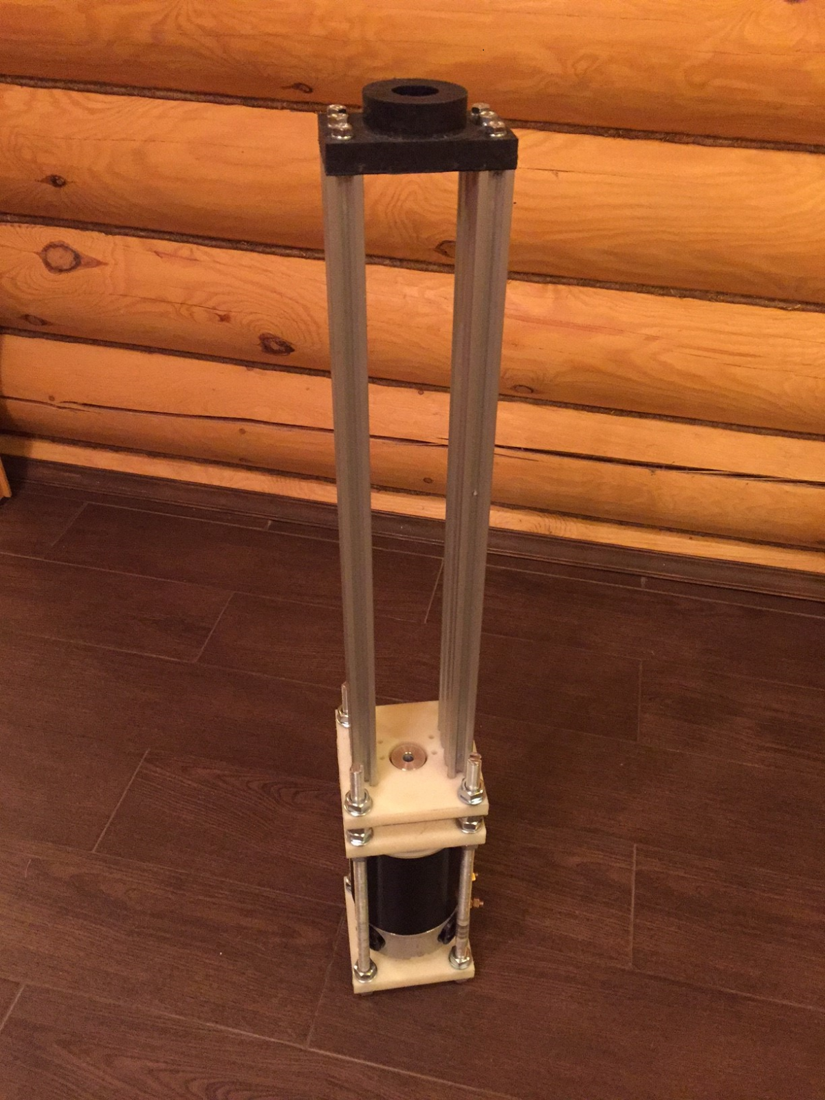

    The parts from aliexpress finally arrived and I managed to assemble the first actuator this weekend.
    The parts list is the same as in @SilentChill 's build, however I am using Sabertooth+kangaroo combination and quadrature encoder for feedback instead of potentiometer.
    Everything seems to work quite well after completing Kangaroo's autotune routine, however I have a problem with noise and vibration. I suspect that the cause could be that I had to invert the ball-screw nut to simplify fixing the carbon tube: I need the flat flange to face upwards, away from the motor. The ballscrews came from China with the flange on the motor side of the screw.
    I am right assuming that the nut is symmetrical and should work absolutely the same in both orientations?
    Here's how it sounds now:
  15. SilentChill
    2,653
    20,658Coins
    +3,592 / 34 / -0
    Sounds ok to me they are quite loud going at full speed.
    I don't think inverting the screw will make any difference though it's the same either way, just as long as you got all the bearings back in correctly :)
