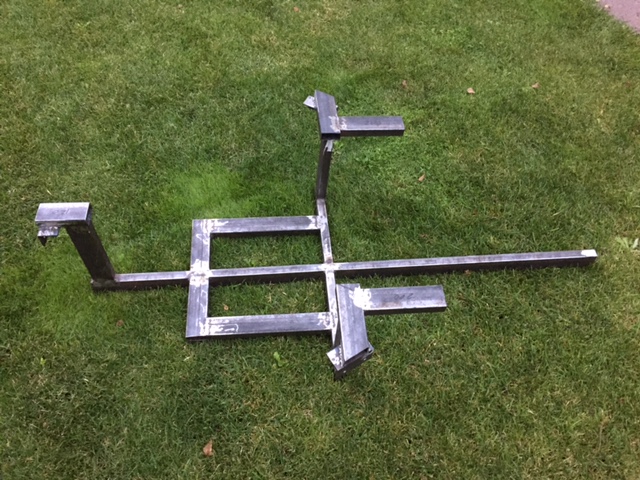

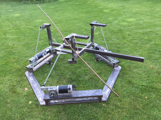

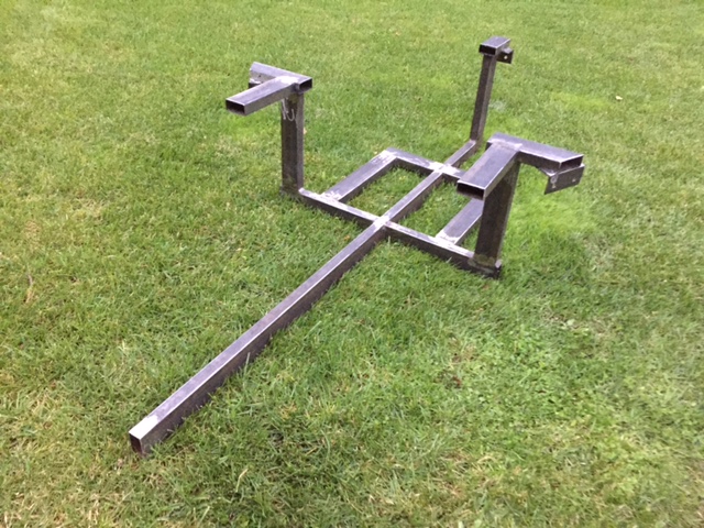

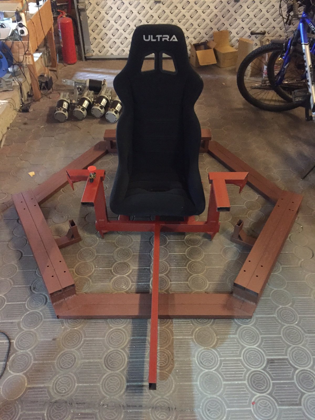

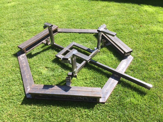

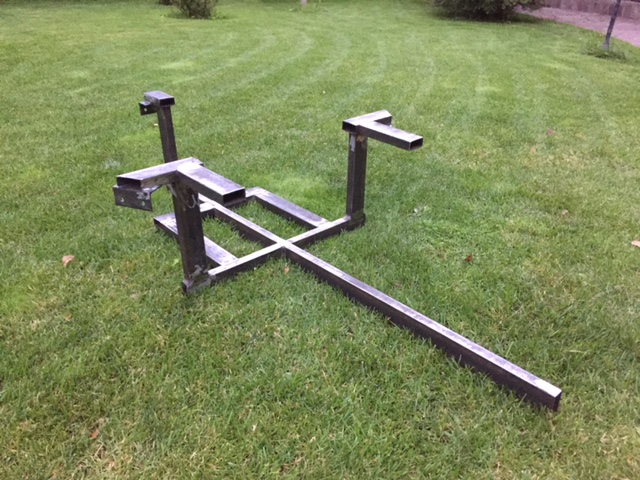

    I decided to modify the cockpit to better suit a new seat that I purchased to replace the burned one.
    Here is the result:
    Mechanical part seems to be mostly ready (I use one motor for testing electronics, so the stick works as a place holder for now):

    be sure to set your start/rest point at 90degrees.
    keep it up. it looks awesome so far.;)
    edit: i see it is correct on your model. Sry if you are already aware.....

    Yup, thanks :) it will be 90 degrees between the rod and the lever when gas springs are in the middle of their travel.

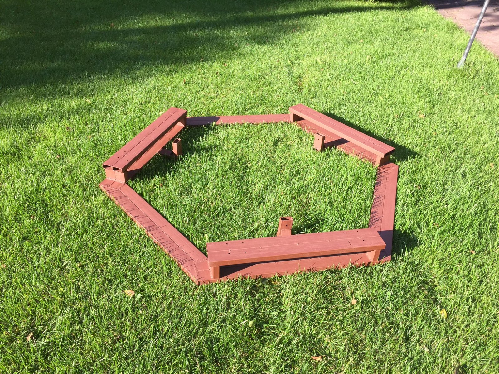

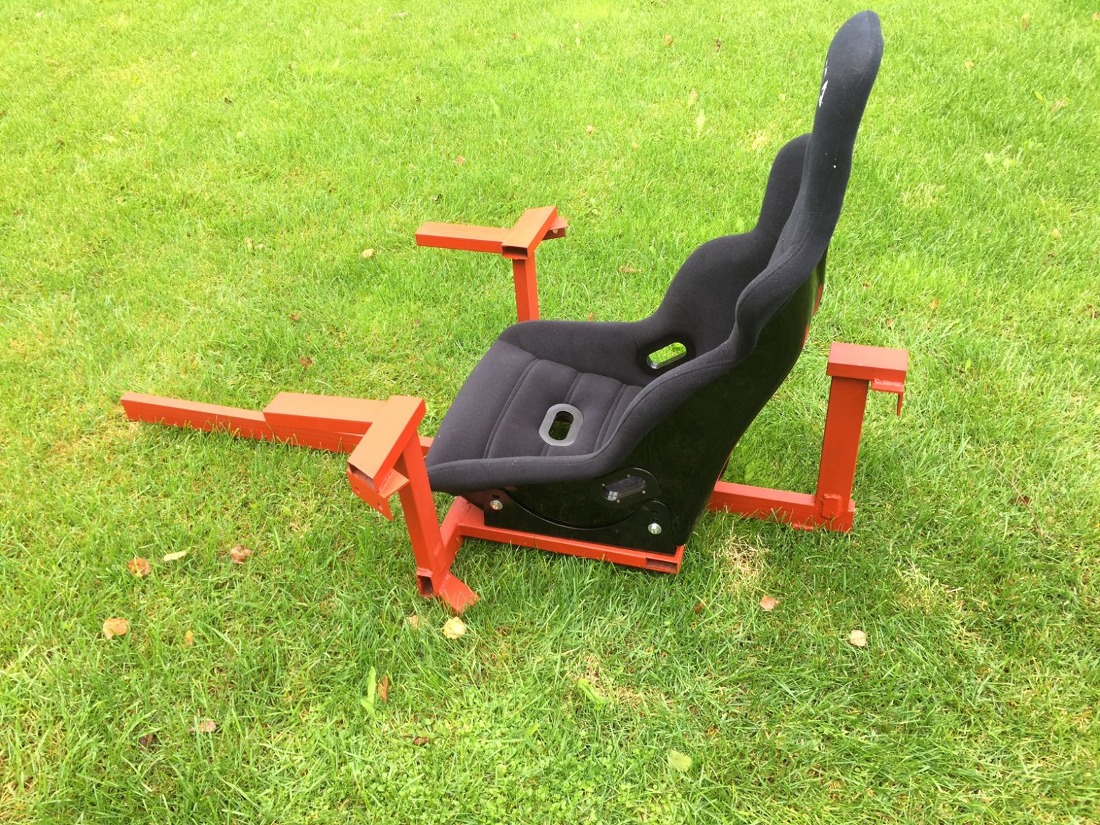

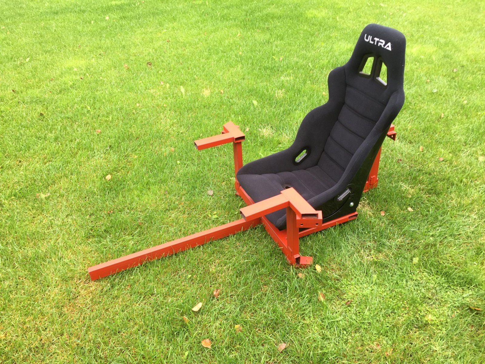

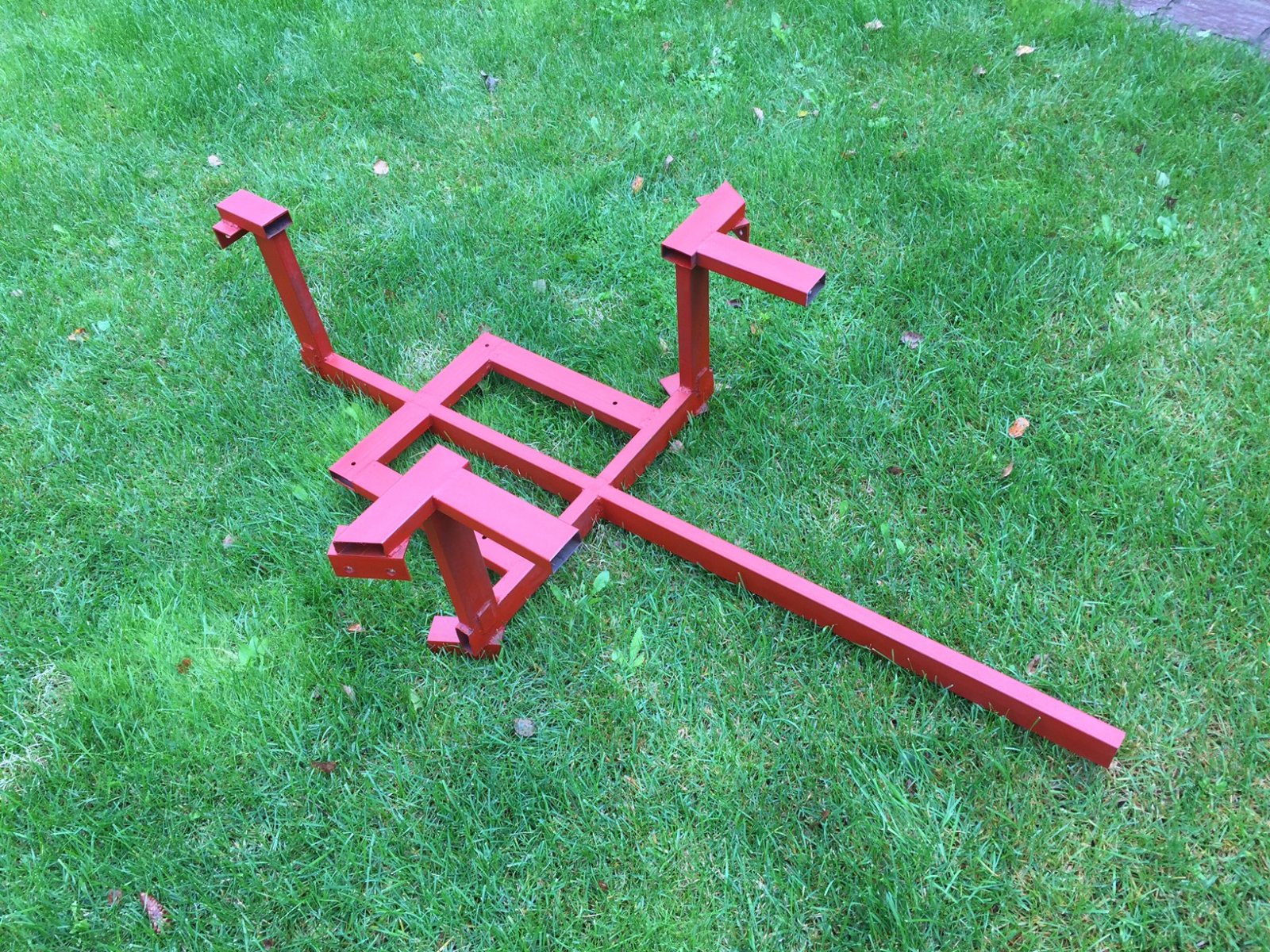

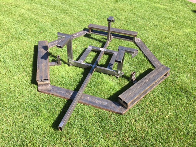

    Another weekend and some more progress.
    Finally painted the base:
    and the moving platform:
    Installed the new seat:

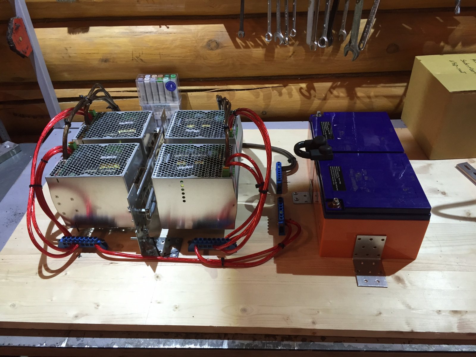

    Started to put the power supply wiring together:

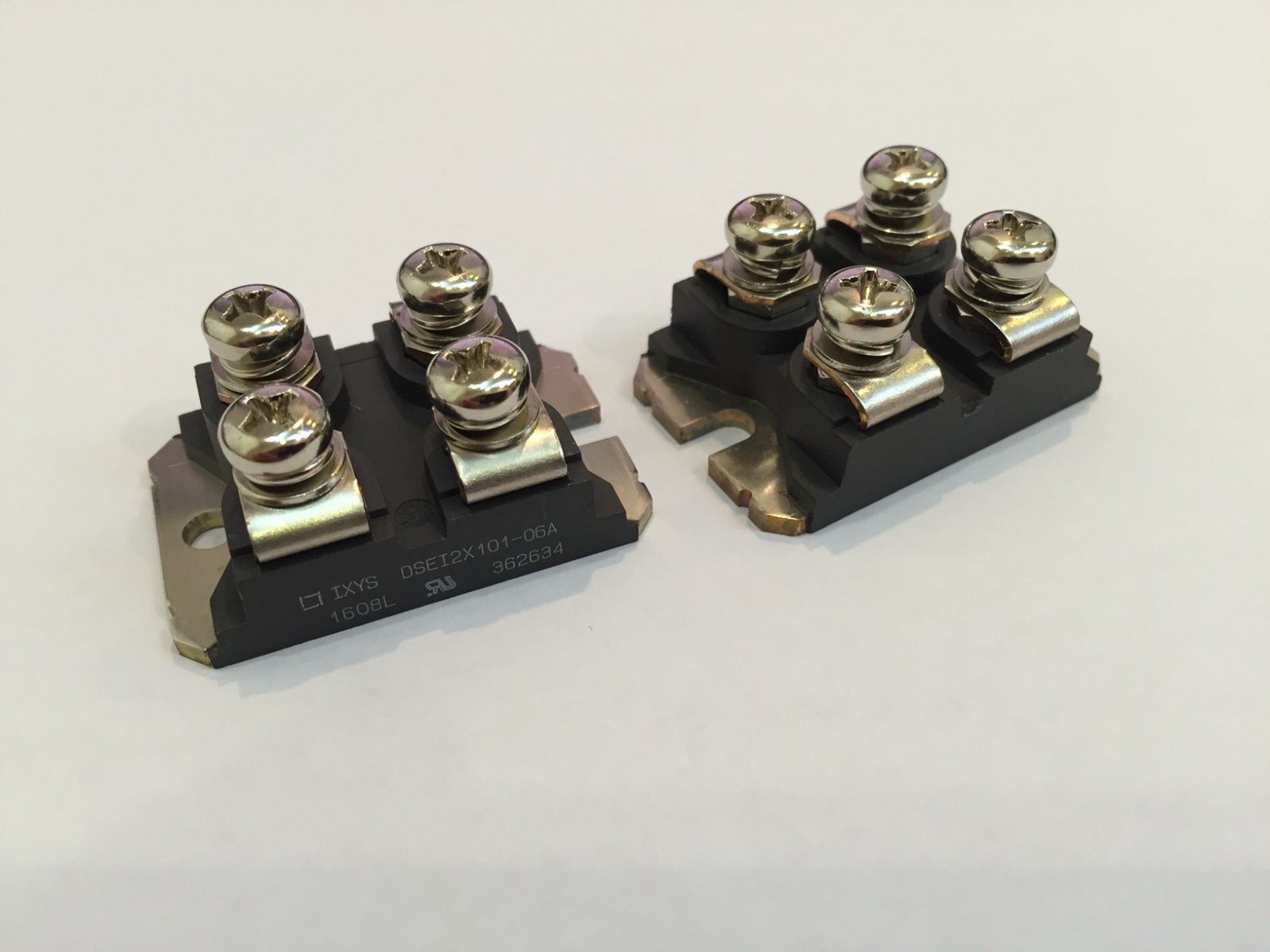

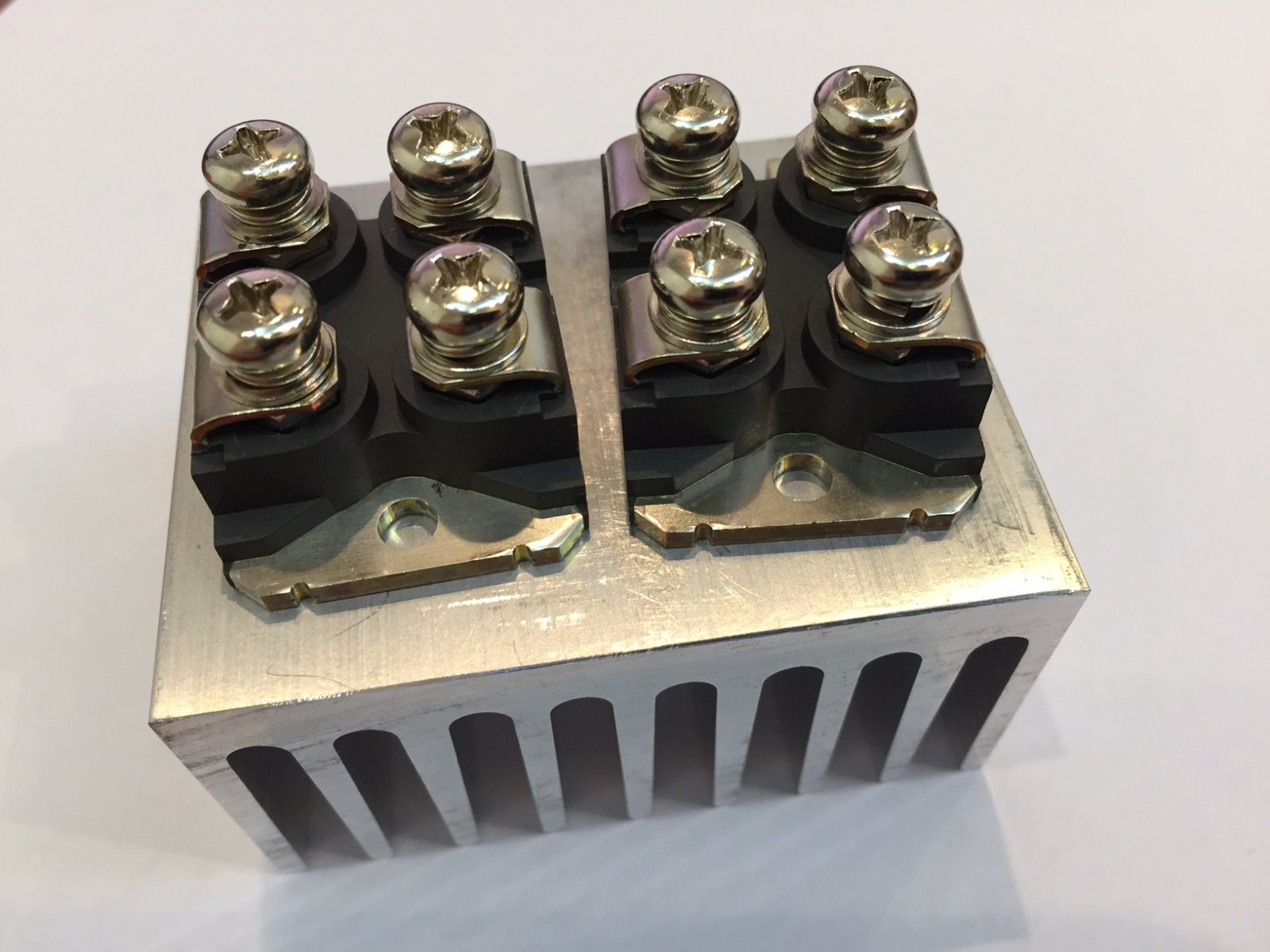

    Received the diodes today.
    Meanwell technical support says that SDR-960-24's have no built-in protection, so diodes are required to make sure reverse currents from the motors do not harm the PSU's.
    The four PSU working in parallel may provide up to 52*4=208 Amps and my motors consume up to 29A*6= 174 Amps at max load, so the diodes are quite beefy, each of the two modules handling 2x96A.
    I am not sure how much current the rig will consume in normal operation and how hot the diodes will get. Anyway, I will mount them on a heatsink and add a fan on top:

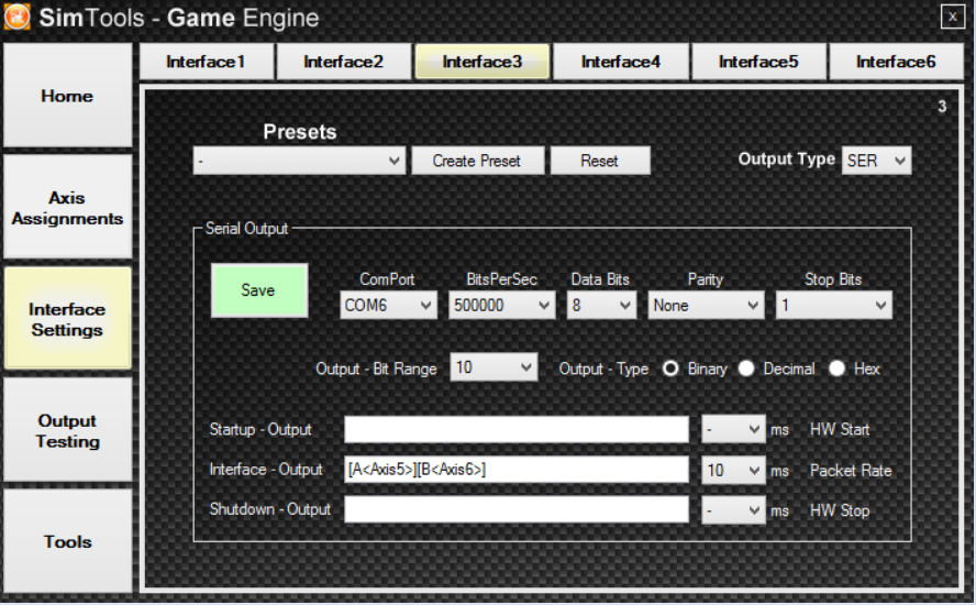

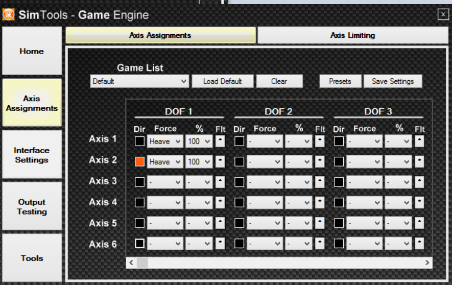

    Ok, after almost a month of travels I finally have enough time to dedicate to my build.
    I have finished manufacturing all needed mechanical parts, placed motors on the base, assembled power supply system and wired all arduinos and sabertooths. Moving cockpit is not yet mounted, I want to make sure first that the levers themselves move in a reasonable manner.

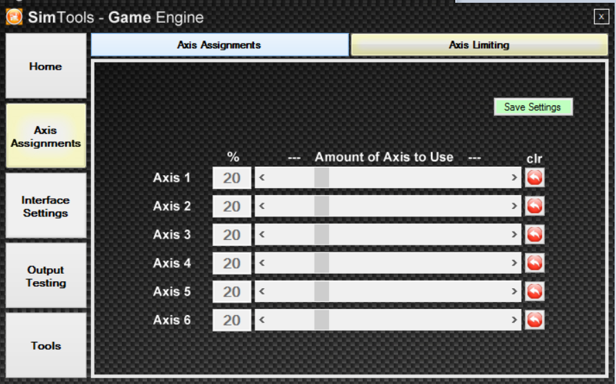

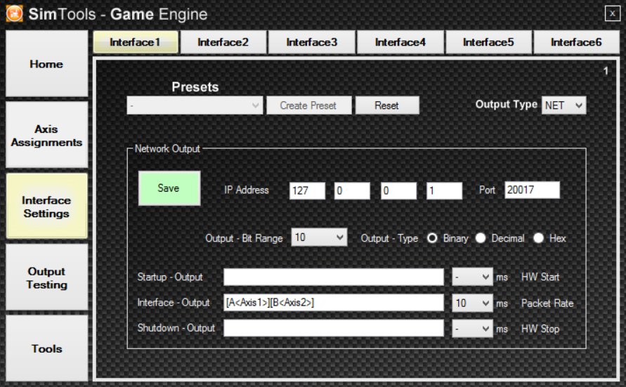

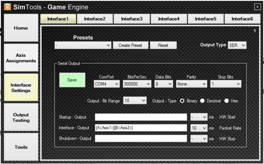

    Each individual motor seems to work just fine when commanded through SMC3 Windows Utility -> Arduino running SMC3 code modified to support Sabertooth packet serial -> Sabertooth, however I've encountered strange problems when trying to run all six motors with Simtools.
    The situation is as follows:
    1) I have three arduinos with SMC3 code, each connected to two motors through Sabertooth 2x60A
    2) Arduinos are connected to a powered USB hub and then to a laptop running Simtools. Laptop sees three COM ports.
    3) I've set up interfaces like this:
    4) Axes are set up like this:
    As I wrote earlier, each motor can be very well controlled through SMC3 Utility, however with Simtools the motors behave strangely:
    1) Jump when axis value crosses zero:
    2) Only one motor in each pair rotates when slider is moved by a small amount:
    What can be a reason for this? Did I set up something incorrectly?

    Trying to understand what's going on I used this great ability of SMC3 to interface with Simtools though UDP. Here's what I am getting:
    Simtools is sending some strange values for axis positions below zero. There is a gap between zero and +1, then nothing between zero and about -80, then some random fluctuating values between -80 and -100.
    I am wondering what have I done wrong?

    Problem solved. Somehow it was related to my laptop: everything works (almost) fine on the stationary PC.
    Almost -- because when using COM ports directly from Simtools motors get a bit out of sync, with 0.5-1s lag between motors in pair. It all works great, however, with three instances of SMC3 utility listening to to three UDP interfaces and forwarding commands to COM ports.

    It is possible to setup Simtools to send commands over network through UDP and then listen to these commands with SMC3 PC utility. Utility may then pass commands to Arduinos. It's recommended to run SMC3 on a separate PC, however I run three instances of SMC3 utility together with simtools and the game itself on a single computer without visible issues so far.
    I do not know why with direct interfacing to COM ports I get non-synchronous motor movements, but anyway I like the UDP solution as it also allows to live-tune PID while in game.

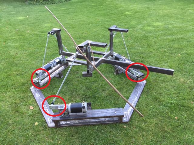

    I finally got it moving!
    I probably need to make the rods stiffer...
    • Winner Winner x 4
  19. SilentChill
    2,645
    20,604Coins
    +3,570 / 34 / -0
    I think your arms are just too long,.
    Awesome work tho great to see it moving :D another 6DOF is born

    I actually think that I may eventually need to make the arms even a bit longer -- my gas springs do not fit under the cockpit. Right now everything moves just fine with me on top, Sabertooths not getting too warm, but the test sessions were not very long.
    Thank you! There is so much still to do with tuning (I tried riding with Oculus and the current moves cause motion sickness almost immediately), but I am so satisfied to get to this point finally! :))
