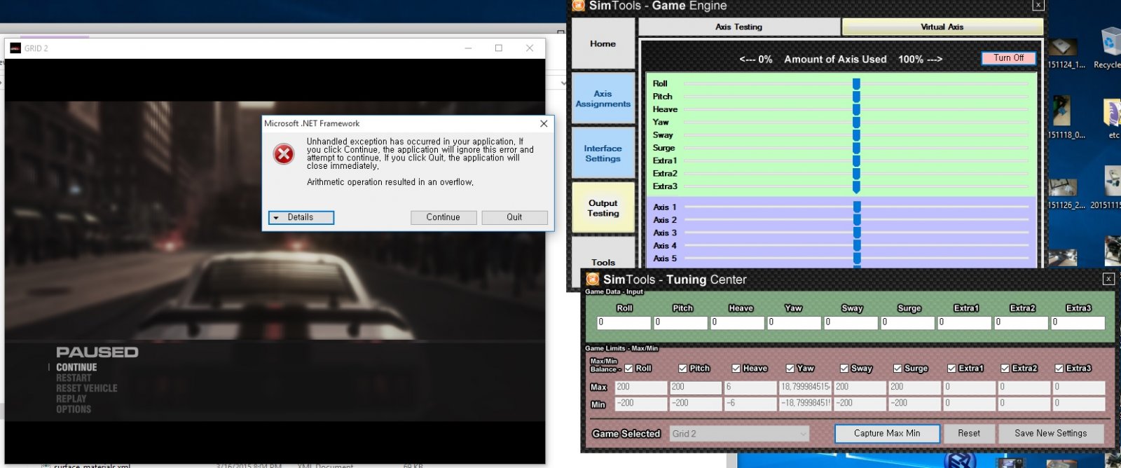

    2DOF, SCN5
    I tried the gird 2 plugin, but it stops witth error message.. if seems to getting irregular signal.. how can I solve this??
  6. bsft
    have you updated .NET framework? What equipment are you using?

    2DOF, SCN5
    I am using scn5, I am not sure what version .net framework on my com.. but it is working good with Flight simulator x.. do I need to check .NET framework version??

    2DOF, SCN5
    I tried to install .net framework 4.5, msg pops up and says, " it is already installed, your OS already include it.."(not sure exact message). anyway I am using windows 10..

    +11,034 / 56 / -2
    You will need to supply more information about what you have done.
    Did you download the Grid2 plugin, did you install it with the SimTools Plugin Update tool and did you get a message that the plugin was successfully installed?
    Have you created an Axis Assignment for Grid2 in Game Engine and then patch the game for motion using Game Manager?
    What simulator is SimTools connected to and are the interface setting properly configured for your hardware?
