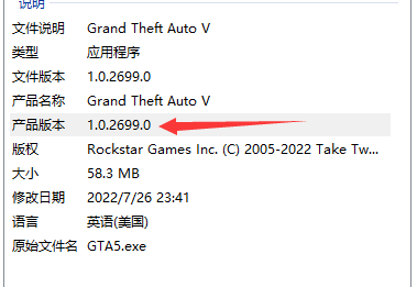

    Script Hook V + Native Trainer 1.0.2944.0
  3. zhai1987
    zhai1987 Member
    Sep 7, 2021
    96
    320Coins
    +11 / 0 / -0
    2DOF, 3DOF, AC motor
    Is this suitable?
  4. zhai1987
    zhai1987 Member
    Sep 7, 2021
    96
    320Coins
    +11 / 0 / -0
    Version

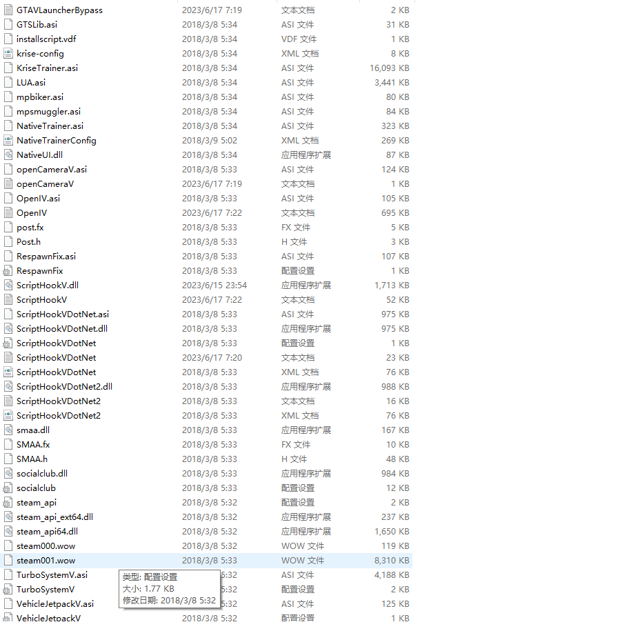

    There is still no feedback. I don't know why. But I didn't see the file for scripthookdotnet.log!

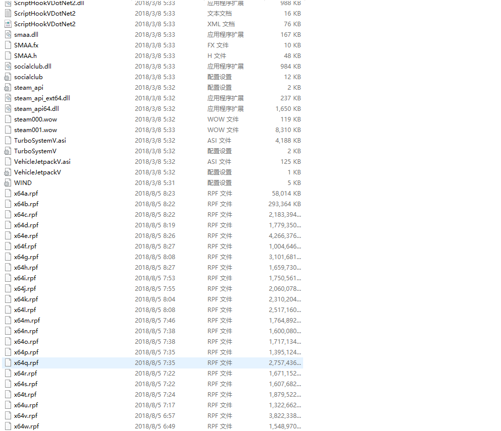

    that likely means scripthookdotnet is not working correct, as it creates and writes to it each time it is run. you need to focus on that before my mod will work. as it depends of a working scripthookdotnet plugin,
    do you have the .asi file in the gtav directory that came with scripthookdotnet?
    check to make sure also that the normal scripthook is working first, use the use the trainer, if you can get the trainer working then scripthook is working, scripthook also has a log file, scripthook.log,.. does that file get created,.. if not,.. then scripthook is not working either,
    maybe list all the files you have in the gtav dir

    not sure why you have 2 versions of the scripthookdotnet vs scripthookdotnet2,... this may be part of the issue??? not sure..
    I would have to install gtav again and see if I can get it working,.. I may do that this weekend unless someone else can chime in and help

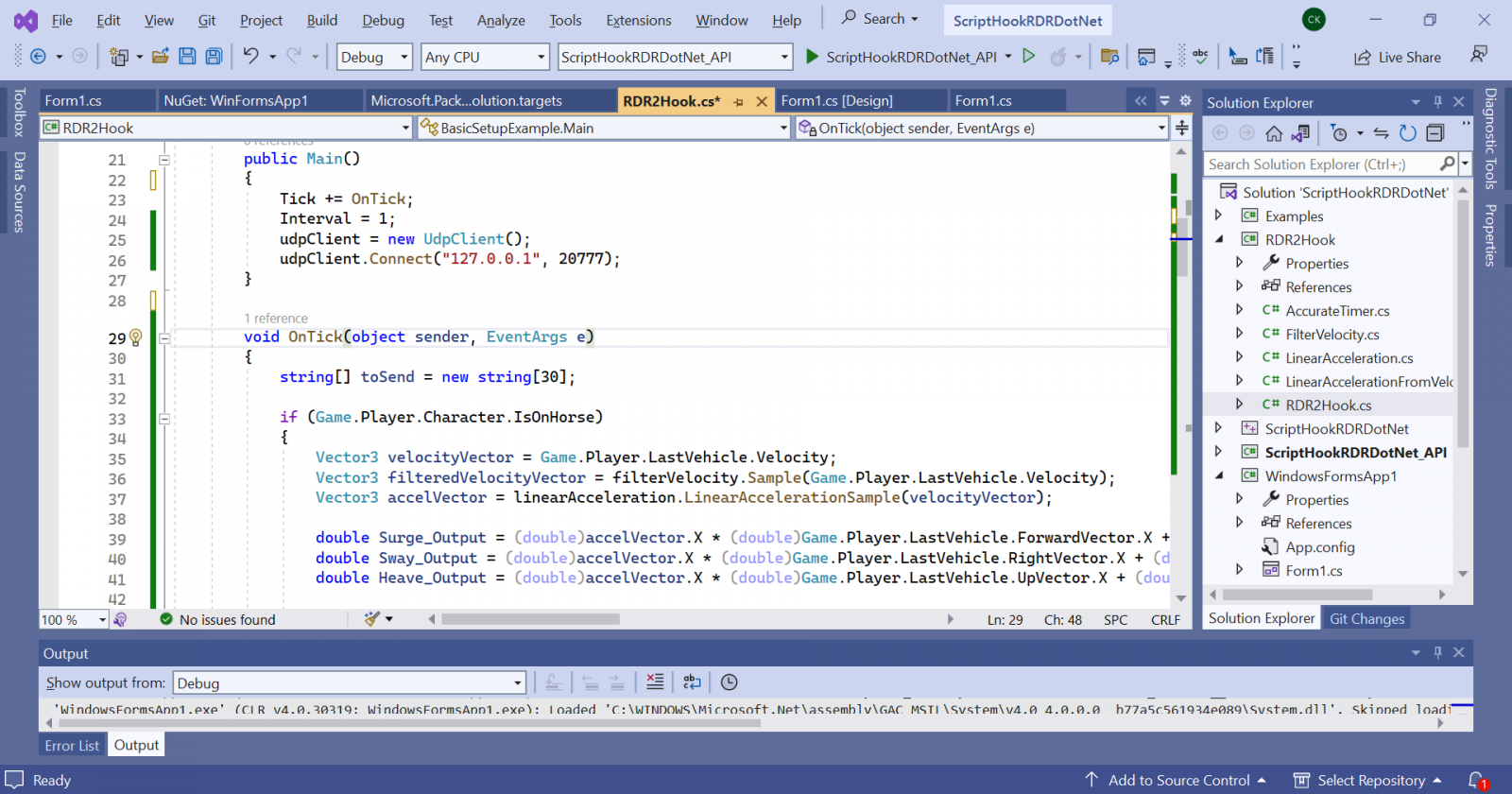

    the last image is the source code to the gtavhook script, you need to compile this in order to use it. there was a compiled version released in the github project though so you should not need to compile it again, unless you want to change the behavior....

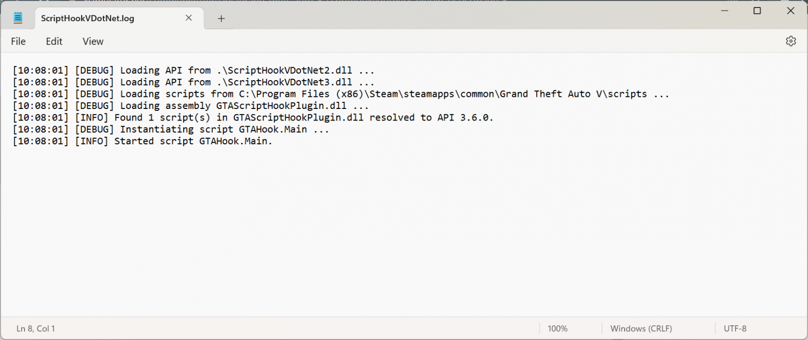

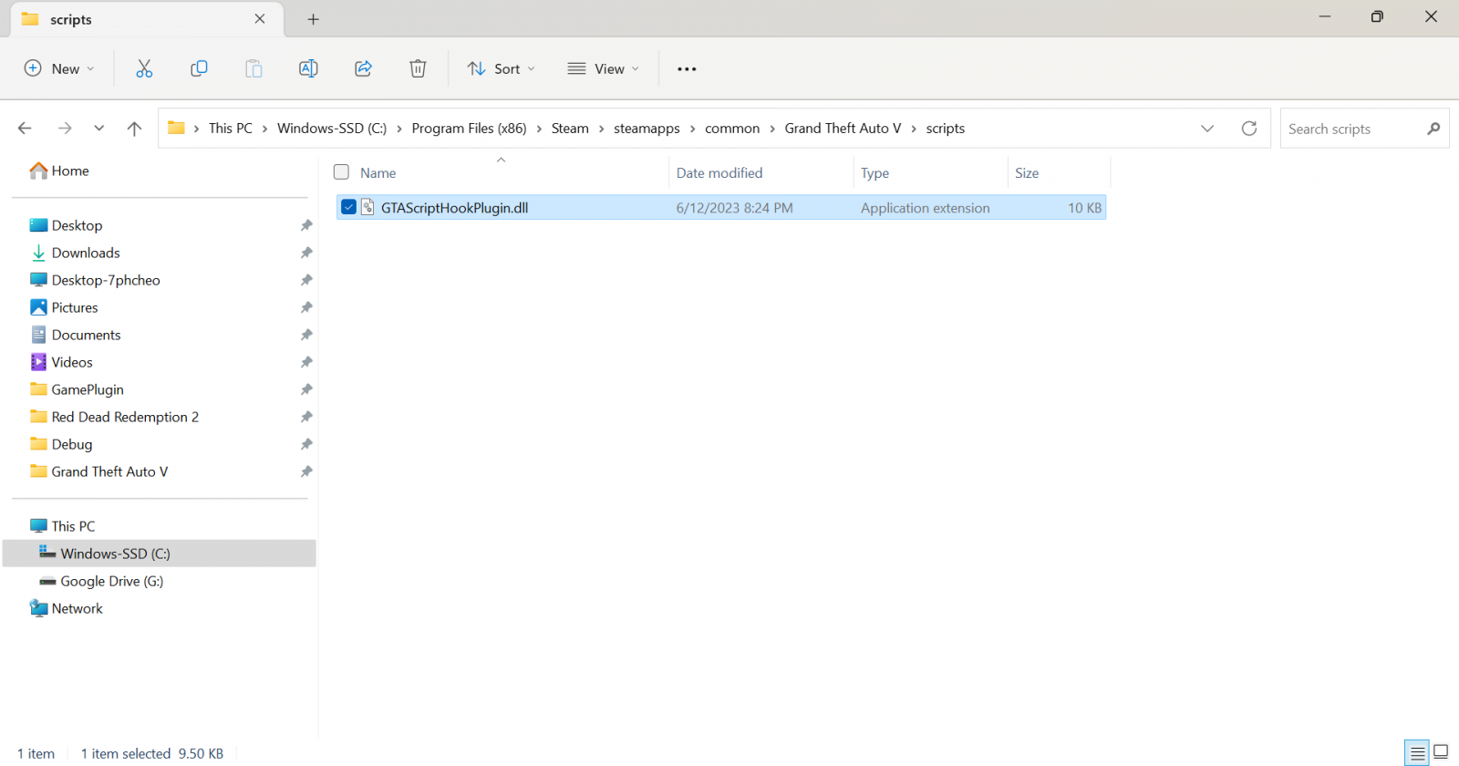

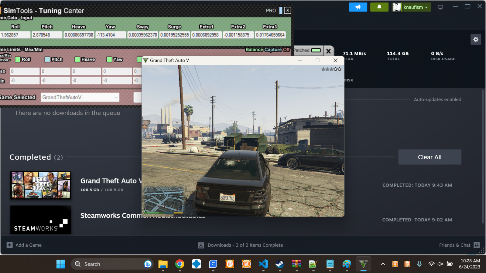

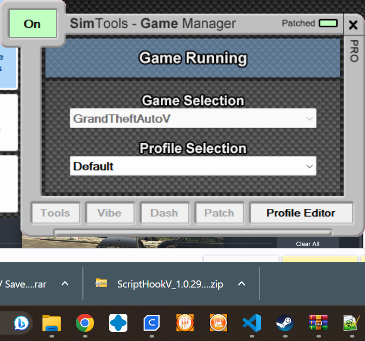

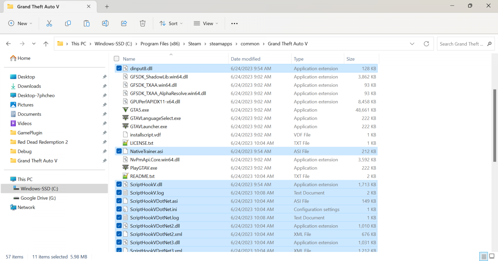

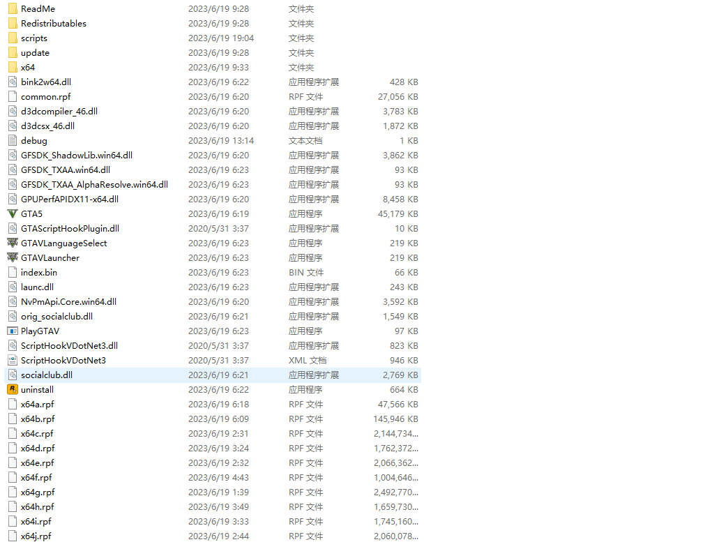

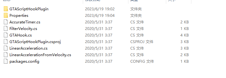

    I installed gtav, installed scripthookV, installed scripthookVdotnet, created scripts folder in GTAV directory and added my script, copied over the gameplugin to simtools, and ran the game, still works
    Files added, notice there is a scripthookv.log, and a scripthookvdotnet.log file
    my script included in github repo
    scripthookvdotnet.log indicating it is loading my script, that is placed in the scripts folder

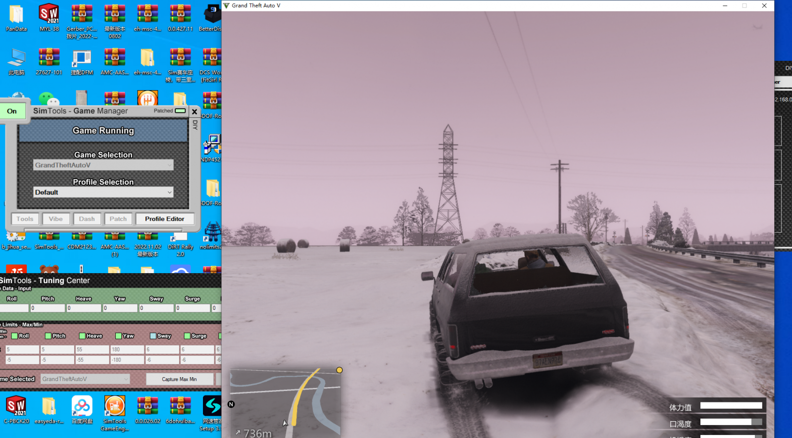

    make sure you patch GTAV from this game manager window, and that it sees the game is running
    tuning center indicating correct values
