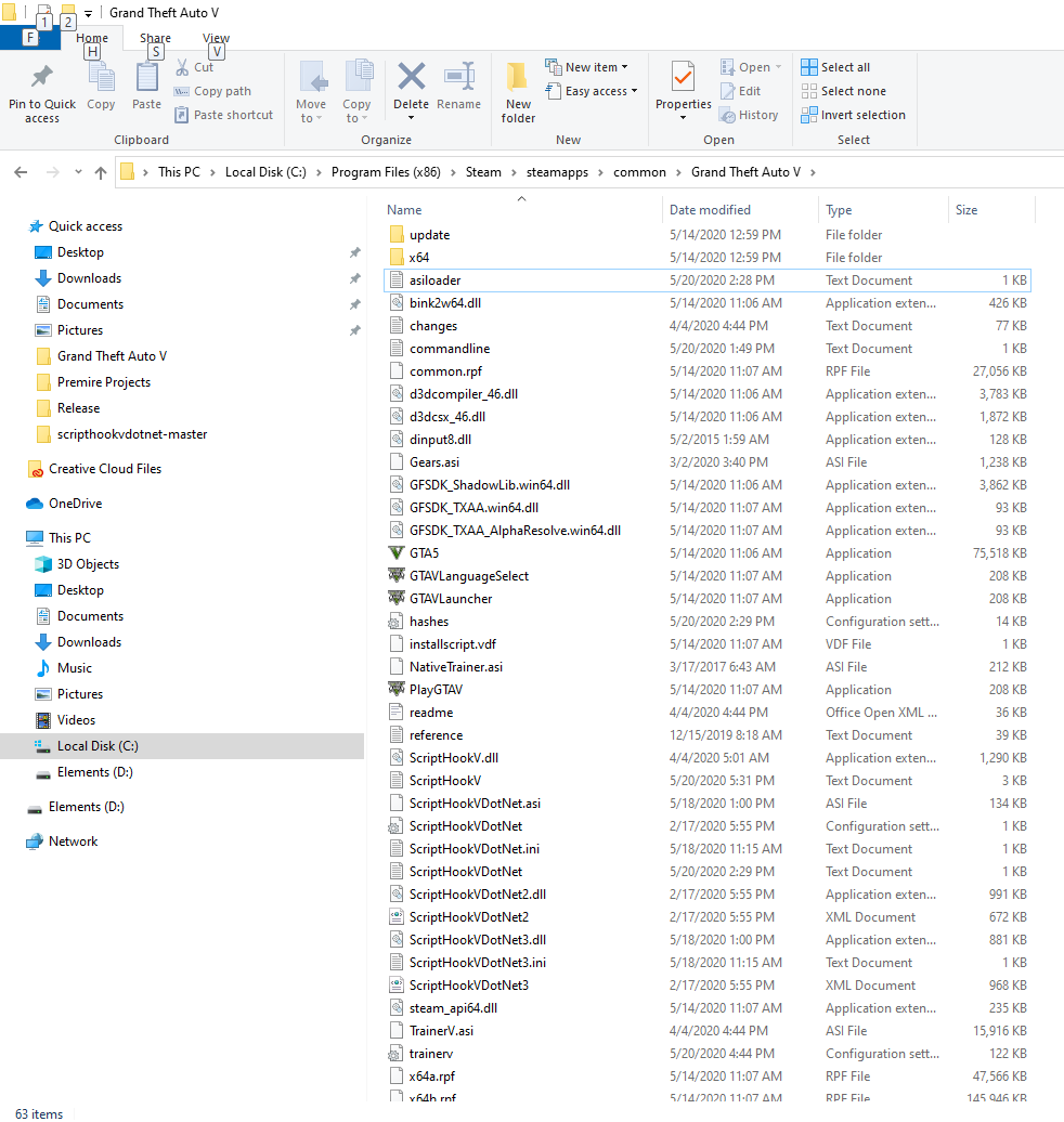

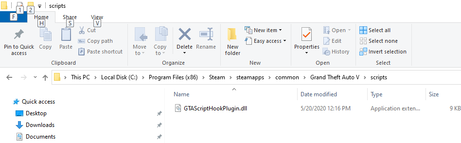

    I got no luck with the game working with the Epic version...but I,m not 100 % sure I got the all the right files in the Game folder .Gta 5/ New (Scripts) folder that I needed to create.. could someone Please help me out and take a screen shot of what files,need to be in this folder for me..

    22,185
    154,750Coins
    +11,196 / 57 / -2
