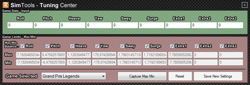

    For me it`s working fine! I use 2dof with scn5`s. Only thing I had to do is tune the limits with tuning centre.
    These are the settings.
    Thanks again Value1! Now I can get rid of the frex control box!

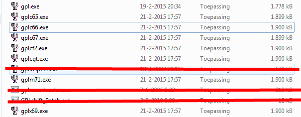

    Hey Value1, One request if possible...
    GPL mods use different .exe files.
    these are the filenames.
    You can start the mods now, but you have to rename the exe files.
    Thanks!
  10. value1
    Jan 9, 2011
    2,184
    Zug, Switzerland
    14,935Coins
    +3,327 / 11 / -1
    Thank you @bob williams for your feedback and the screenshot. I can include these file names to make the plugin start automatically whatever .exe you start. I will check what the issue with @BlazinH's program could be and issue an update.
