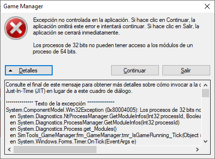

    Hello @value1
    It is really cool and thanks for your works on gp bikes plugin.
    I try this version for beta14,but it is not work(btw the mxbikes is ok).
    When i open the game the computer shows me "A 32 bit processes cannot access modules of a 64 bit process",and the game cannot connecting to the game manager.After that the game manager crashed.
    I have try unpatching, restarting Game Manager as Admin and then repatching,but it is still not work.
    Would you please tell how to fix it?I really hope to play gpbikes on simtools.

    Same problem:
  14. value1
    Jan 9, 2011
    2,192
    Zug, Switzerland
    14,294Coins
    +3,363 / 13 / -1
    GP Bikes has been updated to 64 bit exe. Therefore SimTools cannot easily access the data from GP Bikes.
    I will have to see, how to fix this.

    I bought a GP Bikes beta15 and I have the same problems with x64 system. Plugin for GP Bikes b15 x64 needs to be updating. I got from PiBoSo x86 version of GP beta12 that works correctly on Win10 x64 (Dell Precission M6700, K3000M). PiBoSo wrote "Nonetheless, please ask the Simtools developer to update the plugin to support the Beta15b version of GP Bikes. Porting the code to the latest interface should be straightforward:
    https://forum.piboso.com/index.php?topic=33.0
    https://forum.piboso.com/index.php?topic=34.0
    https://forum.piboso.com/index.php?topic=6063.0"
    Thank you for the work and time spent on the GP b15 plugin!

    I have same problem as Javo5, with GPbikes version 15b,
    Looks like .NET error relating to 32bit.
    I will post error screen shortly.
    GP bikes works fine, if I "Exit" unload Game manager and Sim Engine.
