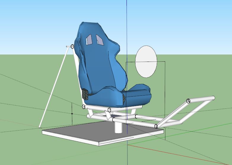

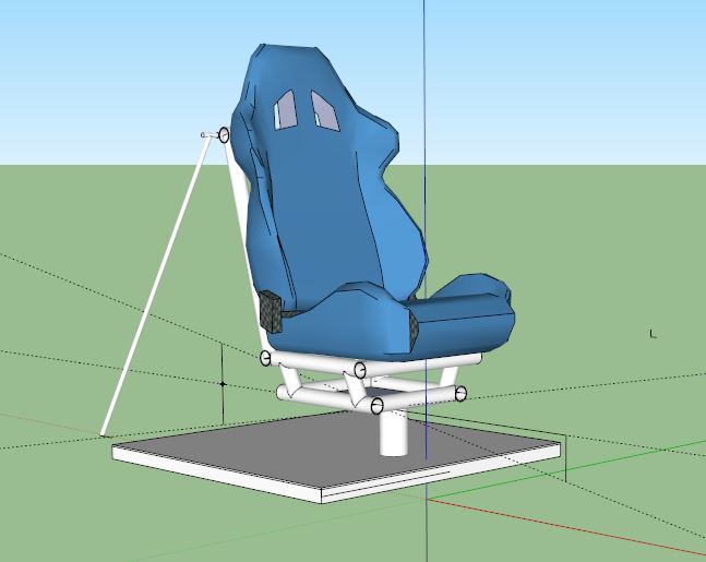

    Slowly getting there.
    So the design is kinda like a seat shaker. The lower tubes act as telescopic housings for a smaller tube making up the pedal sets. The steering wheel itself will be mounted onto the larger tube and this too can slide along the smaller tube. This pretty much lets me adjust the pedal and steering wheel position to suit my family. I'll drill holes through the pipe at regular intervals and will hold them in place using unsecured bolts to make for easy adjustments on the fly.
    With the current measurements for 44.45mm and 38.1mm tubes (2.6mm thickness - basically, roll cage tubing), I should have about 1mm of play between the pipes. Hope it doesn't rattle too much. The drive rods will be 25.4mm x 1.6mm chromoly tubing.
    The tubes facing sideways will be the ones that I can mount a HOTAS setup to if I ever get one.
    Can't wait to order the tubes. Will wait til I have the design dialed in with sketchup and sketchyphysics though.
    I've also been thinking of the tools I'll need to fabricate these. I think I'll settle for a press drill and a 3-in-1 TIG/MIG/Cut welder. The design doesn't have any angled notches, so I won't need to invest into an angled pipe holder/notcher. And the plasma cutter can double for a steel saw. I've already got a grinder for cleaning up the edges and preparing surfaces. Might buy rather than rent. I suspect I'll need to do repairs on crappy welds... Plus... I might get the urge to make another one or refine the design. The price doesn't seem too bad. About another $700. Which means I'm over my original $1500. At this rate, $2000 is looking more likely.
