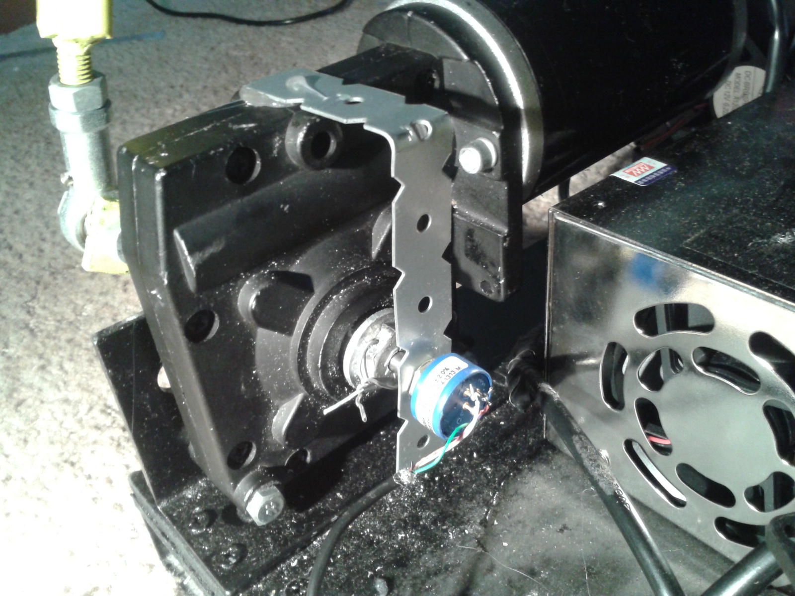

    Popular choice for mounting pots is the shaft directly into the back of the centre of the motor shaft lever bolt.
    Drill a hole to suit the shaft of the pot size , then once the shaft is in, drill a 2-2.5mm hole through it all and run a length of wire to hold it on.
    To hold the pot to the motor housing, use a flexible bracket and glue it to the top is the quickest way. Others make up brackets to hold it and I hope they will comment as well.
    The advantage of using good quality wire wound 360 deg single turns is that they can spin freely around and around and never break.
    You will be using about 170 deg of a motor turn anyway, so the entire pot is not being used.
