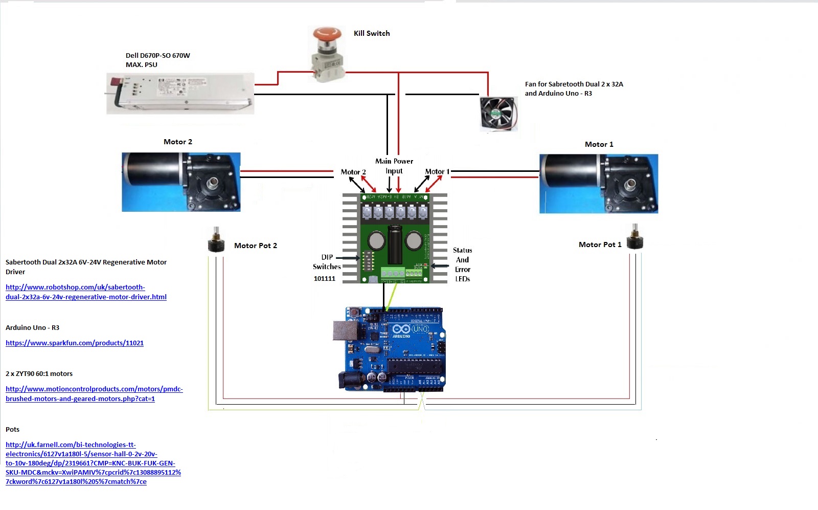

    This is what I have purchased so far, once everything arrives I will start learning how to put it all together, I have no problems with the mechanical engineering , its the wiring and programming I will struggle with.
    Sabertooth Dual 2x32A 6V-24V Regenerative Motor Driver
    http://www.robotshop.com/uk/sabertooth-dual-2x32a-6v-24v-regenerative-motor-driver.html

    Does this look right

    I think my dip switch settings are wrong on my Sabretooth, nowhere near assembly yet so plenty of time to research correct settings.

    some PSU need to short some pins to power up. you can use a simple kill switch doing it instead of shortening the pins and the load wont go through the switch if you wire it like that. don't know what modifications your PSU need to work for our needs

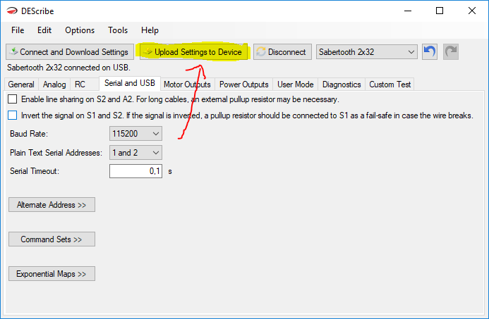

    I am really sorry to ask such a silly question, I have been trying for 2 days to set the baud rate on my Sabretooth 2x32 using describe software to 115200 I do it, it looks all ok, I then disconnect reconnect then detect and it always comes back as 9600, set port in device manager, I am great with the welder and spanners but really fall down with programming, is there anyone out there who would be prepared to hand hold me through the inital stage

    Once you set the baud rate, do you upload settings to the device?

    hi yep done that a thousand times, I have just this min moved my motors with SMC3 dont know how but they moved
