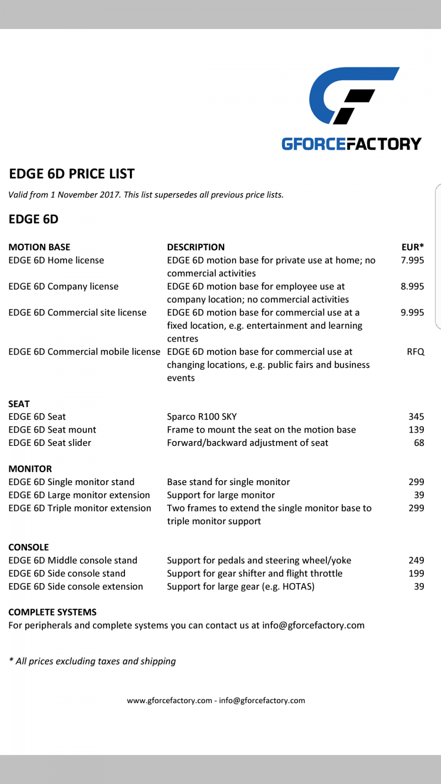

    Price:
    D-BOX = 10,000 EUR
    EDGE = 8,000 EUR

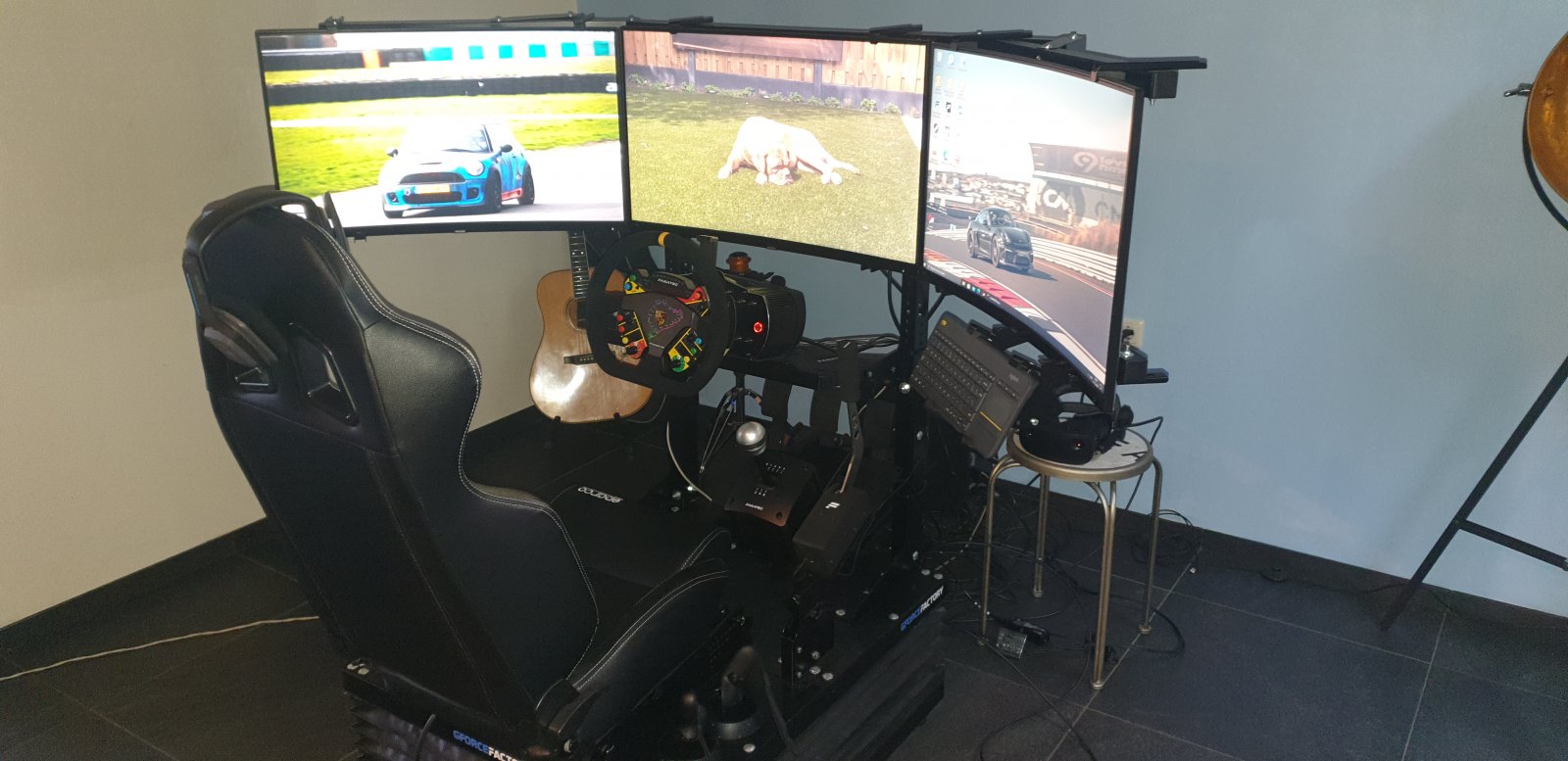

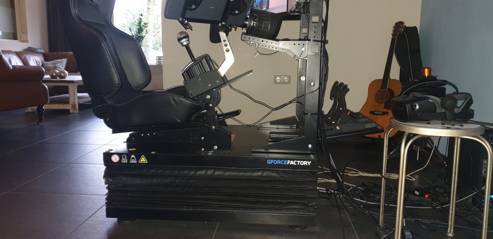

    Hello everyone!
    I own an Edge6d 6 dof!
    I am from the netherlands where this company is also. I am very happy with the edge 6d and it does everything i hoped for. I am not that technical and building a diy system i can not, or i would not try. What i can say is that the base platform looks very good and cost around 8000 euro but you have to buy other stuf like the monitor stand , monitors etc etc... it cost me in total around 17k euro but then you got it all!!
    About the motion , i can not talk about figures because i do not really understand what the difference is between other systems but it works very good for me. A lot of games you can play directly, so plug and play but there are a few games you need simtools for it , but with the developement of the system you need simtools less and less.( i did bot use simtools for a year now) I got my system for around almost 2 years now and in the beginning i needed simtools for iracing but not anymore. Assetto corsa, f1, project cars, dirt, iracing and some flight games like x-plane, il2 sturmovik and some others, but i only race myself. all work without simtools, the customer support is very good and they answer mostly the same day when you email them. The guy from the gforce-edge6d company who owns the company installed the whole rig at my place, but with every rig i think you have to learn the system just to work with it. Benefit from living in the netherlands is that he installed the rig at my place , but i think they would not do that in a foreign country. The send it and you have to install it yourself, but if i saw him doing mine, i can tell it is not that difficult. The platform is allready completely installed and you only have to install the monitor stand, chair , wheel etc. There warrenty is also good but i had never a problem with the system. Yes it costs still a lot of money but i am very happy that i bought it, for me the benefit of a company who is from my own country and solves problems if i had any instantly , and if needed to come to my home and solve it , was and is the best for me. (mostly with simtools or let it work with VR , but i never had a problem and everything went true email)
    Price : to compare with other company systems very good.
    Motion : very good
    Customer care : very good
    I can afford it otherwise i would build my own diy system it is much cheaper, but if you don't want the headache and have two left hands like me, i would say go for it. ✌
    If you have a specific question , maybe i can answer it, and if you are from belgium, germany luxembourg or netherlands and you are curious about the edge 6d i invite you here at my place so you can try it before buying it!
    Cheers!!

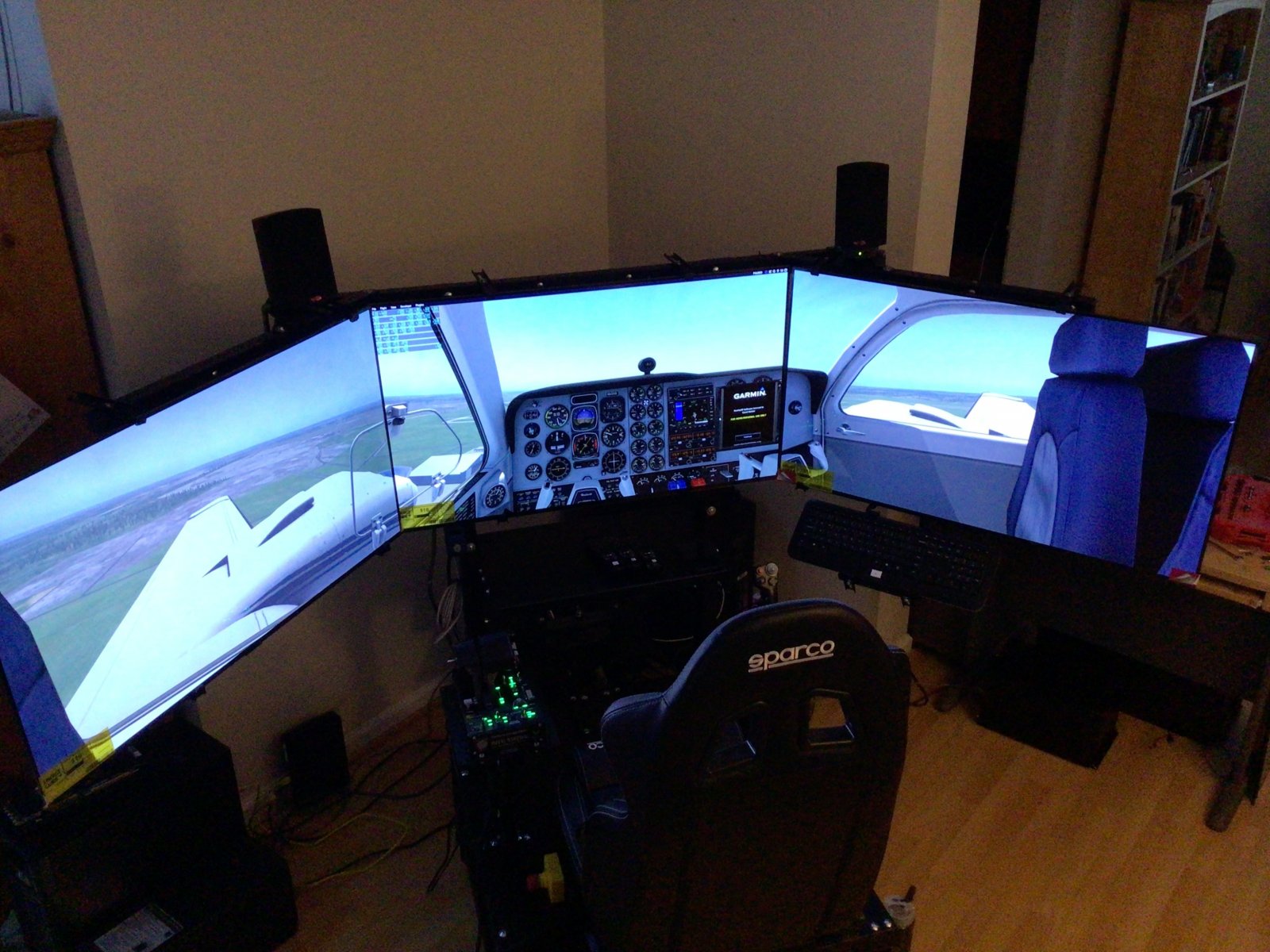

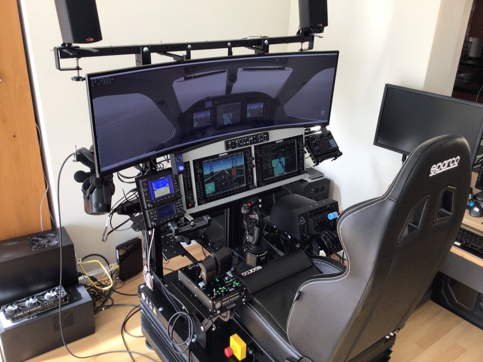

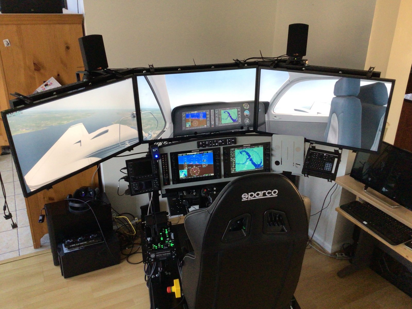

    I had my Edge6D arrive a few weeks ago in North Carolina. Did a test flight this August in the Netherlands. Took only a few days to get it from the Netherlands. Transportation cost have gone up so budget for that. Great platform for flightsim use. I’m running X-Plane 11 at 25% with a three monitor setup. For Il2 and DCS I’m using VR and I’ve dialed it back to 20%. The thing is very powerfull. Shooting an ILS to minimums with turbulence dialed in gives a nice workout. Been experimenting with different monitor setups. First used three LGC2 42inch tv’s but couldn’t keep them from sagging. Switched them out for a single Samsung 49 inch widescreen monitor. Nice and compact but I missed the peripheral cues when flying X-Plane 11. Found the Samsung u32j59 on sale this Black Friday. Very light so no issues with the monitor stand sagging. Not as good a quality as the Oleds of course but good enough and a footprint I can live with.

    Well, that looks really good!
    Is there any reason why the angle between the middle and side monitors is that wide?
    I guess it's not far from 150° while I'd have expected something closer to 90°

    It gives a wider field of view for games other than X-Plane that have no adjustable offset per monitor. If I had used the bigger, 43 screens, I would have increased the angle to safe space. As is, with the 32 inch, this angle covers my peripheral vision. When I look 45 degrees to either side I’m still covered with monitors. They do indicate a view of 90 degrees in X-Plane. Still contemplating if I should use the actual offset angle of the monitors or stick with the 90 degree offset I have dialed in now. It feels realistic as is when sitting in the seat but looks off when standing behind the sim.
    Another practical aspect of not going with a 90 degree angle is ingress, egress into the seat and closeness to the monitors. It gets pretty warm if those monitors are very close to your face.

    I understand, that makes a lot of sense.
    I'm sure that when sitting in the simulator it looks much more natural than when you are looking from another point of view.
