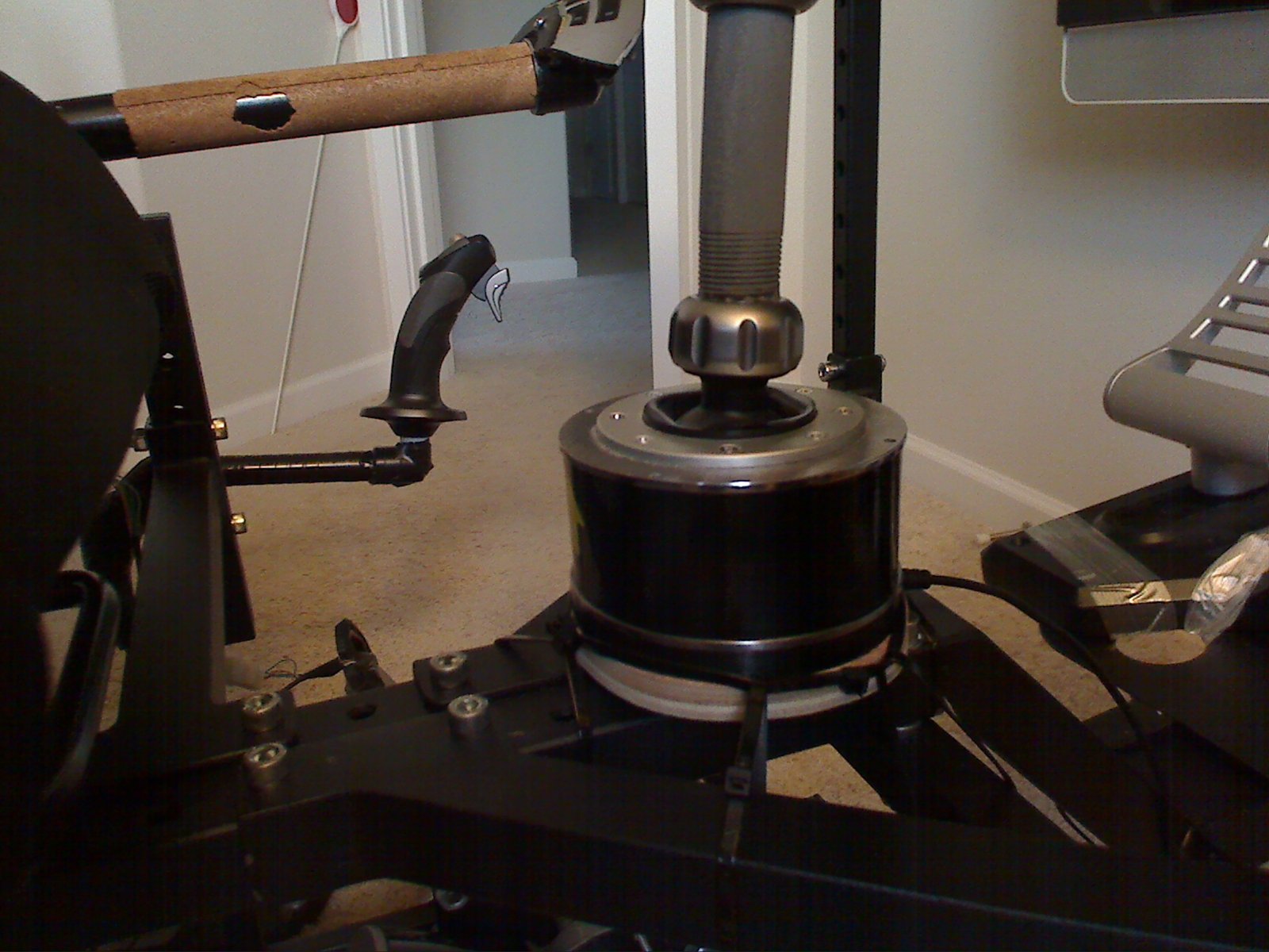

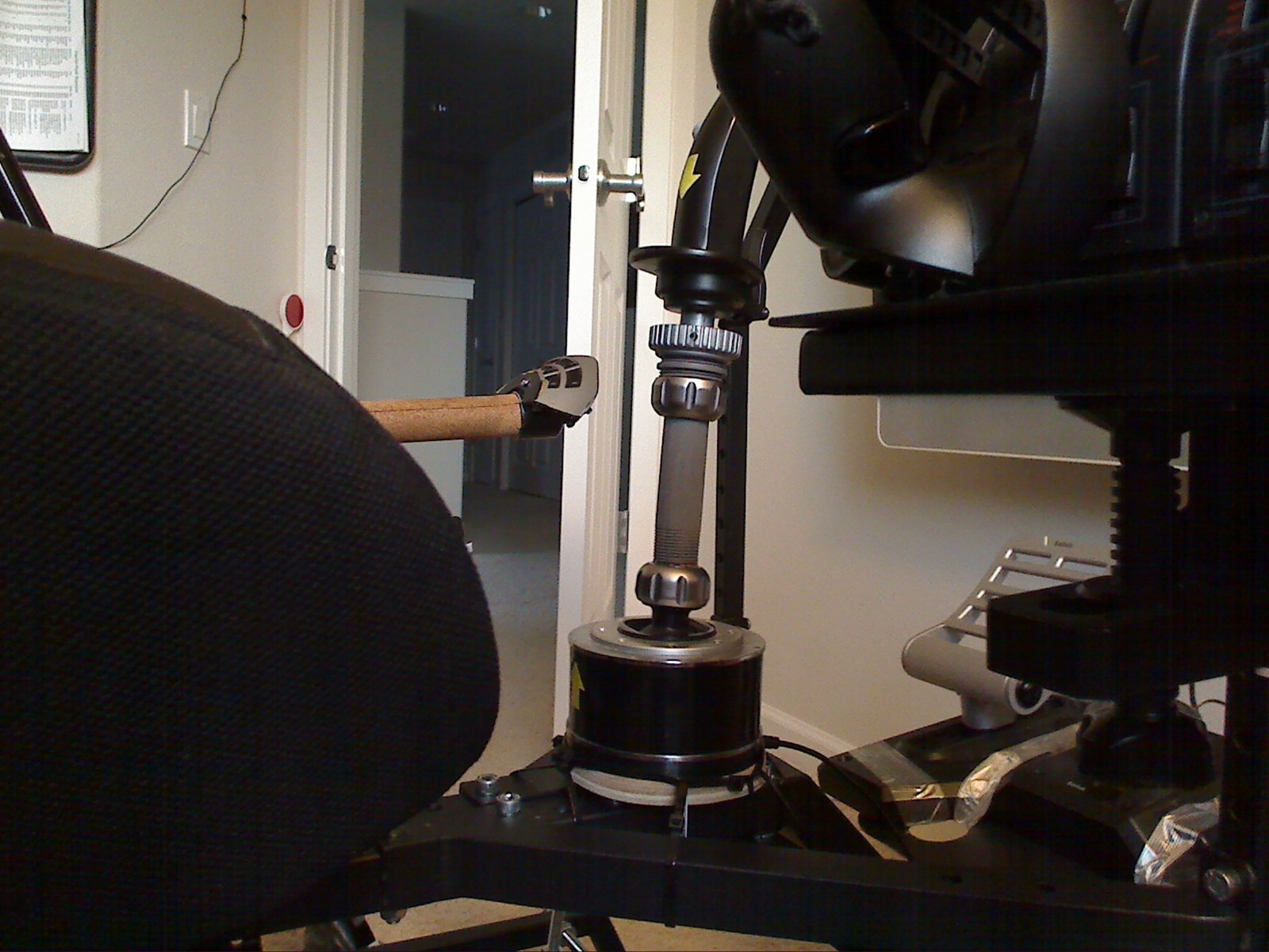

    Here are two pictures of how I have mounted my flight stick to the platform.
    I placed a zip-tie around the base of the flight stick then used multiple zip-ties ran through the loop on the base and around the platform center beam. It is very stable. The height of the grip when I am seated is just fine.
    Danny
