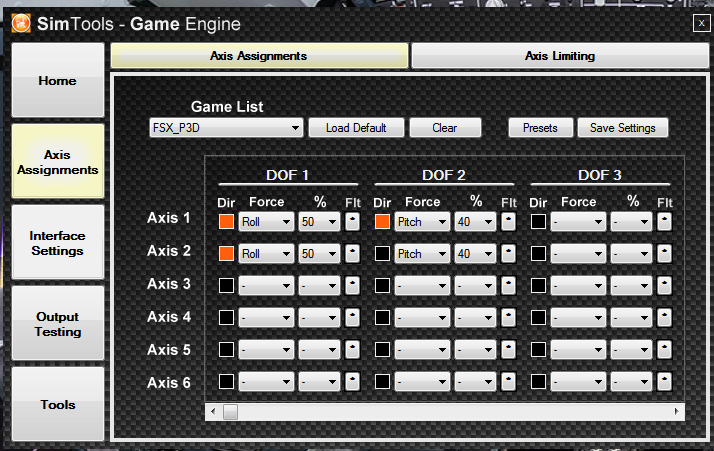

    Hmm... Not sure to be honest mate... Is it possible your Sim is reaching it's maximum lean and it's not actually able to "pull back" to centre? To test this I would set the "Axis Limiting" to about 50% and see if it happens then. If the issues goes away you might have to pull back the Axis maximum a bit. The only game I have to do this in though is DIRT Rally as having Axis Limit of 100% kills my motors. I need to set it to 93% to avoid "overshoots".
    Axis Limiting is in the Game Engine and is a setting for ALL games, (not per game) so keep this in mind when changing.
    I have Zero experience with SCN5's so this might not apply to you, but to find the Physical limits of my Sim, I turn on the Output test and change the output to "per Axis" (not DOF). Then I slide the slider all the way towards 100% until my Motor arm tops out. This gives me the maximum that my levers can go under any profile. For example, 93% on mine is "top dead centre"
    I then set 93% (or less) in the Axis limiting to avoid over throwing the arms etc... I am still learning this stuff and all sims are different, so your milage may vary. :)

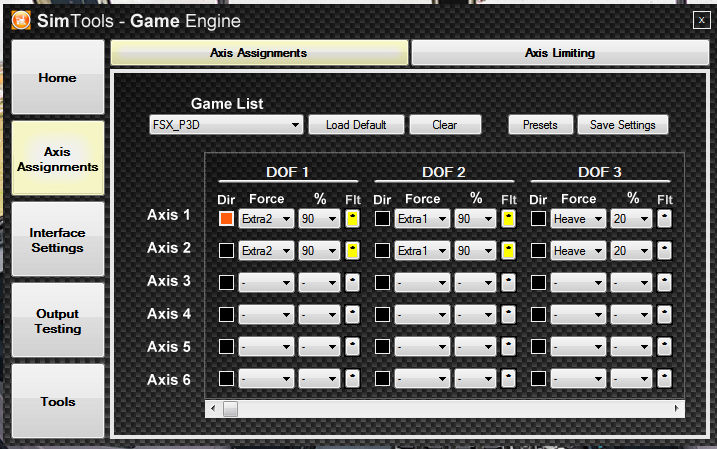

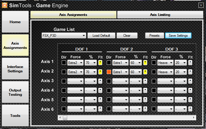

    Bonjour Archie
    Vous voulez dire que vous n'utilisez ni Roll ni pitch, mais à la place vous utilisez extra1 et extra2 et les smooths ?
    Je suis interressé par cette configuration car j'ai quelques problème avec ce que j'utilise
    Hello Archie
    You mean you are not using roll or pitch, but instead you use extra1 and extra2 and smooths?
    I am interested in this setup because I have some problem with what I use
    Screen shot of my setting
    Pouvez vous faire une copie d'écran de votre configuration
    Can you make a screenshot of your settings
    Merci d'avance
    thank you in advance

    Do try Extra 1 and 2 in place of roll and pitch, as per @Archie's outline, it is far superior to roll and pitch.

    Bonjour @Farfred !
    As @noorbeast says, please use Extra1 and 2 for the Roll and Pitch. @value1 modified the plugin to work better on those axis, and of course because Roll and Pitch is "game tied" the next ones he could use were Extra1 and 2, so please don't be put off by the names. :)
    Let me know how you get on mon`ami!

    Je ne suis pas effrayé par les noms, je trouve seulement cela curieux d'utiliser extra 1 et extra 2 à la place de Roll et Pitch,mais vous avez certainement plus d'expérience que moi .
    Je vous joint le setting que j'ai fait , dite moi si c'est ok , si je peux essayer comme cela.
    I'm not scared by the names, I only found it odd to use extra extra 1 and 2 instead of Roll and Pitch, but you definitely have more experience than me.
    I joined you the setting I actually, called me if it's ok ,if I can try as
    Quand vous parlez de modifier dans le plugin( la je suis vraiment effrayé ....)
    c'est bien le plugin ''FSX_P3D_plugin dont vous parlez
    Là je n'y connait rien, je suppose qu'il faut éditer avec Bloc-notes, jusque la ça va mais aprés pour moi c'est du chinois
    :sos
    When you talk about change in the plugin (there I am really scared ....)
    this is the plugin '' FSX_P3D_plugin you speak
    There I not know anything, I guess you have edited with Notepad, until after , for me it's Chinese
    Ici le setting que je vais essayer
    Here I'll try setting
    Merci mon ami :thumbs
    21,723
    152,051Coins
    +11,063 / 56 / -2
    Don't worry, you do not need to change the plugin, its author @value1 has already made the changes so you can use Extra 1 and 2.
    To try and give you a bit of an idea what happens when you use Extra 2 instead of roll, and add smoothing to it, is that if you roll right the sim will move to the right, but instead of staying there the smoothing will slowly move it back to level and I found it does so in a more controllable manner than using washout. So if you roll more right it then has the additional axis available to give the sensation of rolling even further to the right. I hope that makes sense.
    What it means is that you can do an 8 point roll and between each of the 8 points the sim is actually giving the sensation of moving to the right each time, as the pause between each is enough for the smoothing to kick in. If you do a fast roll to the right the sim remains to the right and the smoothing will washout to level once the stick is released, so it feels far more realistic, particularly with the Oculus Rift as you also see the visual in game cues matching the motion sensation.
    100% smoothing should be the slowest (least noticeable) rate of return, but find what suits you.
    Hopefully you now have an idea of what you can get out of Extra 1 and 2, which I think is far more realistic than Pitch and Roll as it avoid the nasty effect where at the point of inversion the simulator snaps from one axis extreme to the other.

    Ok maintenant je comprend l'interet d'utiliser extra1 et 2 à la place de Roll et pitch.
    J'ai chargé les nouveaux setting et je suis occupé a faire des essais en vol, c'est un peu long car chaque fois que je veux retoucher axis assignement, je suis obligé d'arrêter FSX et de le relancer ( ce qui prend un peu de temps à chaque fois)
    Je cherche aussi le meilleur compromis dans tuning center , la c'est plus facile car on peut agire pendant que le FSX tourne.
    Dés que j'aurais trouvé les meilleurs réglage, je publirer mes différents setting.

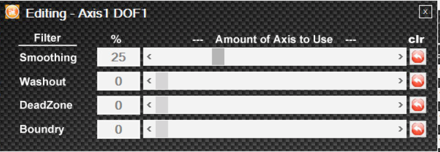

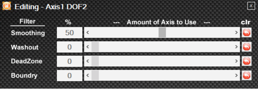

    These are the settings I use for P3D for reference.
    pic2.png Axis 2 DOF1 is also 25%
    pic3.png Axis 2 DOF 2 is also 50%
    Normally, the rule is that your % forces should be around 100%.
    In a flight sim I want to feel the roll and pitch more so I almost max them out.
    My argument here is that if you are hitting 80-90% in Pitch and Roll in an Aircraft AT THE SAME TIME, you're about to slam into the ground or break apart your Plane! :D

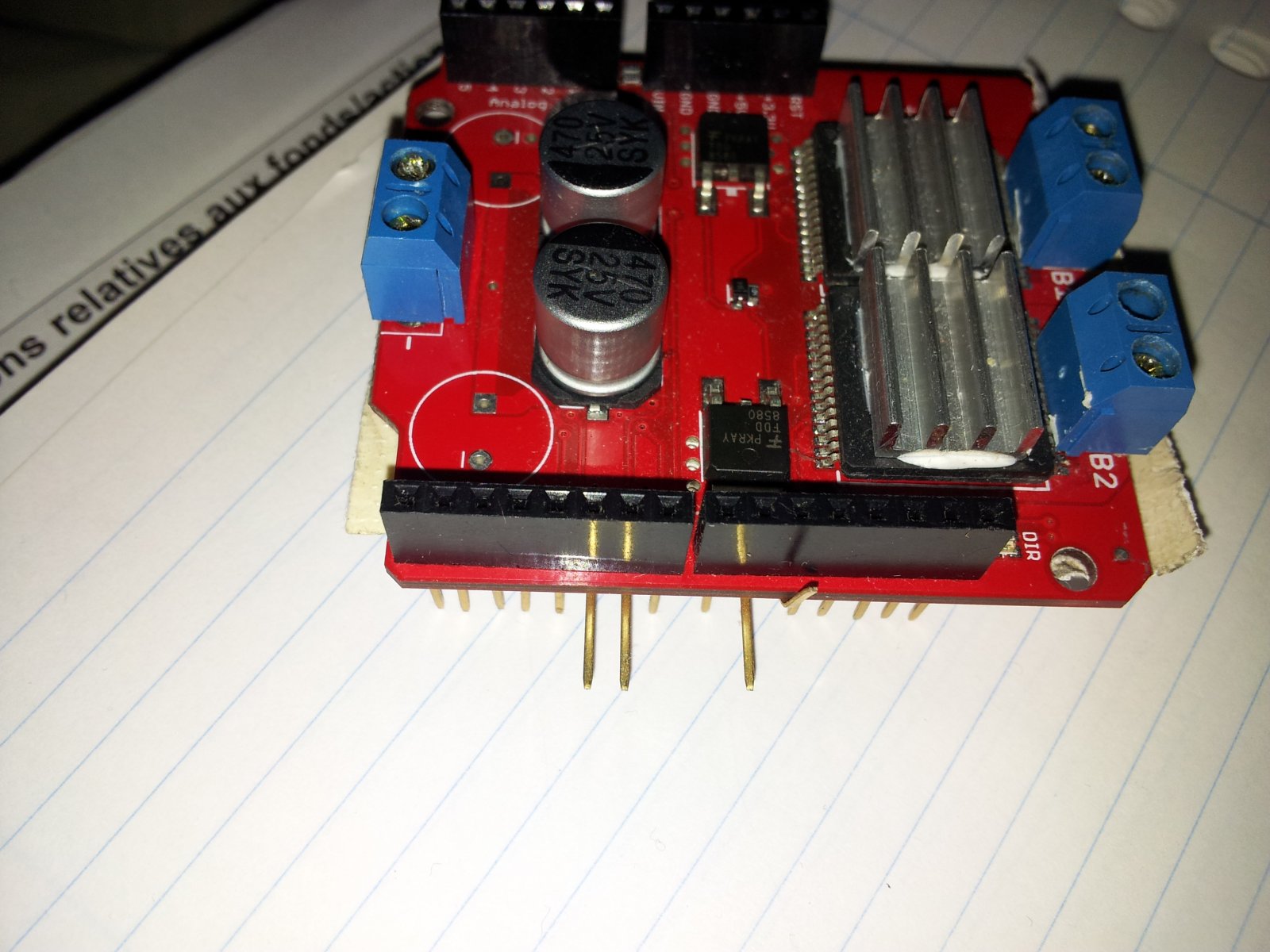

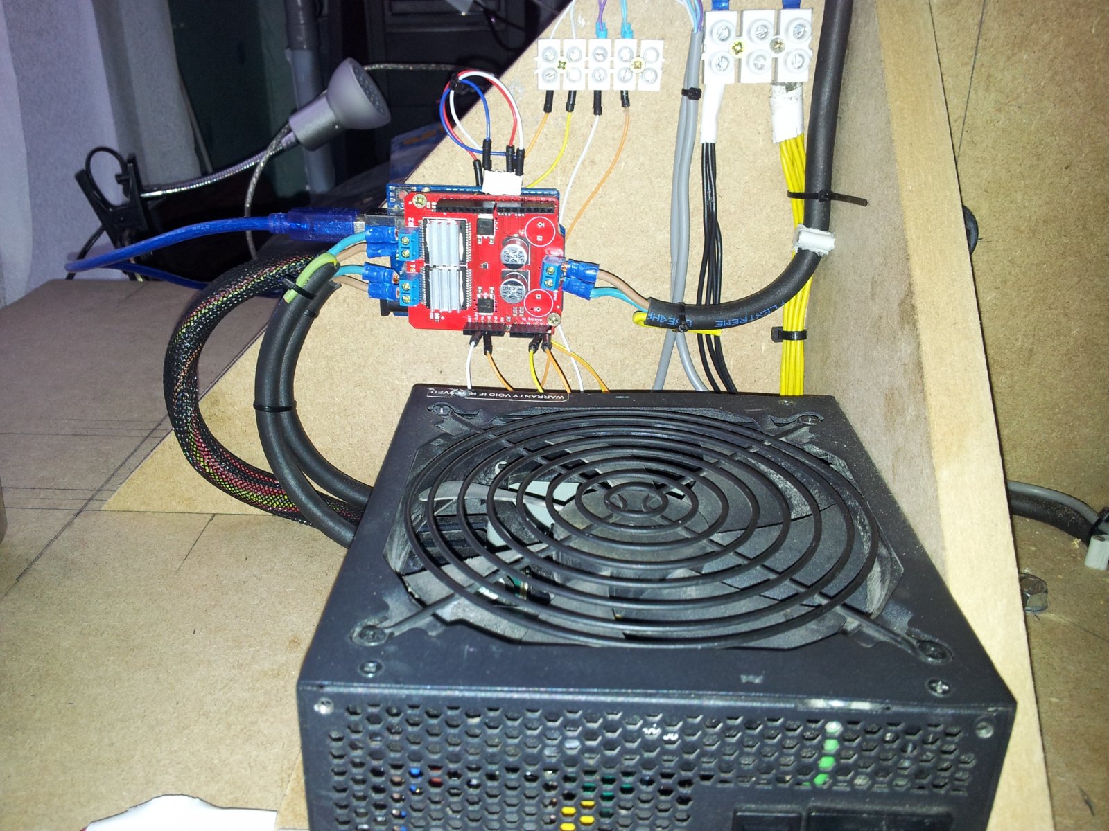

    Aujourd'hui, j'ai modifié mon câblage entre la monster et l'arduino, pour pouvoir utiliser le code qui supprime le sifflement ultrasonique
    C'est vraiment super , plus de bruit de sifflement ,c'est très silencieux. Ouf ça fait du bien aux oreilles
    Today I have modified my wiring between the monster and the Arduino, to use the code that deletes the ultrasonic whistle
    It's really great, more hissing sound is very quiet. Phew it feels good to the ears
    Comme il n'y avait que 3 fils à modifier, je ne voulais pas perdre la facilité d'embrochage de la monster dans l'arduino. j'ai donc replié les 3 pines et soudé 3 fil vers l'arduino. J'ai pu ainsi réenbrocher la monster dans l'arduino
    As there were only 3 wire to change, I do not want to lose the ease of plugging the monster in the Arduino. so I folded the 3 pines and welded 3 wire to the Arduino. I was able to plug the monster in the Arduino

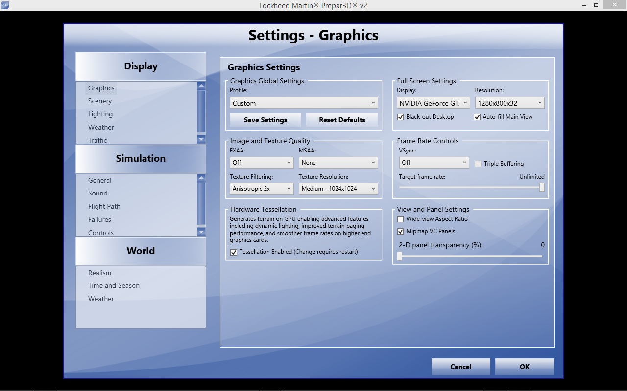

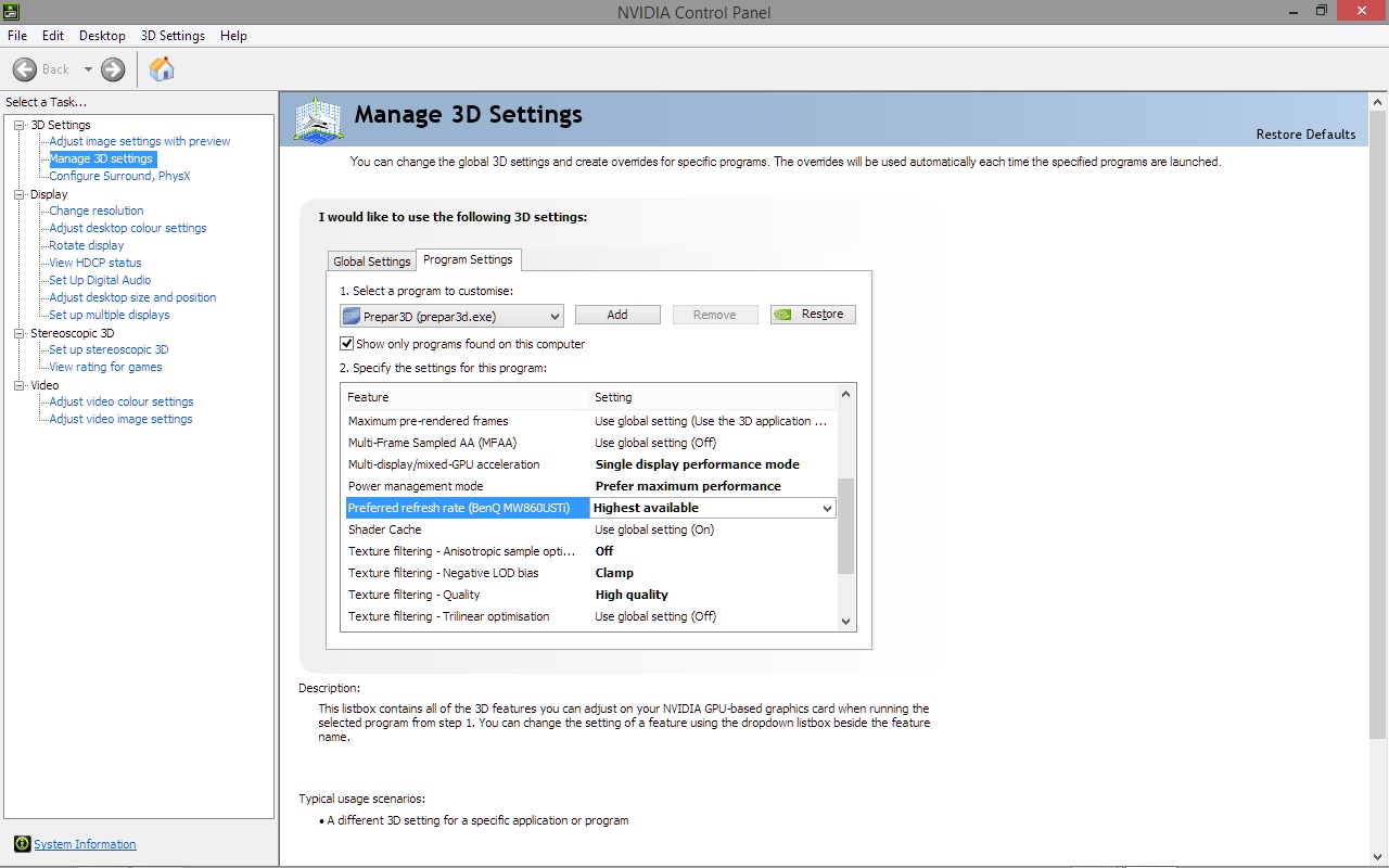

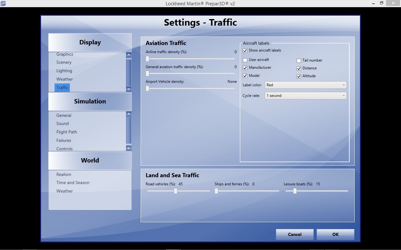

    I'm trying prepar3d v2.4 but every time I run the game, Simtools game manager crashes, checked that SimTools_GameManager.exe.config where in the Simtools folder but keeps crashing, any tips?
    Also, I get a constant 20fps without the DK2 so I think it has to be with the config of the game, but I can't find a menu to change graphic settings :confused:
  18. noorbeast
    21,723
    152,051Coins
    +11,063 / 56 / -2
    Is this the error you get or something else: http://www.xsimulator.net/community/faq/fsx-prepar3d-net-error.156/
    What your graphics card is and your settings make a huge difference to what you can and can't enable with P3D in VR.
    I am just setting up P3D and am just waiting for some OrbX update downloads to finish, so my setting are not yet final but I get well over 100fps without the Rift and over 50fps with the Rift on the GTX 970 without overclocking. If you have 20fps without the DK2 your graphics card may be struggling or you need to lower your settings. You can access P3D settings from the menu:

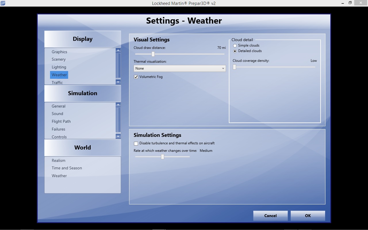

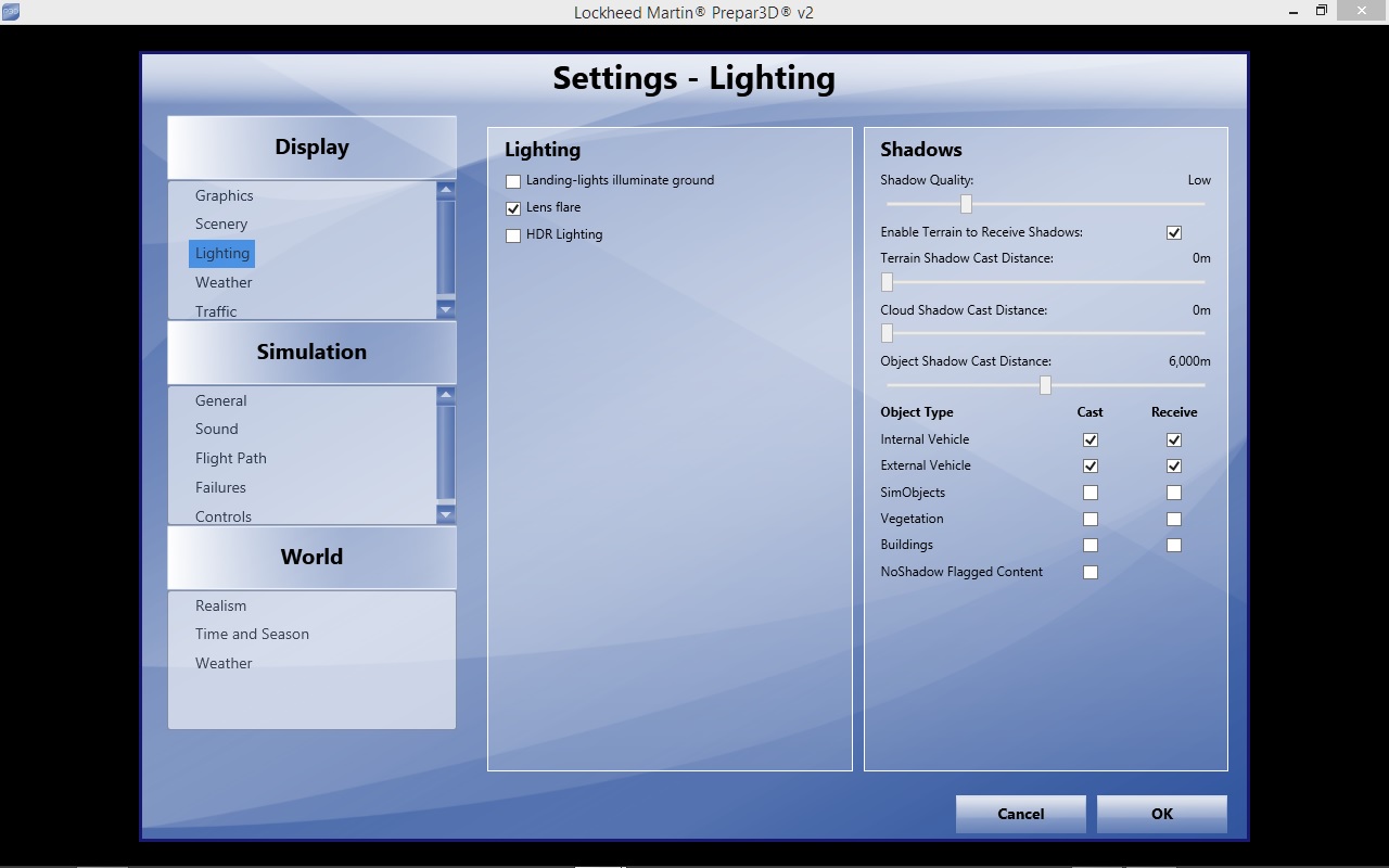

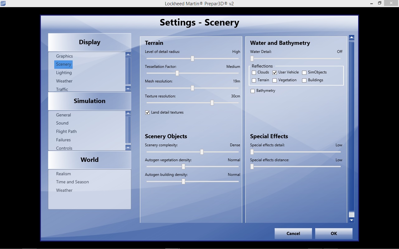

    These are my In-Game settings at the moment, I may tweak them a little further once I update OrbX, as that has a slight performance hit:

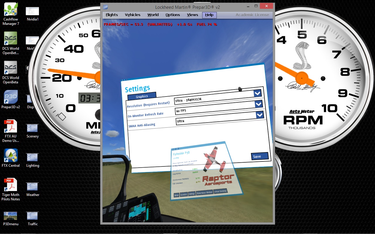

    I am presuming you are using FlyInside for VR support, is that correct? If so it makes you disable FXAA and MSAA, which results in pretty down graded graphics with the Rift. I tweak my Nvidia settings like this, which gives much better in Rift Graphics:

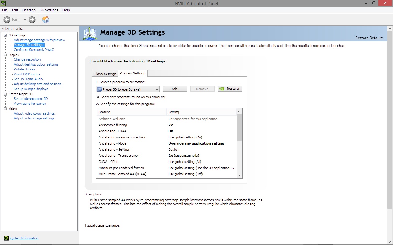

    These are my FlyInside settings:
    Keep in mind all of my settings are tweaked for my GTX 970 card and the OrbX addons I run, and these settings give me a smooth VR experience. But different hardware would make a bit difference, so just use it as a general guide on balancing the need for high FPS and graphics quality forP3D VR.

    Thank you very much!
    I'm running a i5 4670+, GTX 770, with 8gb ram. Not that bad to just get 20fps.
    I will try prepar3d v3 with flyinside demo and I will use your settings as a guide to see what happens.
