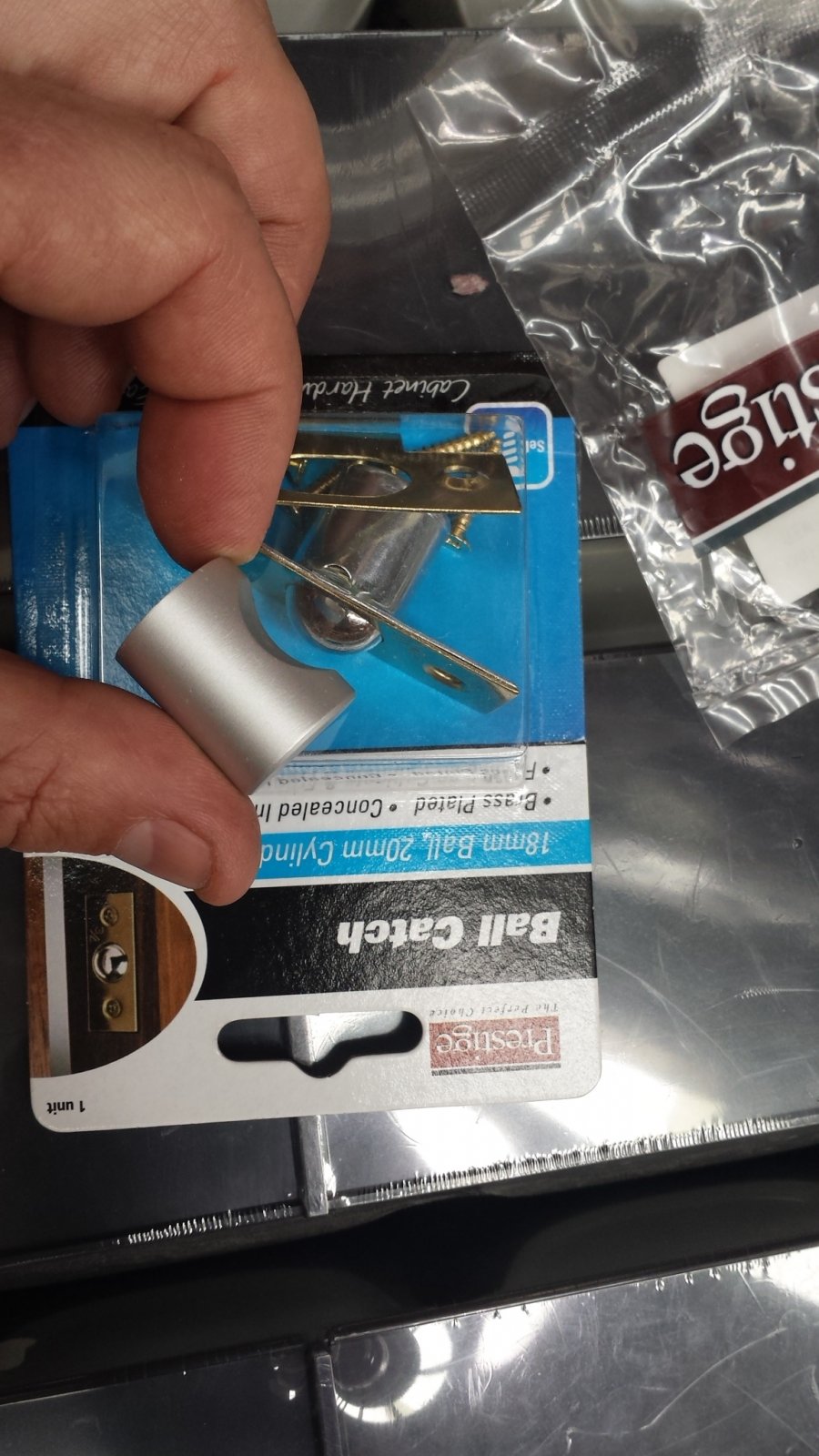

    I went to hardware store to find a suitable ball spring and some form of catch.
    I found a 18mm door ball catch and some small draw handles. It looks like a possibility in setting up.
    Catch ball $8 , handles $5 . @f1iceman

    You could use a piece of Flat steel (or RHS) and drill 19-20mm holes all along it so the ball engages into that to give you the notchy feel?
