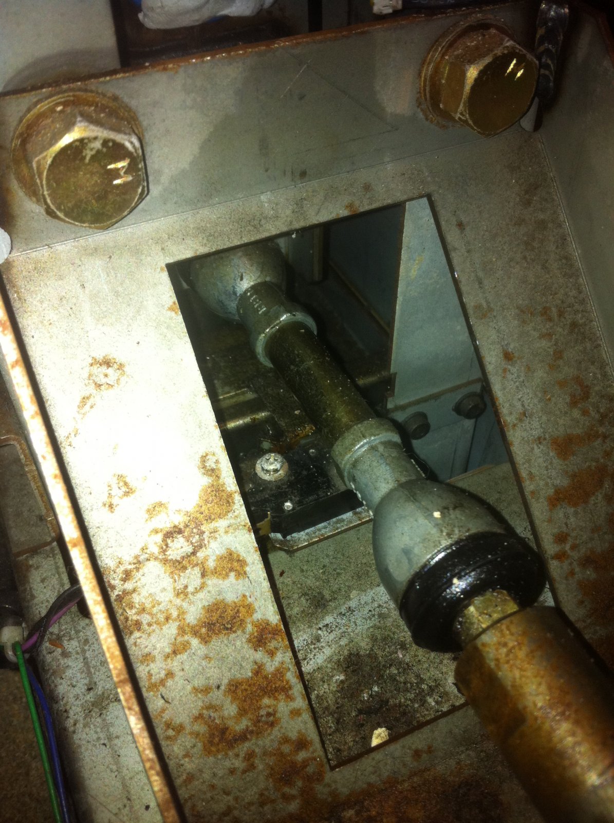

    Not sure if you all might be intrested in me posting more pics of this gearbox 6 speed or 5 speed with reverse.
    Its a real good setup from rdige racer arcad machine a proppa clonk feel to it like some older type real gearboxs :)
    If you want when i get spare time i will take a few bits off so you can see the way it all works.
    Also took a video but on iphone and will not let me up load it so will try sort that out if i can and you can see what its like.

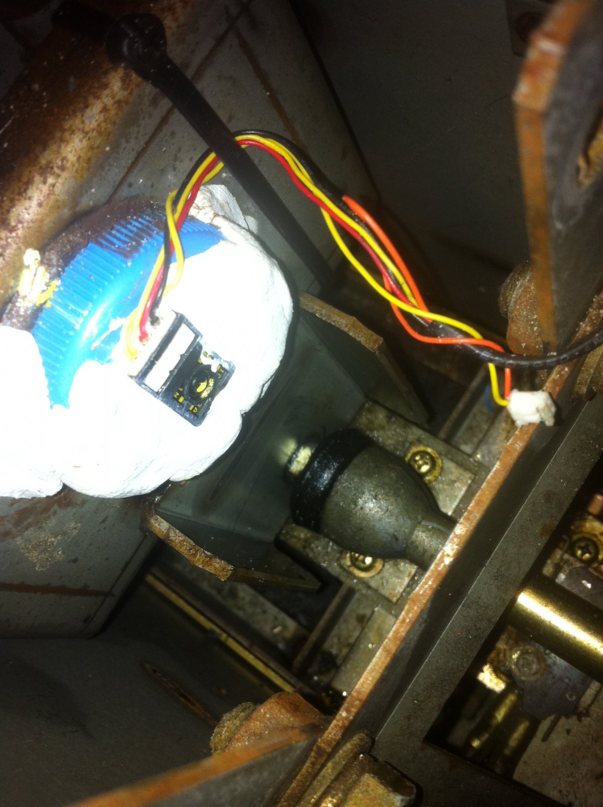

    Some how i thought you would all love this, it is cool tbh, and will try get a video sorted but not quite sure if i can get my iphone vids to upload.
    I will be on it tomorrow for you all and the way and the feel is amazing but a few mods could still be done to get a proppa mech feel of a real old school type gearbox.
    I was using it by adding the bits from the g25 stick to work with the moving parts of this and was ok but did miss sometimes due to my bad bodge getting the mod on it.
    I i was running pc and not ps3 it would have been easy to use the original switchs im sure.
    If anyone can help what i need to do to get my iphone to upload vids it would be a great help, and can show you it moving :)

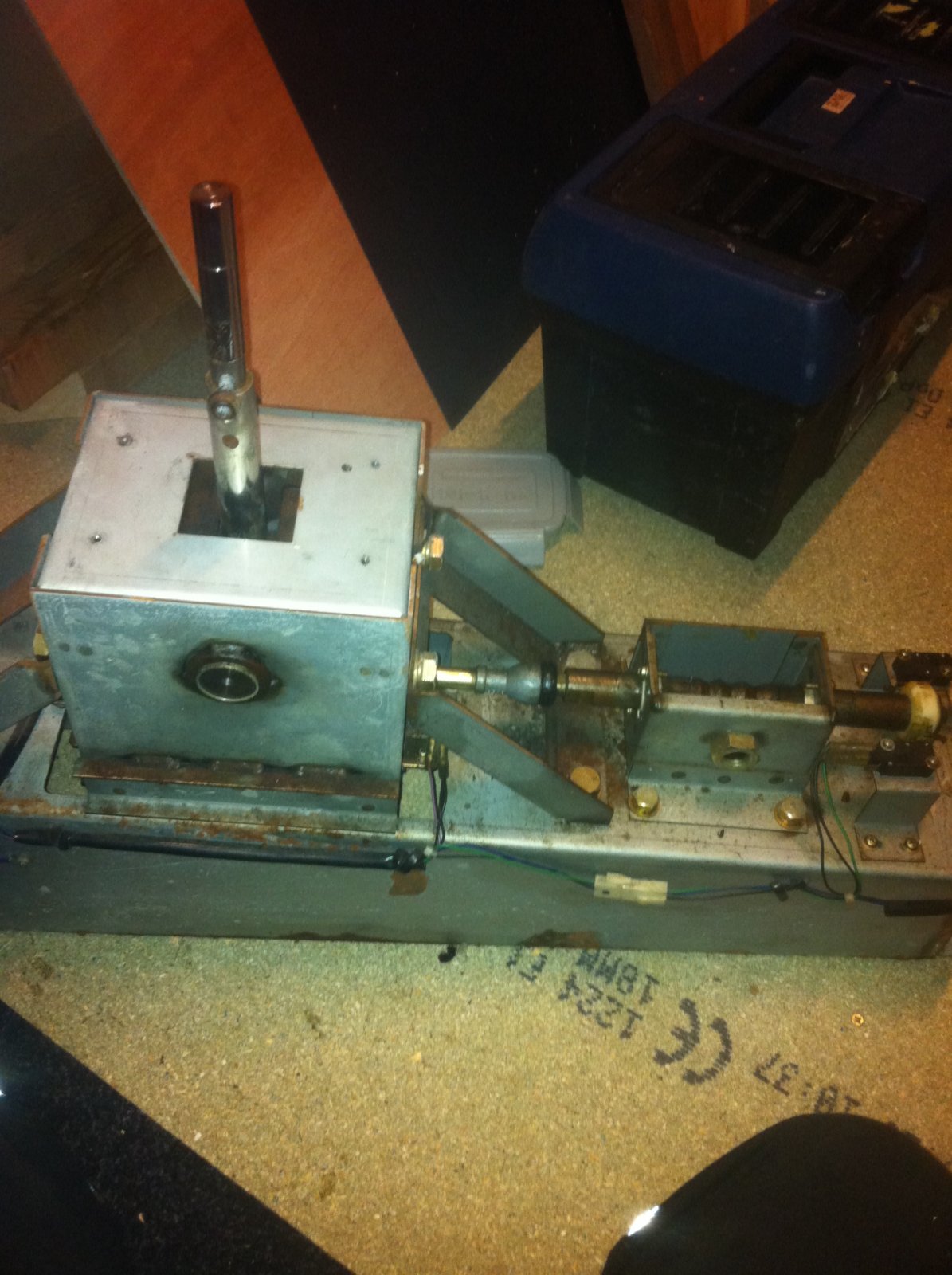

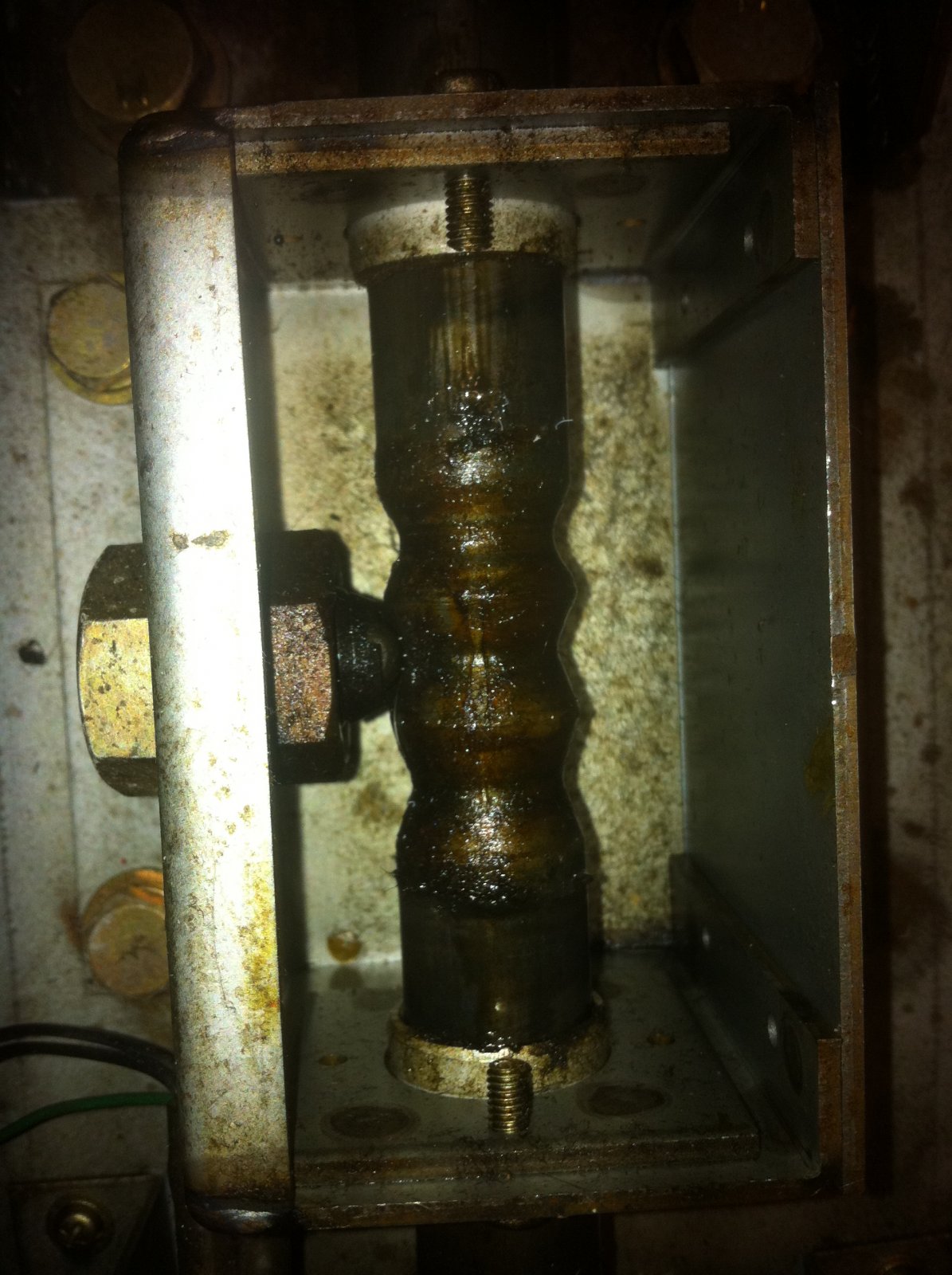

    The shaft you see is how it makes it click into gear, its a sprung ball bearing witch pushes on the shaft and the grooves as the stick moves forward or backwards, middle groove is neutral then forward/backwards selectingworks same for all gears.
    Inside it has a slider for left to right ect... but will get more on that asap.
    You could mod it how you want it to feel as it goes into gear via the ball bearing pressure /size or groove/size shape i guess.
    • Useful Useful x 2
  9. bsft
    I was going to say that, but you already pointed it out. Thats a good idea to give notchy feeling.

    I am thinking of making a design based on that photo alone

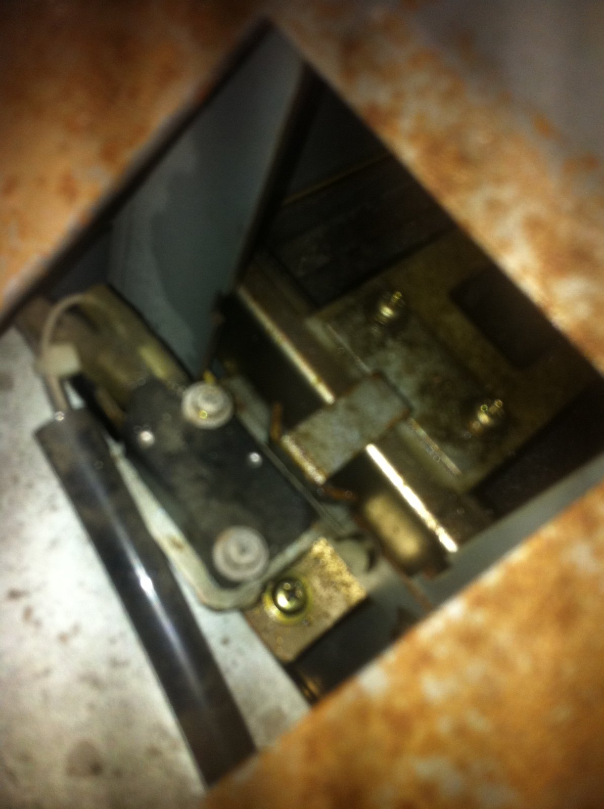

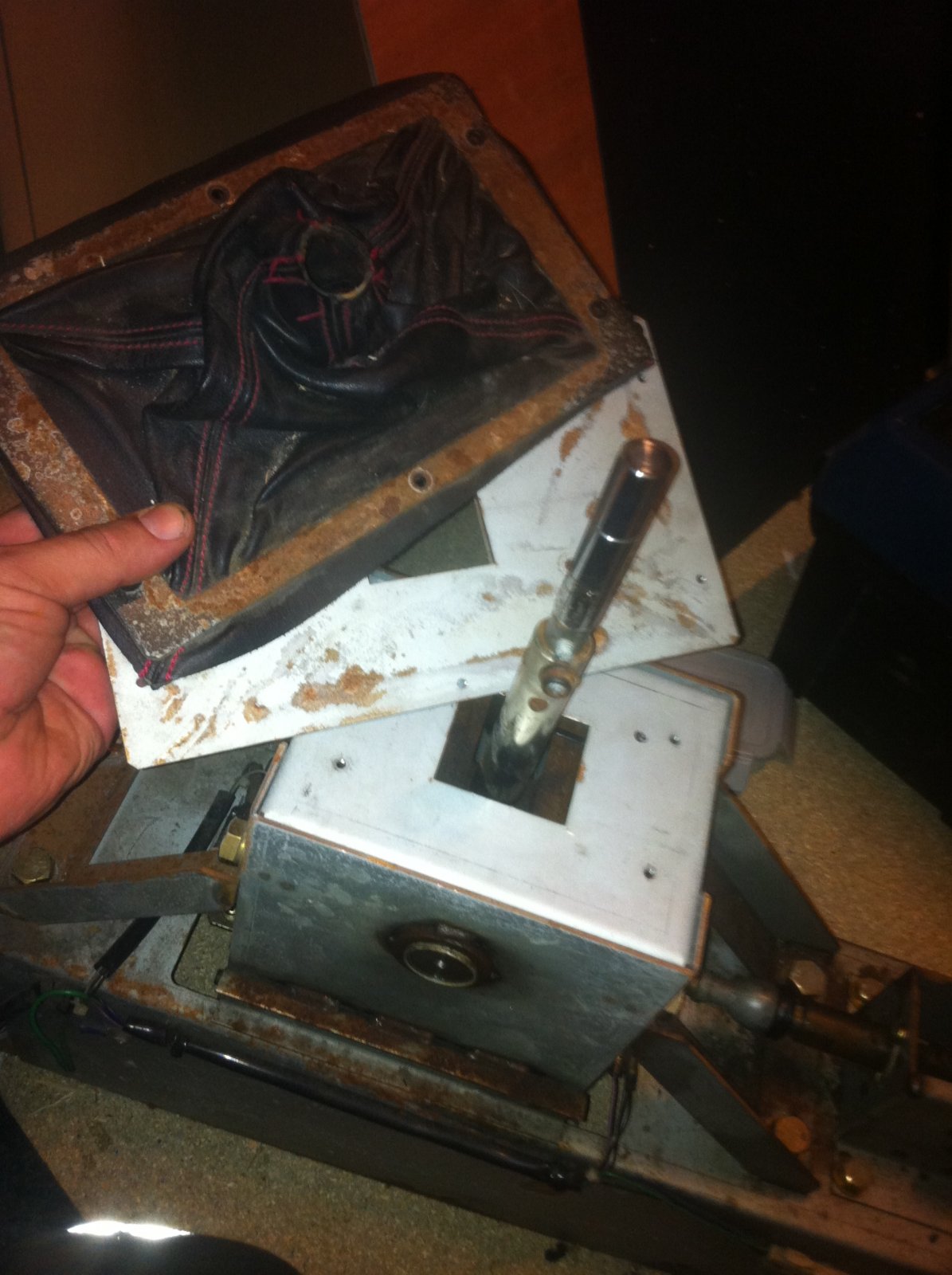

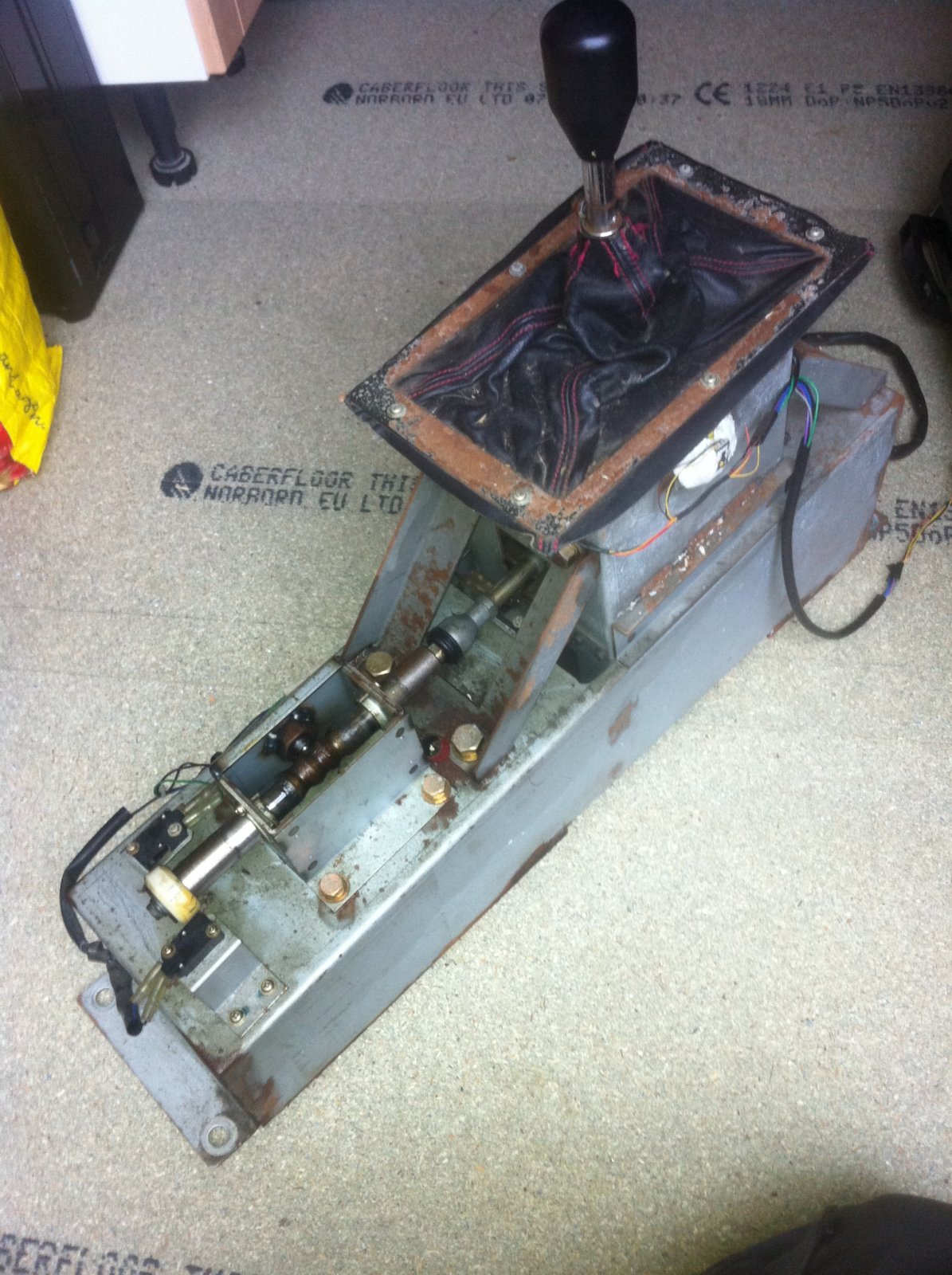

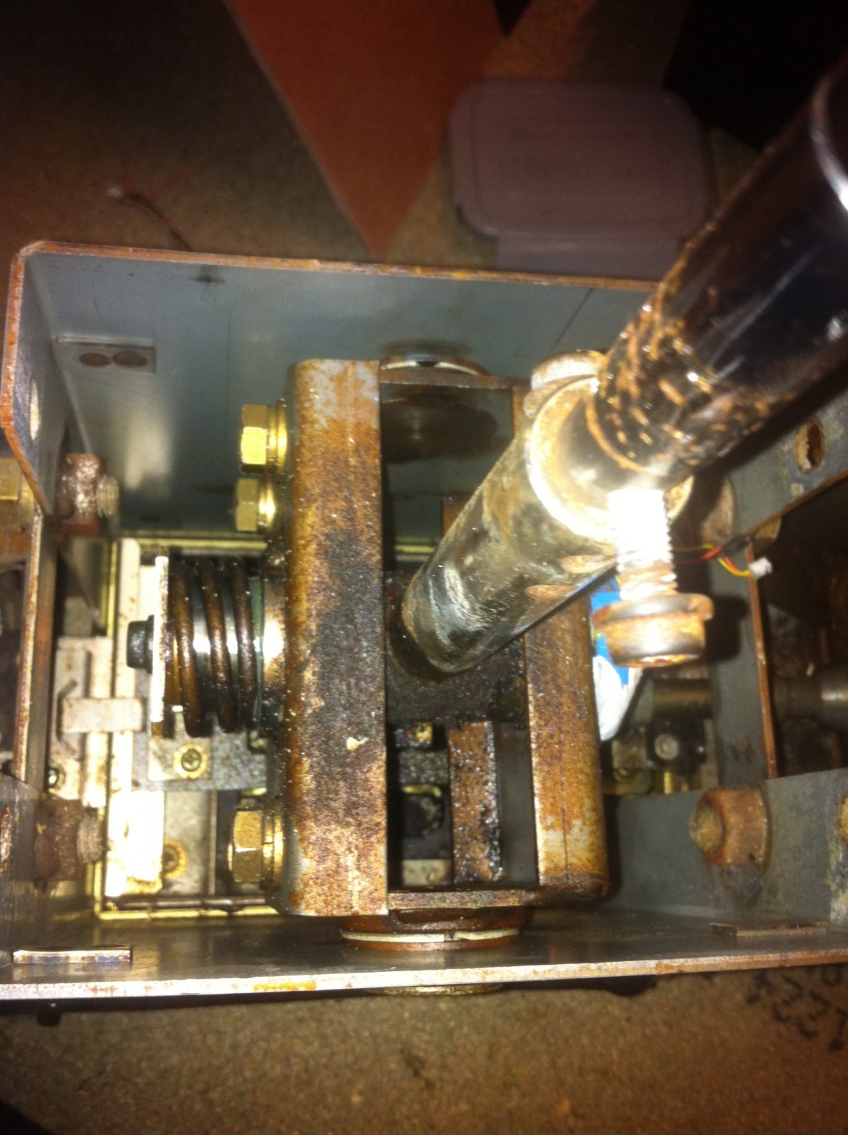

    Right guy n gals :)
    some pics for you while i sort the video out.
    Ignore the bodge bottle top and white putty ! lol
    IMG_9518.JPG IMG_9519.JPG IMG_9520.JPG IMG_9521.JPG IMG_9522.JPG IMG_9523.JPG IMG_9524.JPG IMG_9525.JPG

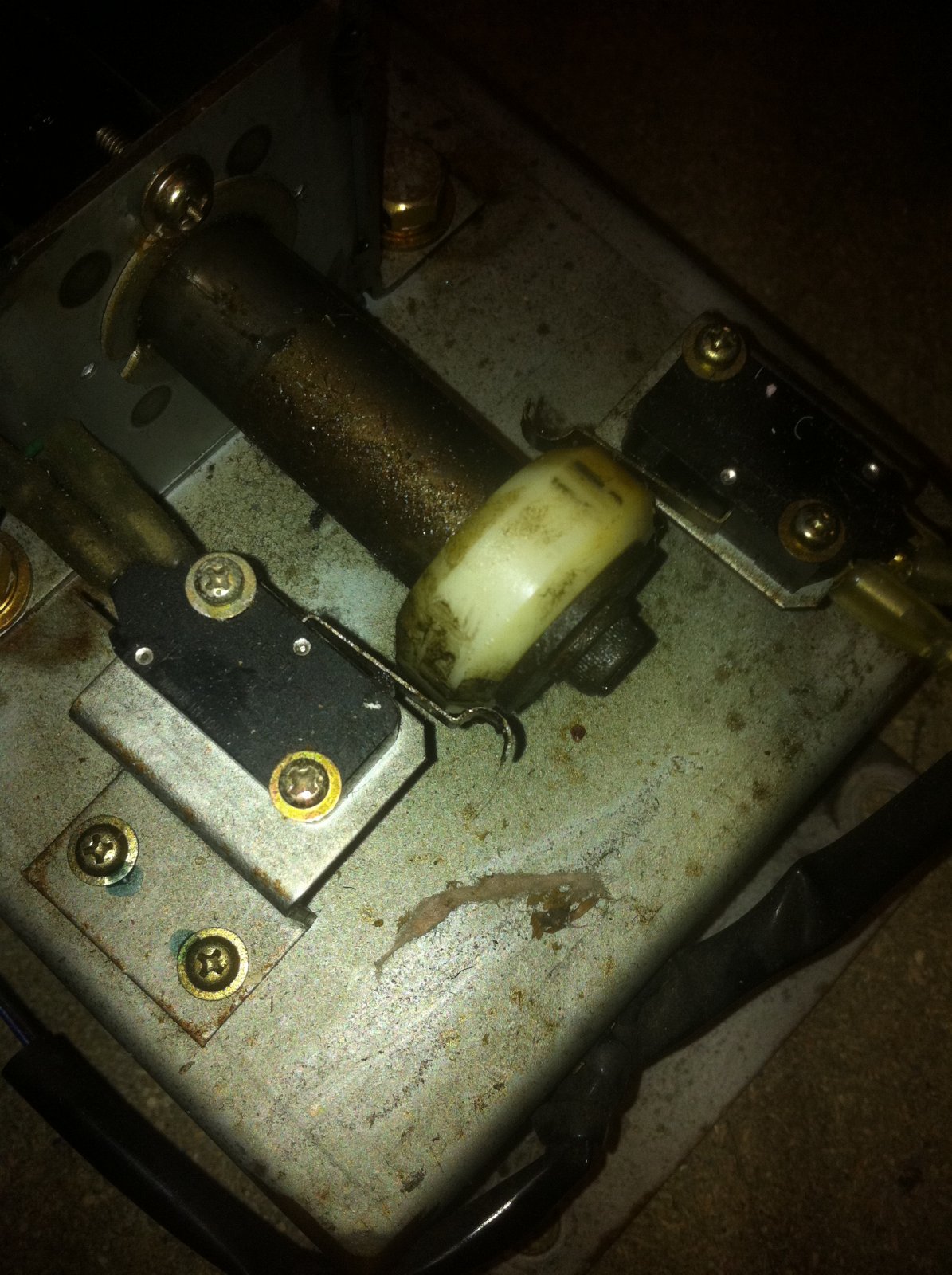

    M y first youtube VIDEO !!!
    you will se the switches used.
    Neutral left = clicks a switch then uses shaft switches by springed ball for gear 1 or 2.
    Neutral centre = no switch just uses springed ball shaft for gear 3 or 4.
    Neutral right = clicks a switch then uses shaft switches by springed ball for gear 5 or 6 or 6 could be reverse.

    I think with a bit of personal tinkering i could get this to feel as good as my MX5 and they have one of the best changes ever.
    It even has hight adjustabilty for the sticky out knob bit :)

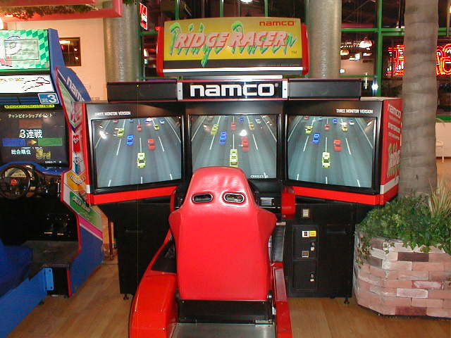

    ridge racer triple screen.jpg This it the system the gearbox came off.
    You cam most likley find the single screen version as some had the same seat base set up and think the same gearbox.
    This video is my friend with the actual machine i have that was his and its running and the only video you will possibley find of one (if you find another let me know) , its not great video but you can hear the gearbox clunk into gear ! lol
