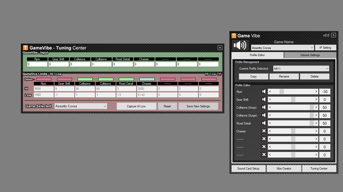

  3. Tom Frost
    Tom Frost New Member
    Jan 3, 2020
    6
    95Coins
    Hey!
    I've made some trial and error and looks like I've made it work. Now it feels more like an actual feedback, not just a constant vibration.
    I've attached my current Assetto Corsa values.
    Do you have any suggestions to my values or it's more like "try and test" for each individual setup?
    Also, how can I create gamevibe new effects (like adding an rpm vibe for the Wreckfest?)? Is there any tutotial?
    Thank you!
