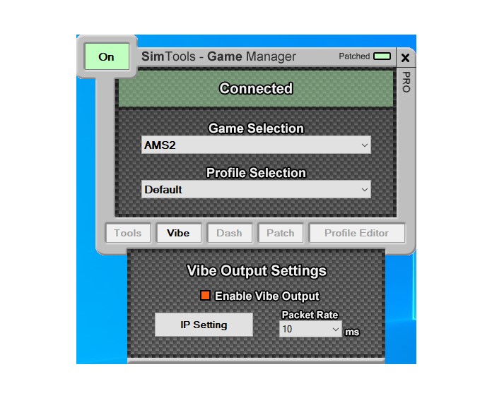

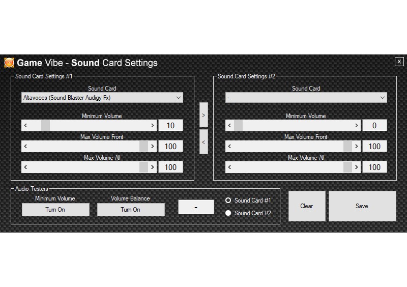

    I've changed my PC and, after a little problem with the rFactor patching, motion works perfect; but can get working the Game Vibe and it worked before with all the sims.
    I've done all the configuration process, and the test works right, getting vibration from all the four shakers, but when I get into any game (rF2, AMS 2, AC, ACC), can't get any vibration.
    This is the configuration for AMS2, but the other games are similar:
    No feedback error when runing the sims. What else can I try?

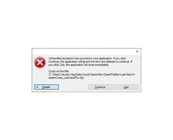

    If I open the Game Vibe and the Tuning Center windows, sometimes rF2 works (other times don't), but if I try to change the sim in the Tuning Center, I get this error:
    20,553
    145,136Coins
    +10,779 / 52 / -2
    Can you please hit the Details button on the error message then copy and paste the full error, that way @yobuddy can have a look and give some advice.

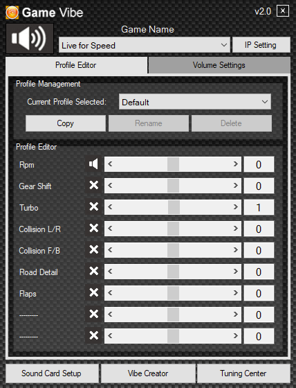

  4. yobuddy
    5,166
    48,214Coins
    +5,038 / 16 / -0
    Once you run the game once, the inputs should fill out like this.
    Then you just turn on the one's you want.
    (like rpm above is enabled, the little speaker vs an "X")
    Chat soon,

    This is the error text:
    System.IO.FileNotFoundException: Could not find file 'C:\Users\Usuario\AppData\Local\GameVibe\GameProfiles\LastUsed\AssettoCorsaCompetizione_LastUsedPro.cfg'.
    File name: 'C:\Users\Usuario\AppData\Local\GameVibe\GameProfiles\LastUsed\AssettoCorsaCompetizione_LastUsedPro.cfg'

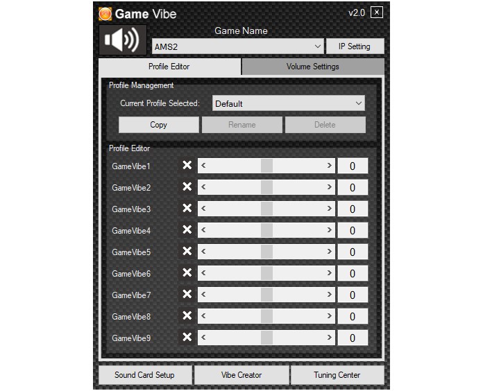

  6. Sento Siete
    Sento Siete Member Gold Contributor
    May 10, 2016
    41
    Valencia (Spain)
    304Coins
    +15 / 0 / -0
    2DOF, SCN5
    That's what I get while running rF2, but no vibe...
