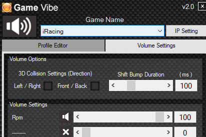

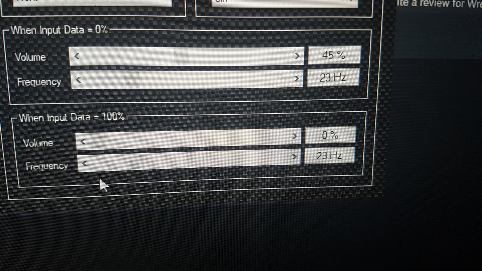

    Any reccomendations on the settings?
    I have the below for RPM (Sticking to one sound type for now)
    23Hz seems to be one of few choices that I can feel, does it look right? I can also hear the sound a bit as well as feel it, is that normal? All settings pasted below :)

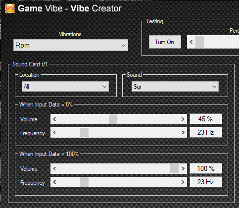

    RPM you want to set opposite to all the others ie when input data is 0% you should have vibration and when input data is 100% low or zero
    That way when car is started you will feel the car vibrate and as you rev the vibration will disappear

    like this (the testing slider will help feel whats happening when the car engine revs)

    That makes total sense, thanks!
