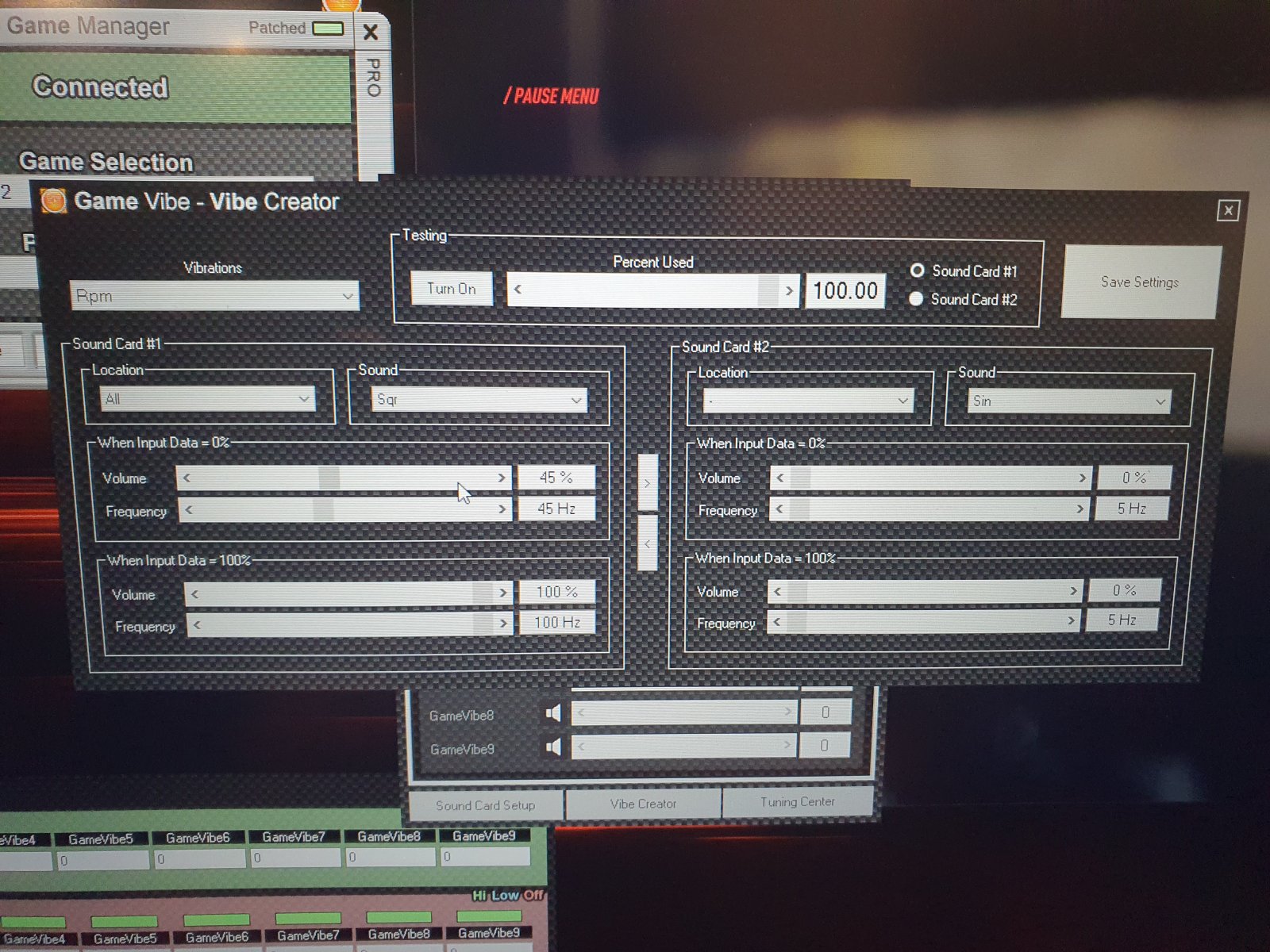

    Hi everyone im having trouble getting game vibe to change rpm output. I get tick over rumble but nothing else when accelerate ect. Can anyone help me

    Here is my settings

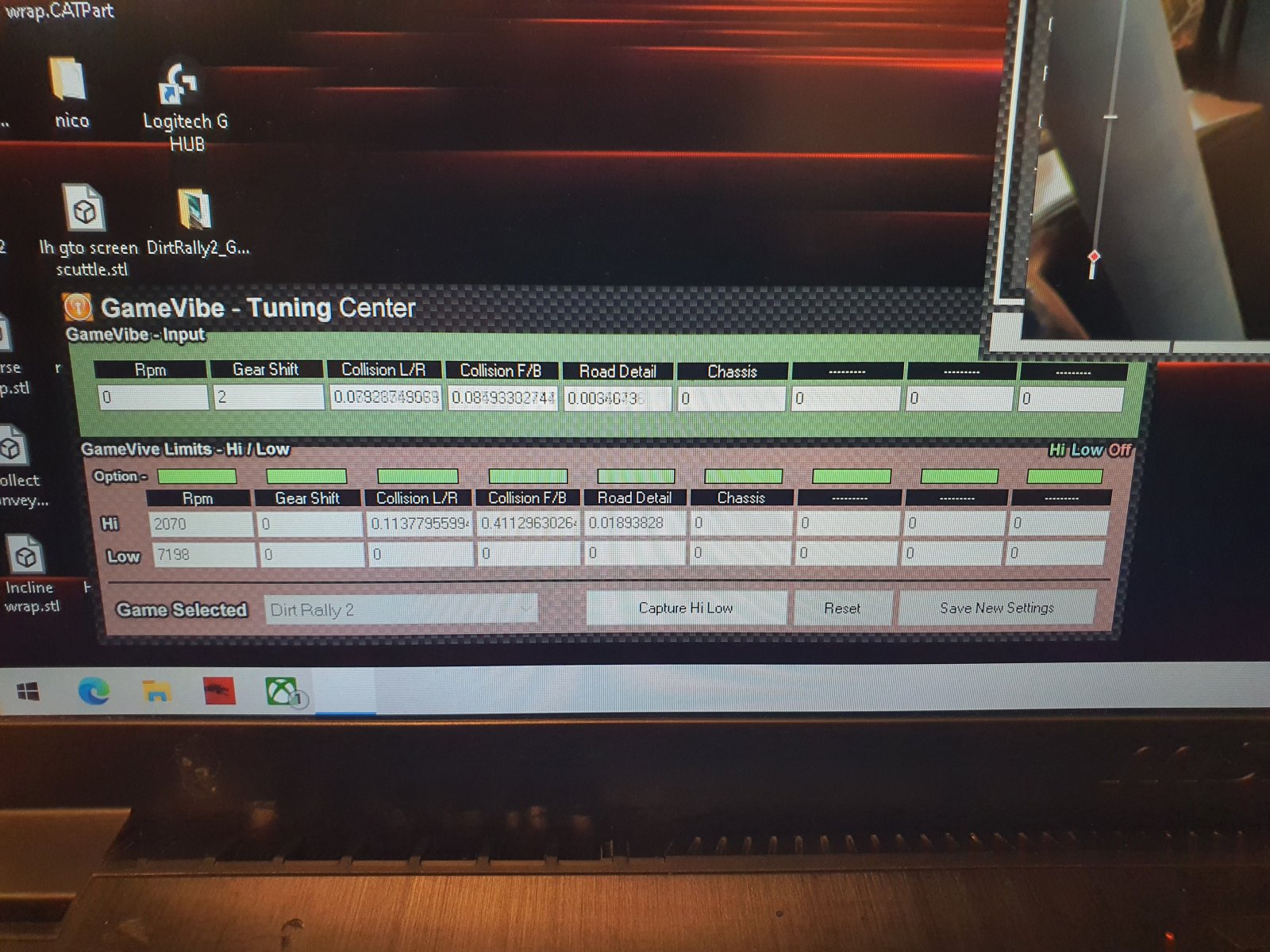

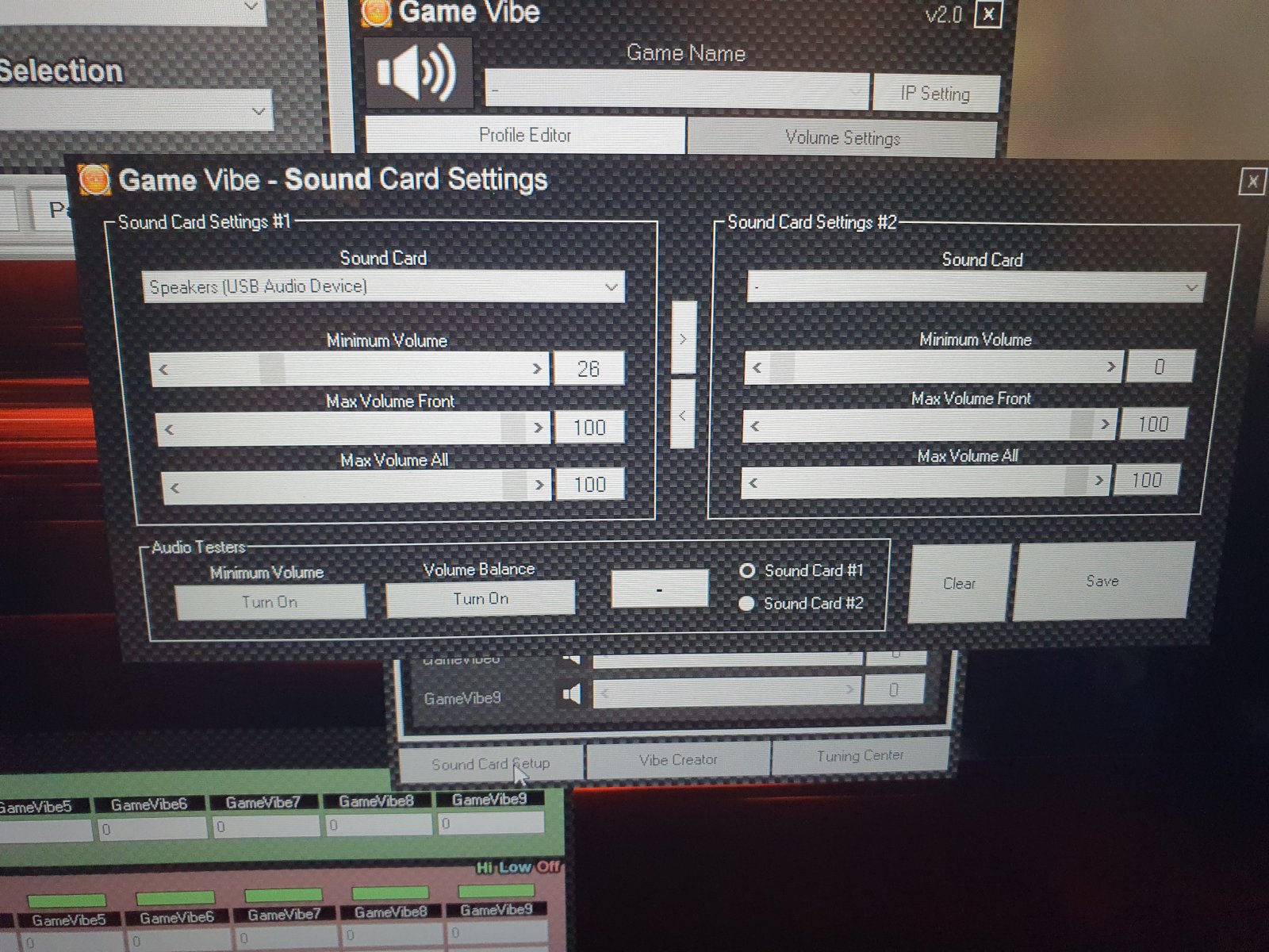

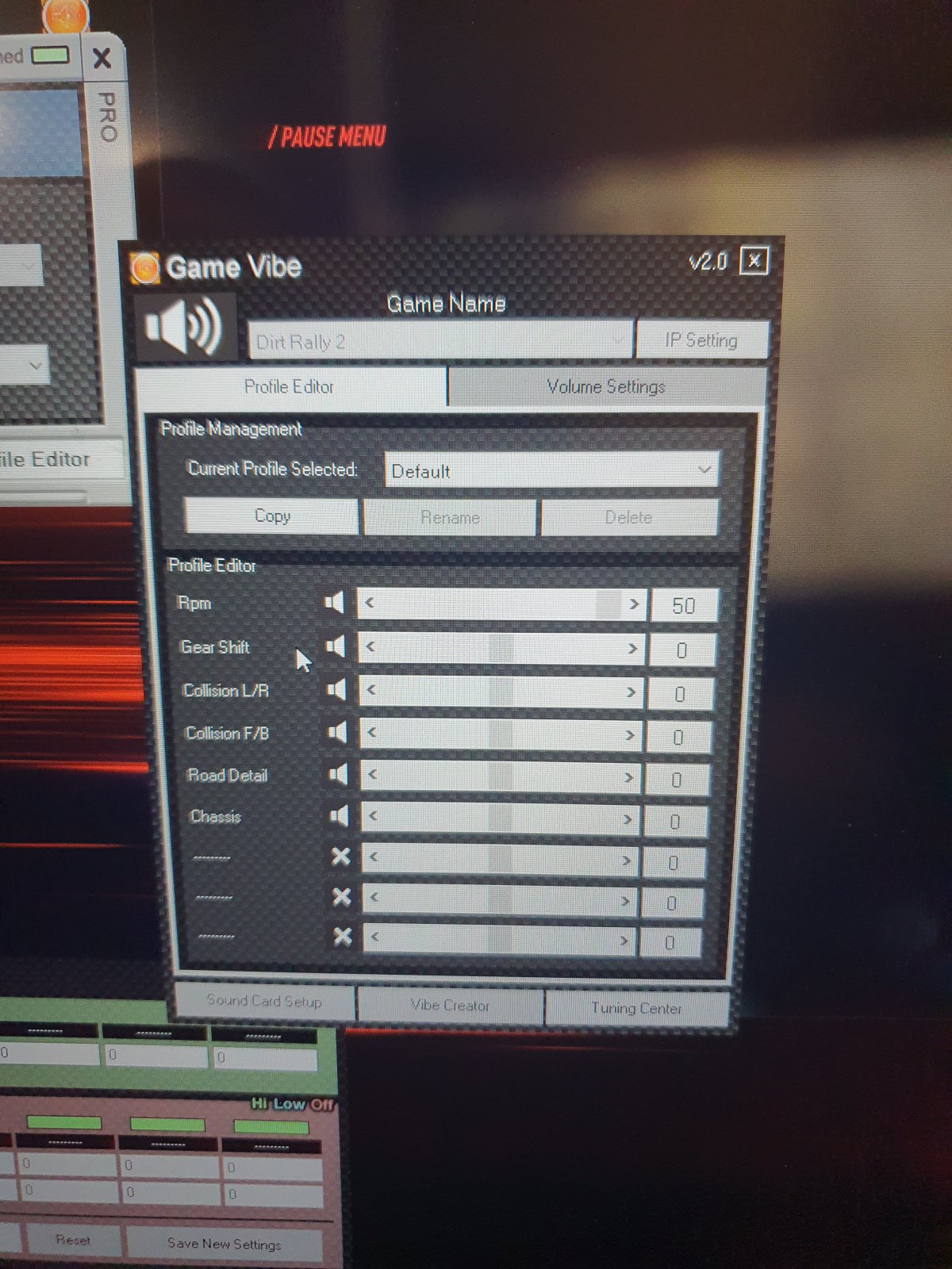

    Here are my settings

    There is maybe not on this specific pic tho. In green box i get rpm output

    It looks like your Hi/Low settings may be the problem, with the Low setting being higher than the Hi value.
    For a test, set the Low value to 1000 and the Hi value to 9000 and see what happens.

    Now you have pointed that out its clearly obvious. Thankyou.

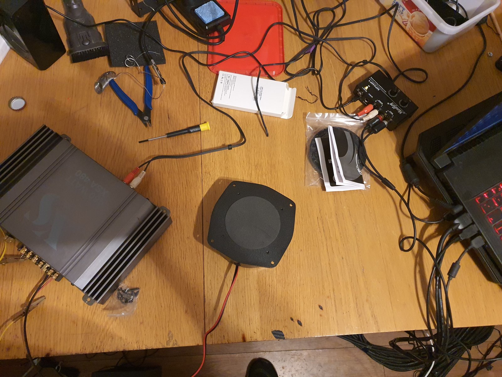

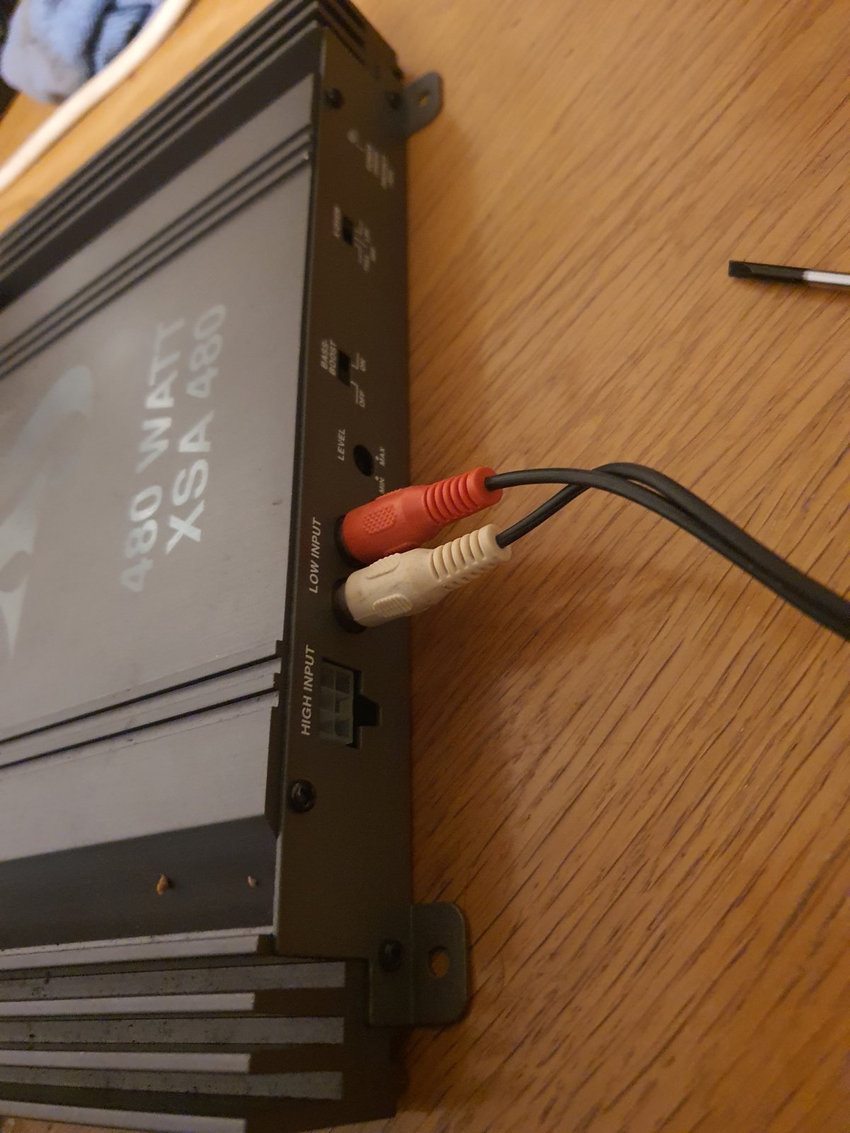

    Hi even tho it seems to work im not getting much differance. I have had an oscilloscope on the out put and it seems to change.
    The amp im using is for a sub in a car and my output is going into the low input. Do you think this is my problem? I also have a preamp in the system.
