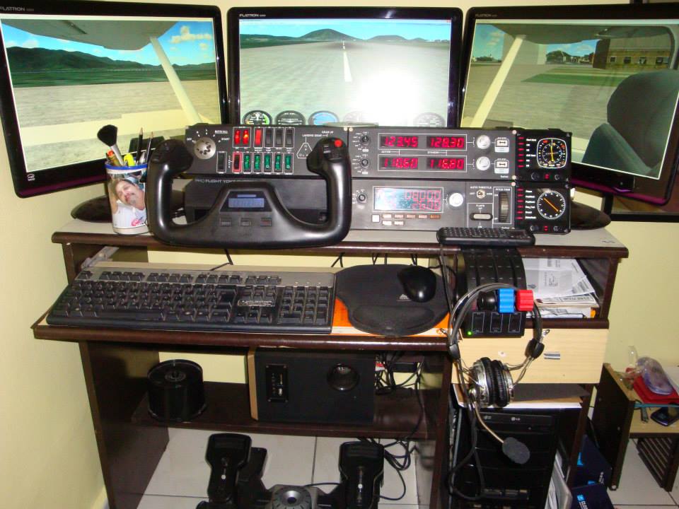

    I'll start my first 2 DOF for FSX, I hope to learn here with you.
    I'm accept coins donate.
