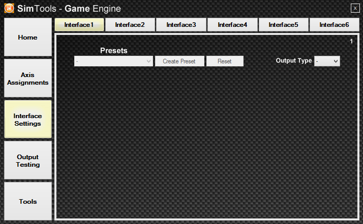

    Yobuddy,
    Just did the test with no SCN configured, sending motion to nowhere, same issue, Game Manager closes after few minutes of game play! :-(
    So, I guess it is not the SCN interface then?
