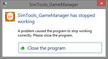

    Guys,
    I have been struggling with this problem today.
    Don't remember it happening before.
    But, today, running either GSC or AC, the Game Manager closes by itself after 2 minutes of game play or so.
    On GSC, it gives no msgs, just closes itself silently.
    But, on AC, it gives the following error, no details:
    Game engine keeps running:
    Things I tried:
    . Re-installed 1.2 (keeping my settings).
    . Changed USB ports speed down to 9600 (based on other treads).
    Neither helped.
    Tried other things like killing other processes, etc.
    Windows 8.1 64bits
    SCN5
    Any help is appreciated!
    Thanks.

    I've been having this problem also, sometimes I can go for a long time with no problems and other times it happens a few times in a row. Only this that fixes it is a reboot for me.

    Tried several reboots, nil fix.
    Just tried another SimTools install, from scratch, didn't keep any settings.
    Set up all from zero (pain in the neck), still same problem! :-(

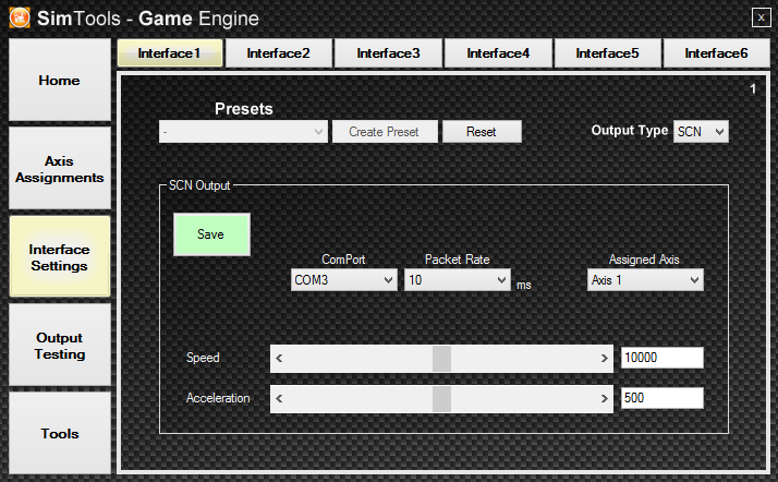

    What is the output packet rate to the SCN's?
    We just need to narrow down where to look for the problem...

    Yobuddy,
    I have them at 10ms, but I never touched that as far as I can remember, that is the value I have since first Simtools installation...
    I recently updated my plugins as AC had stopped working. And, I don't remember having this issue before that. :-(

    AC gives the error msgs I posted on my first msg.
    GSC gives no error at all.
    They are all the latest plugins.

    I tried setting the packet rate to 30ms (stopped even quicker) and 1ms, same issue! :-(
