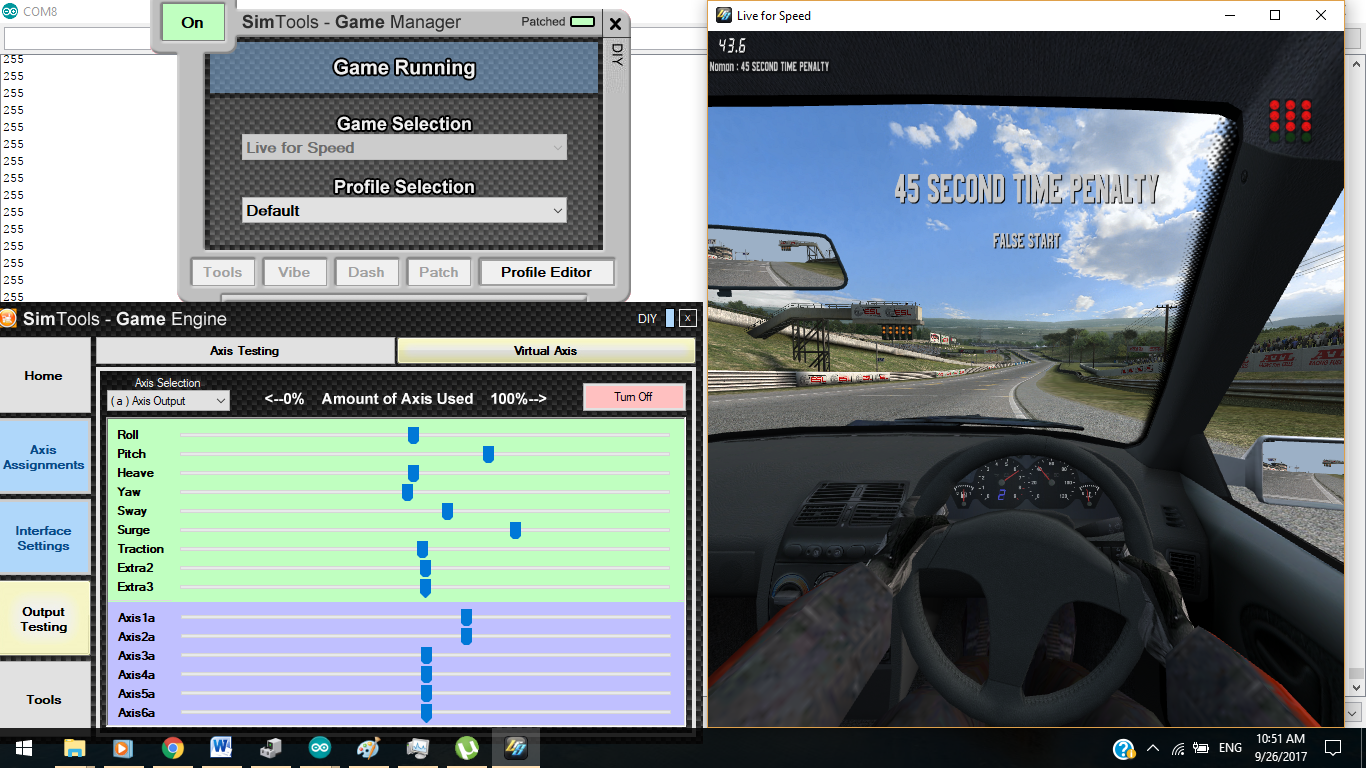

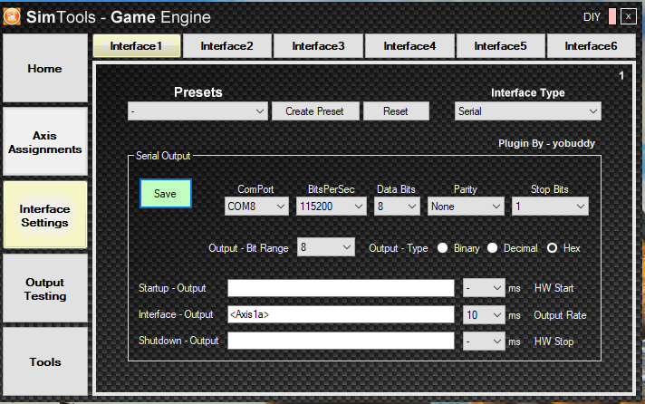

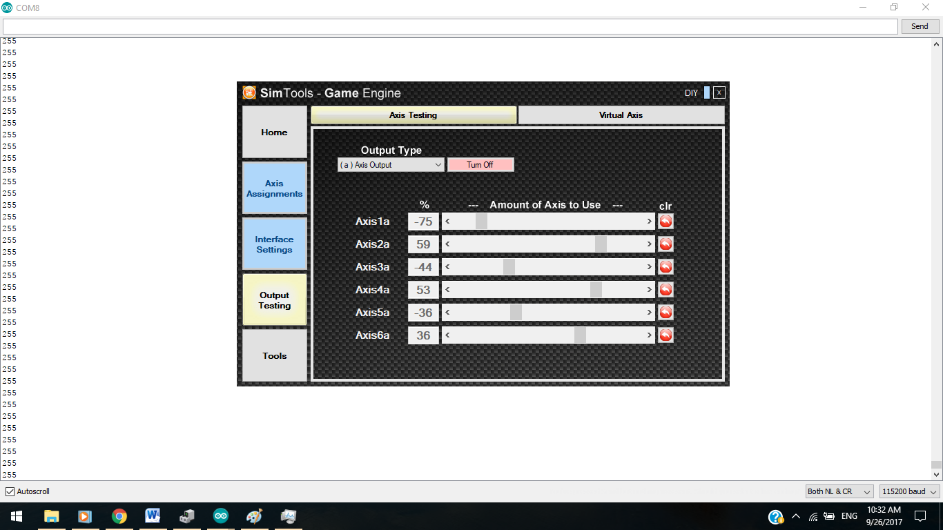

    My Game Engine’s Virtual Axis values are changing as I move in the game but in arduino serial monitor, values are not changing:

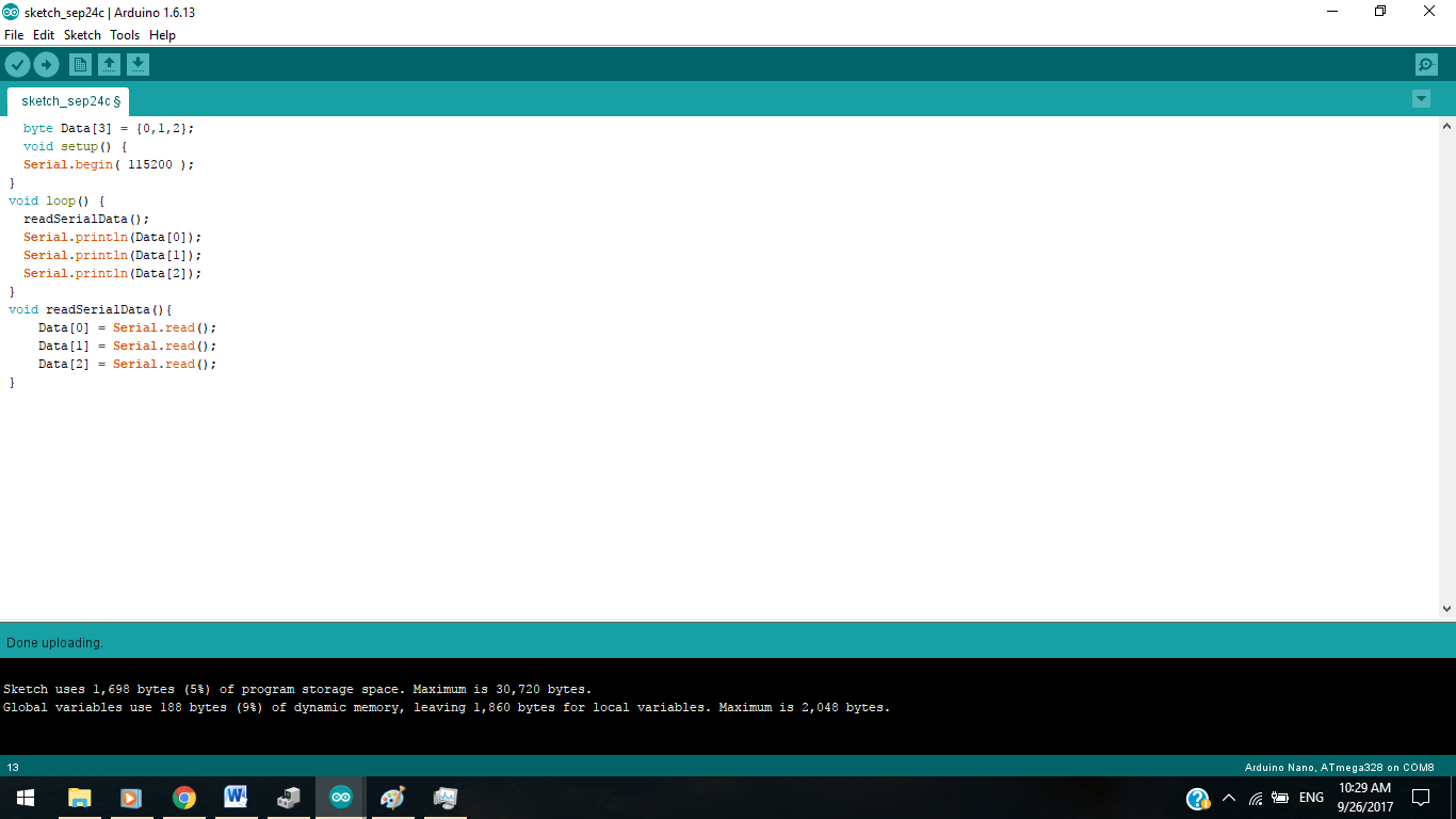

    The arduino program is very simple:
    It uses com8 and is a nano arduino:

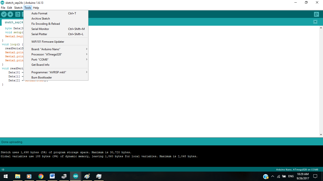

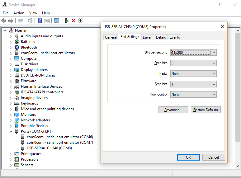

    Serial port settings in device manager are:
    Game Engine’s Interface settings are:
    Even if I write Axis1a:
    the Game Engine’s Axis Testing values are also not outputting the values to arduino via serial, I thought this was happening because I had no license but now I have SimTools license but still there is no serial output:

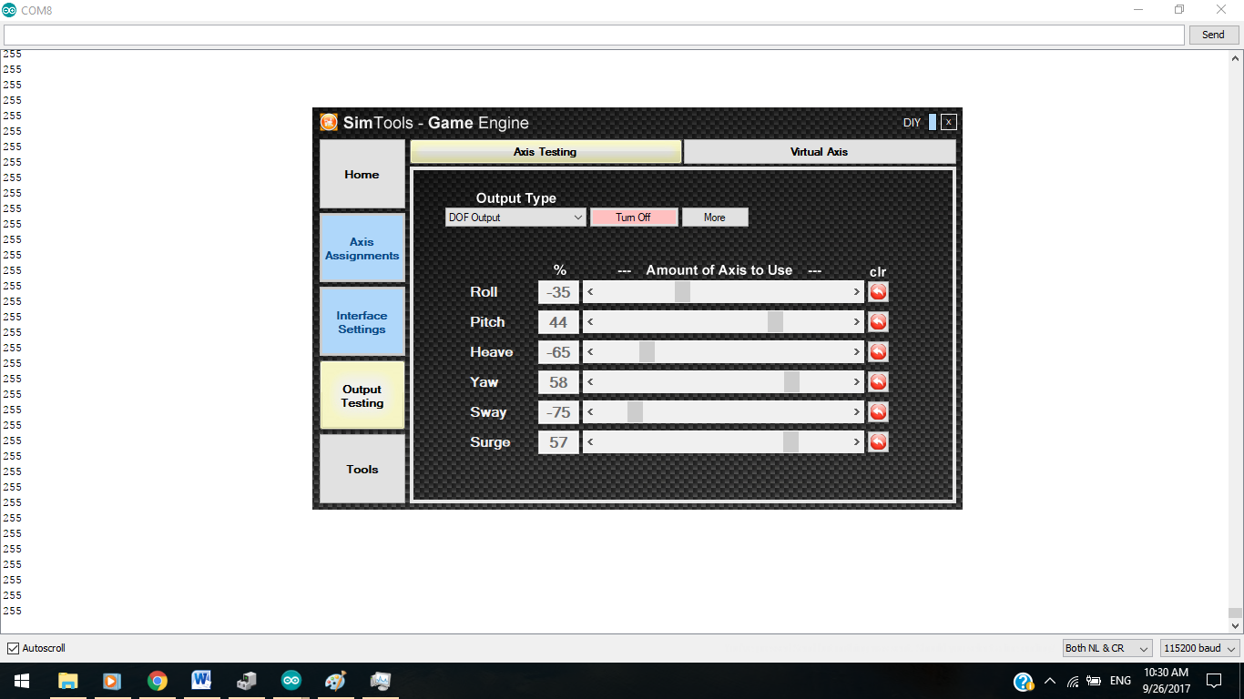

    Even if I set it to DOF output:

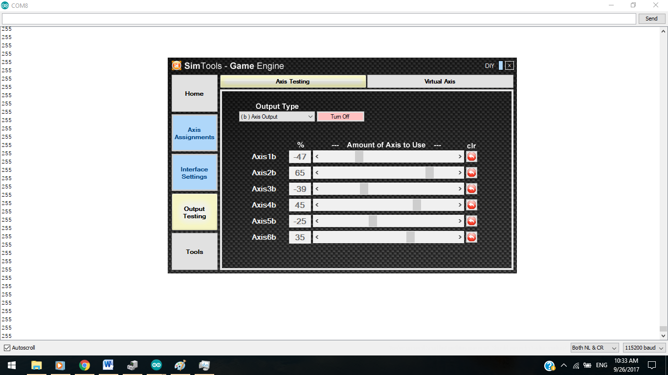

    Or Axis b Output:

    Please note, you are sending data as hex with the <Axis1a> version of your Interface Settings.
    Are you meaning to do this buddy?

    @yobuddy, I have also changed it to binary as well as decimal, still no result.
    Actually, I am trying to get serial output first, I will then manipulate the data after
