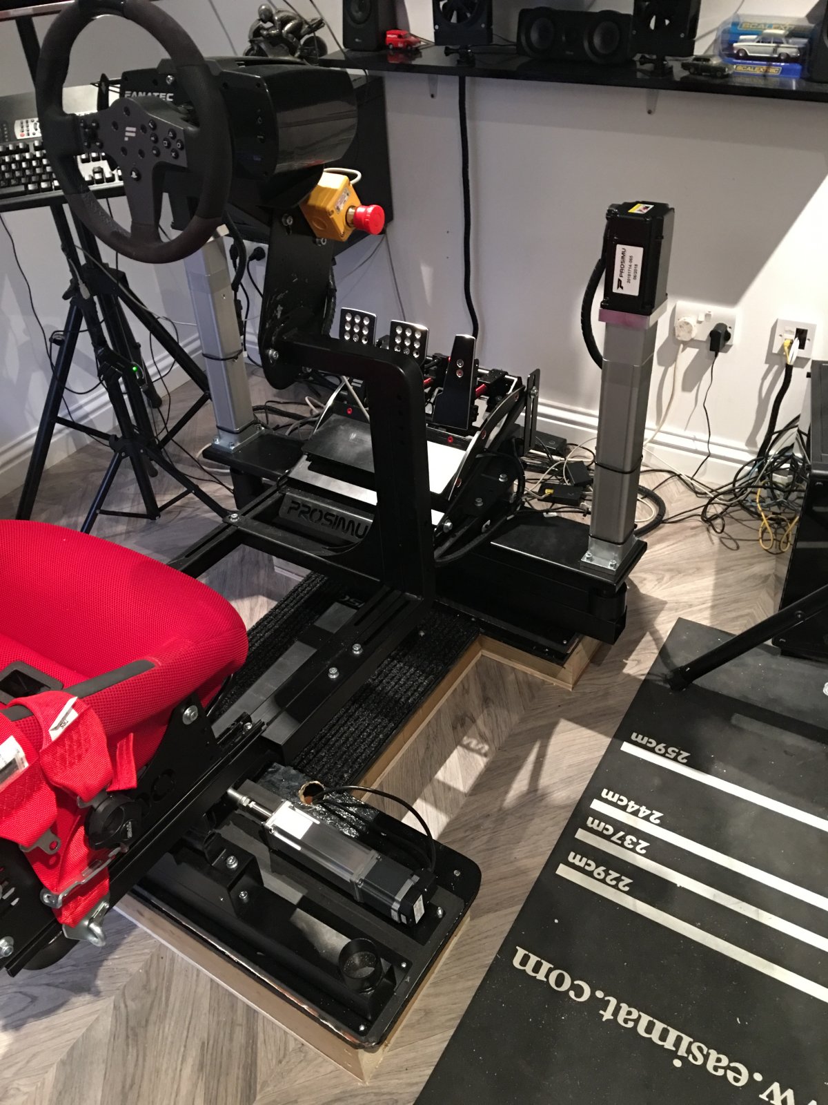

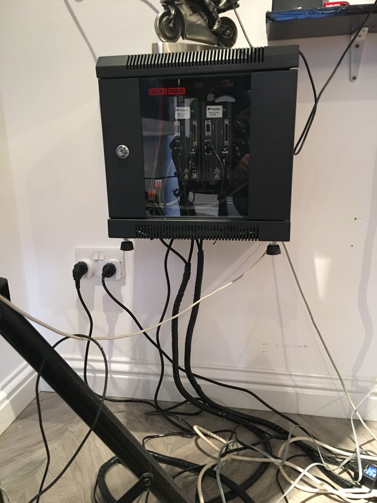

    Hi Guys, please help.
    All my settings are correct I believe, everything was working fine this morning. I came back to it about an hour later and now Game Engine pops up with the message: 'One of your interfaces requires game engine to be restarted. Please restart Game Engine'
    Please can anybody tell me how? I cannot find a restart button. I have spent hours exiting Game Engine and restarting via desktop shortcut, which has always worked until now.
    Thanks in advance.
    Dave
    Ps quick note, when powering up the actuators I hear the traction loss actuator and when the front actuators are powered up they rise and center it’s just the traction loss actuator that does not move and centre, if you start a game their is no motion,

    Should be video of my problem spent all day with no joy

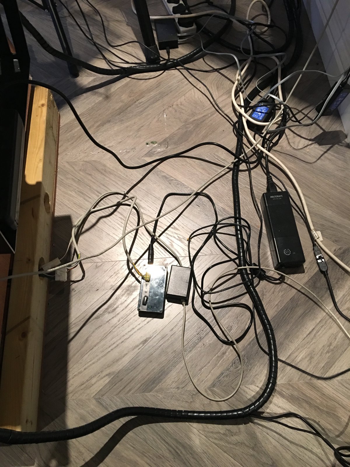

    Thanks for replying I have unplugged and reconnected the wires for the rear actuator and every time that actuator gets power it’s makes a small noise I haven’t tried fronts because they always rise and center , the USB’s make a Windows noise when unplugged and plugged back in I don’t know how to test USB’s
