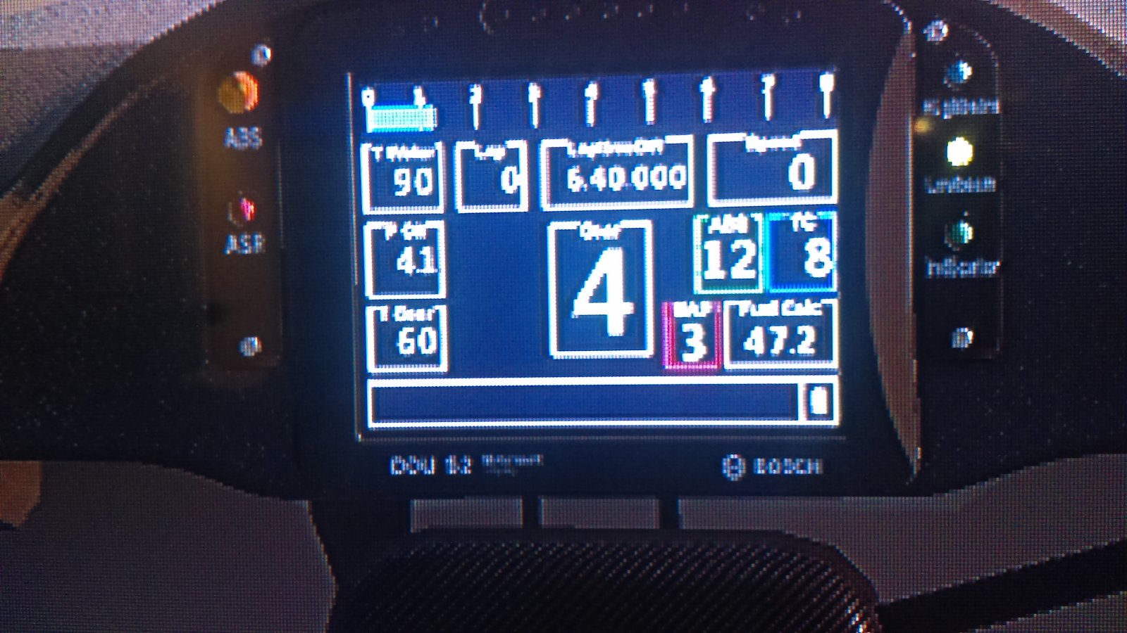

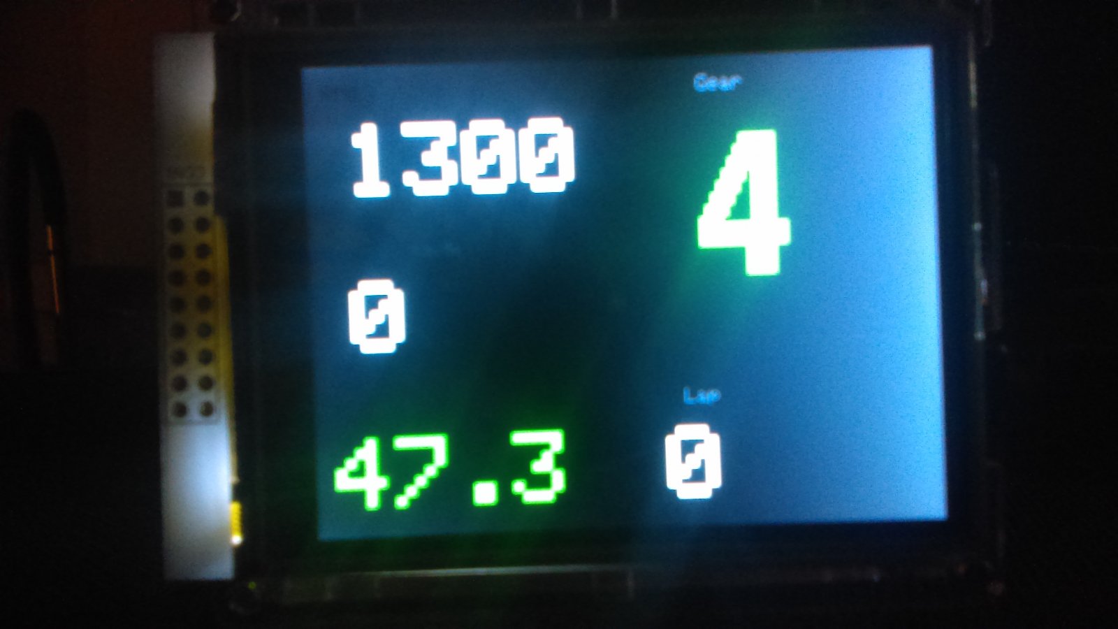

    here are the pics of the matching dash to dash

    57600 is where everythings on the screen properly every other one the screen is all over the place... the fella that made the dash told me yesterday that the script has been done for simtool 1.3 and wont work on dash 2 i asked if i could learn how to mod it but ive not heard back to see if its possible..the 2 dashes are ..the left one is the dash ive built the arduino one the one on the right is the dash of the AMG GT3 on iracing im just showing that the info on my dash is correct to the info on the cars dash i just cant get it moving...if i leave iracing running and turn off the dash then change gear or start driving and plug the dash back in it will read whatever the cars dash said at the time it opened so i feel that its something simple to fix it..if its in the script im not sure im really trying to learn about how thing script stuff works..im starting an online course to try and get on top of this.. ass you no i had issues with my simulator to and had to reach out for help.. without you guys it would never work happy to say its not missed abeat... and id also like to be able to help people out and make some new ideas ive had to share with everyone..
