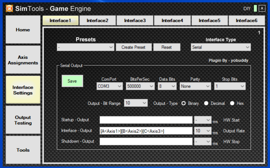

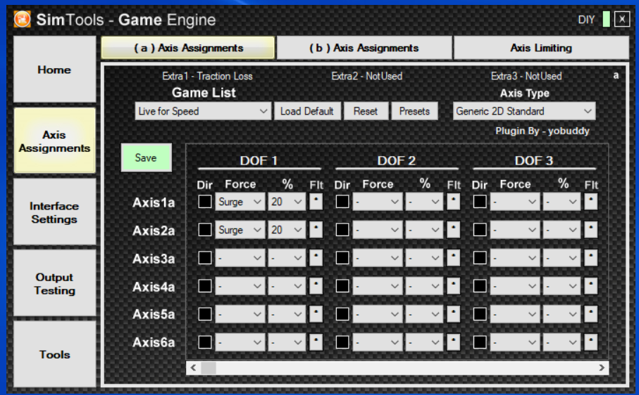

    Can Anyone help with my interface settings in SimTools? The Arduino connects fine in SMC3Utilities, but not SimTools. I am not running them at the same time. I can't get movement from SimTools either playing the game or using virtual axis. Another program (sim commander) does allow movement but doesn't allow me to customize to my machine. Any help would be appreciated.
    Thank You
    21,592
    151,215Coins
    Your Interface settings should be like this: [A<Axis1a>][B<Axis2a>][C<Axis3a>]
