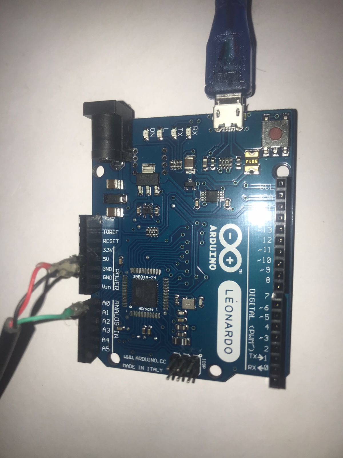

    Hello everyone . (I speak spanish, sorry for my english).
    Relatively recently, I did my first steering wheel. For economic reasons, I was unable to do with FFB.

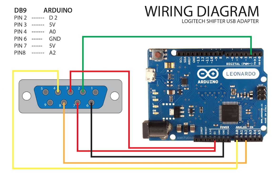

    Because of this a friend gave me a G29 shifter, but I don't have the G29 steering wheel, where in theory I would be connected, but I have my arduino leonardo with whom I built my home steering wheel.
    I looked for a usb adapter but they are very expensive, and my arduino board still has plenty of connectors (attached photo). So I thought about making that adapter with the same board so everything works with one set.
    My steering wheel works with MMjoy, and I don't know how to make the steering wheel work the g29 adapter on the same board.

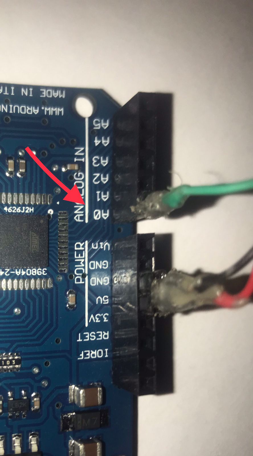

    I have seen tutorials in YT and use a file where the code for the G29 is, are also the connections to the arduino, but there is the problem, the adapter also occupies the A0 pin that uses my steering wheel, and can both work in a single arduino?

    I’m sure it can work just fine. You probably just need to change the analog input numbers in one of the sketches and bake them together. Post the code you have and maybe someone can help you.
