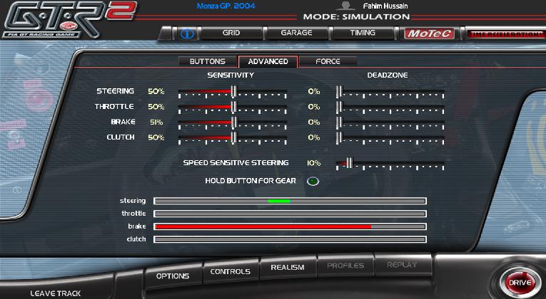

    Hi guys,
    Please find picture attached.
    I managed to get some new rubbers for the loadcell.
    When I press the brake full the red bar is at 100% showing full braking.
    But after a few laps when braking FULL the red bar only shows around 70% meaning the car is not breaking full so I end up in the gravel :).
    Has anyone else noticed this problem in andy pastore load cell mod? I have tried 100% sensitivity but cannot get the red bar to be full. problemloadcell.jpg
    P.S I have just installed the leo bodnar g25 cable.
    PROBLEM SOLVED BY USING LEO BODNAR PROFILER PROGRAM.

    For some reason the cable is not working properly. When you connect it in the usb it just closes off the other devices in other usb's. I have plugged the pedals directley into the steering wheel and the pedal works.
    But when I plug the pedals into the leo bodnar cable. It does not power up. It just powers off my G25 Wheel which is plugged into the next USB port. I have tested the USB ports with USB Storage devices like the mini giga sticks and the USB's work fine.
    When I open the Caliberation program it is always blank.
    Any clues?
  17. Fahim
    Fahim Member
    Dec 11, 2008
    472
    523Coins
    I plugged the cable into laptop that is windows XP and it works.
    For some reason my computer with windows VISTA does not recognise the leo bodnar cable anymore.
  18. Fahim
    Fahim Member
    Dec 11, 2008
    472
    523Coins
    Leo Bodnar emailed me.
    My pedals are mounted to steel with screws. He told me to remove earth connections from each pedal (g25) and then the cable started to work. There was some sort of short-circuit with the earths. (grounds)
