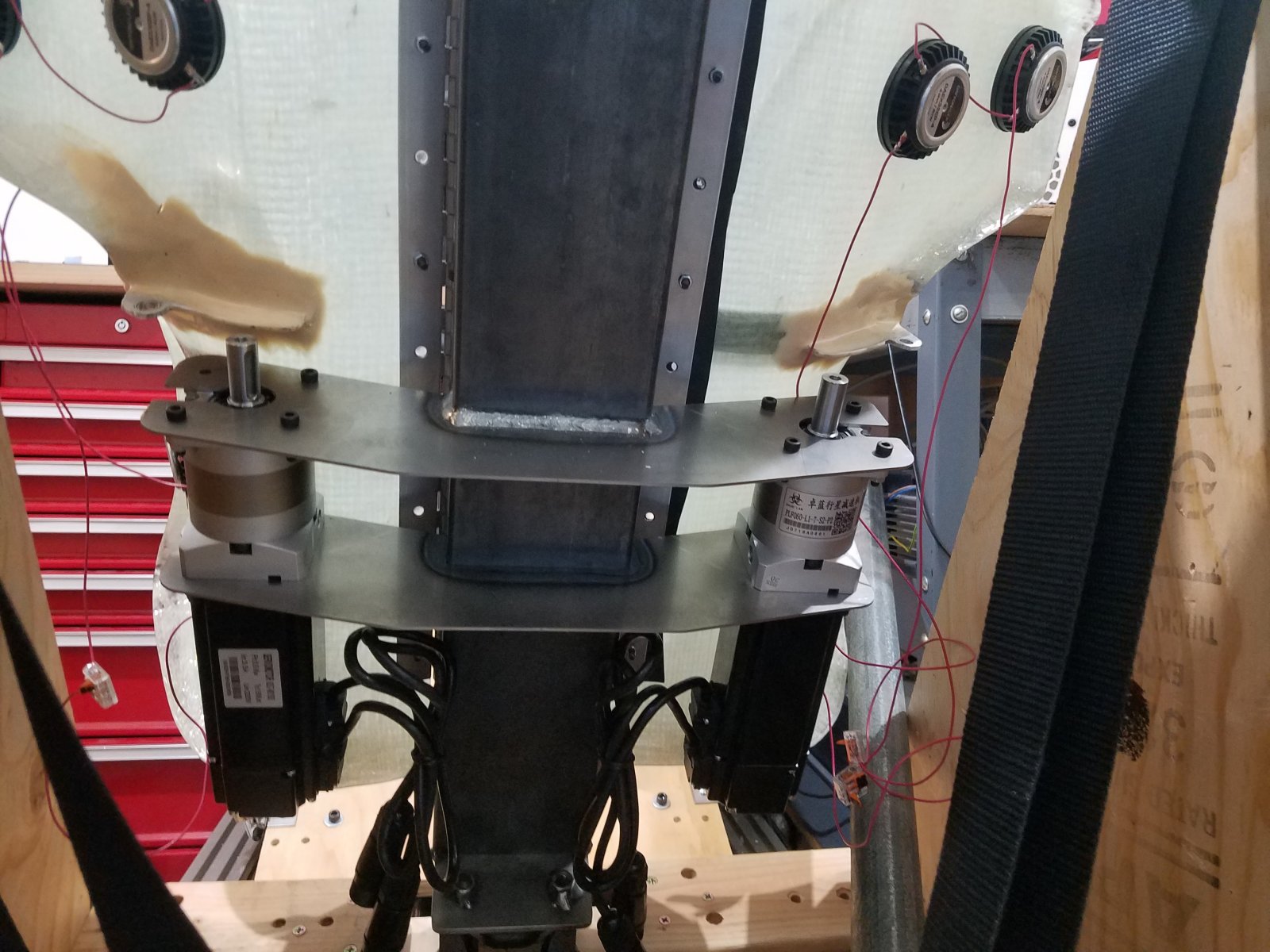

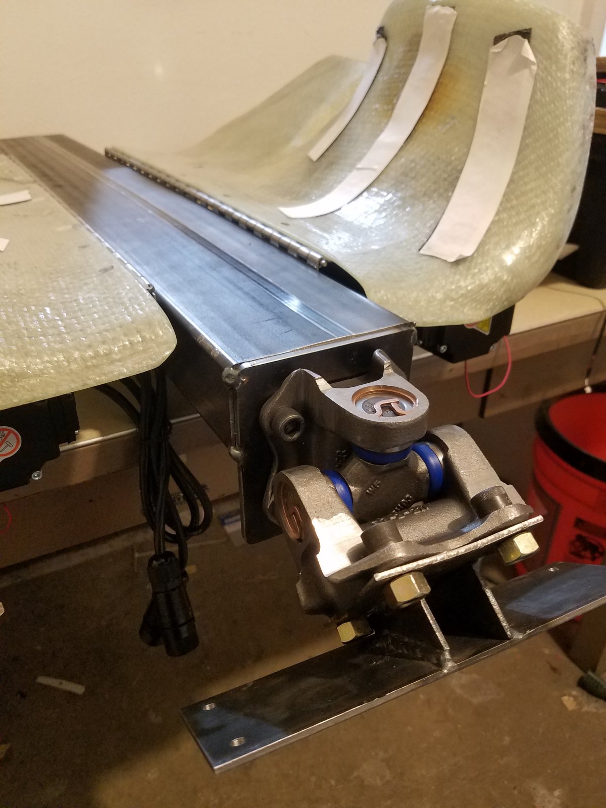

    What is your though on the vertical position of the torso mover U-joint? Do you feel it would be more effective if positioned lower so it creates more lateral input to the hips / lower back? Or would that create a false cue by moving the hips into the thigh paddles?
    81694
    Assembling
    81695 [/QUOTE]
  20. cfischer
    Sep 7, 2015
    399
    Colorado
    2,844Coins
    +276 / 1 / -0
    I spent a bit of effort(through trial and error) to reduce any extra input into the low back for the very reason you mentioned, reduce any false cues. As I played with different positions I picked the location that felt the least wrong.
