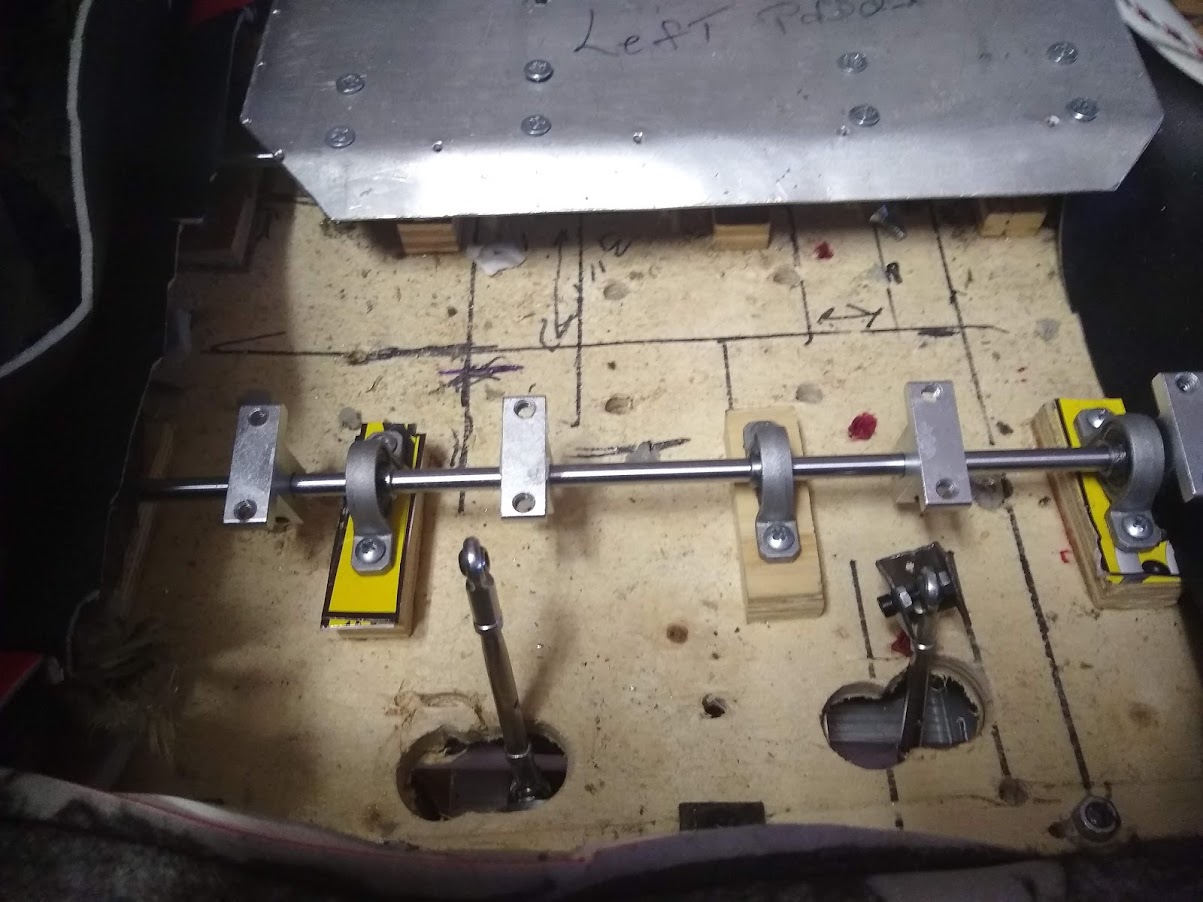

    If I recall correctly the swing out on the edge is about 50mm total travel.
    I did position the camera to maybe exaggerate this degree of movement.
    The original GS4 Gseat used 4 Hitec HS 805's which have a stall torque of 19.8kg.cm and a rotational speed of 0.19sec/60° at 5v dc. In the YouTube video Barry shows the power supply to be a 5 volt Meanwell.
    So each heave paddle only has about 80kg cm of power.
    The ASME-4a servos are faster and have a lot more power than 80 kg/cm
    I have to assume that with the big wide paddles and such low torque the servos in the GS4's heave section are always stalled out .

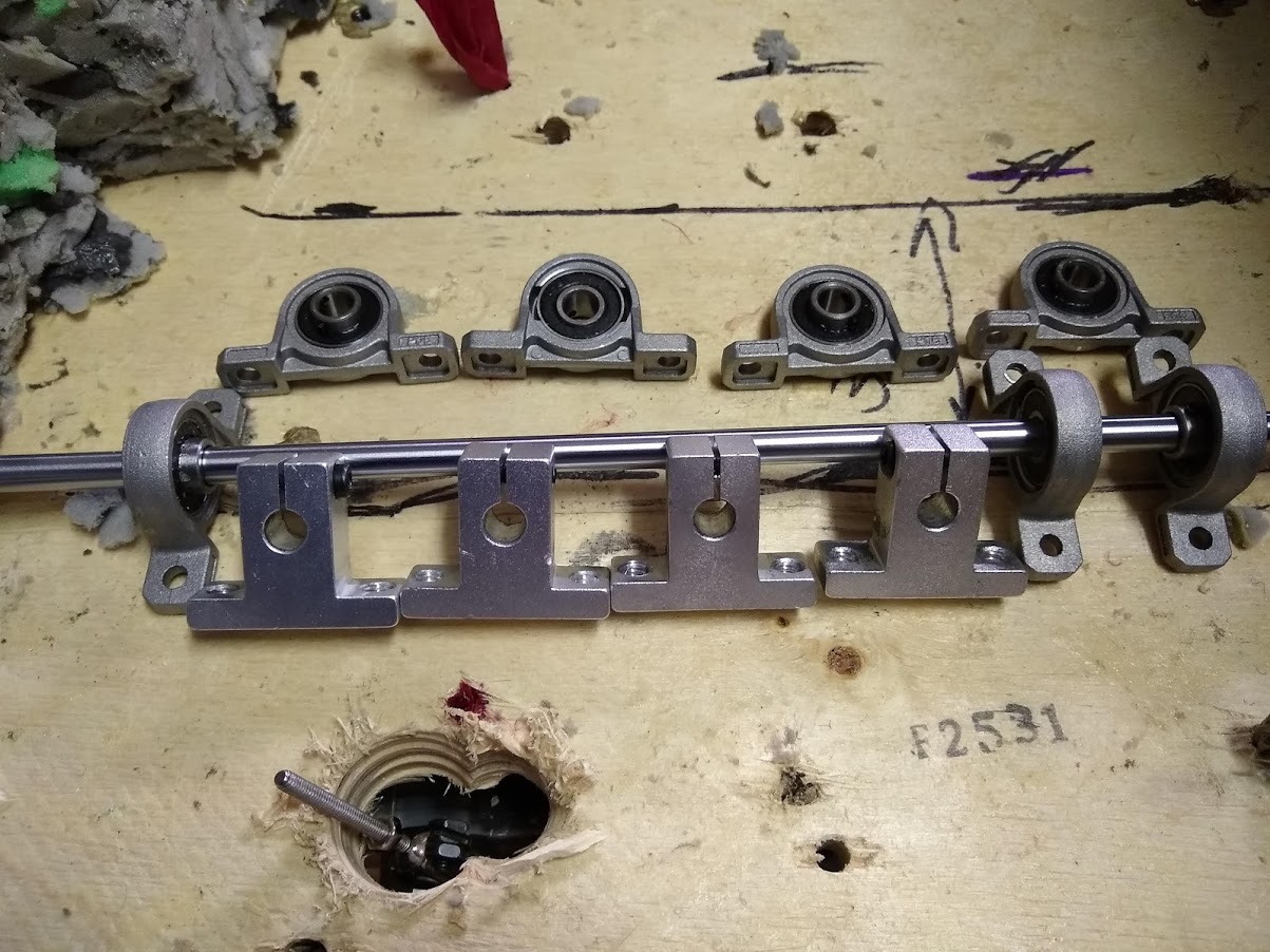

    I have been playing around with a different paddle mounting system. Instead of the typical pin hinge I thought I would try ball bearings and 8mm rods.
    It might be too difficult to get everything aligned especially with the wooden based seat.
    here is a picture of the 8mm 3d printer rod bearing parts I am going bearings4.jpg to try..

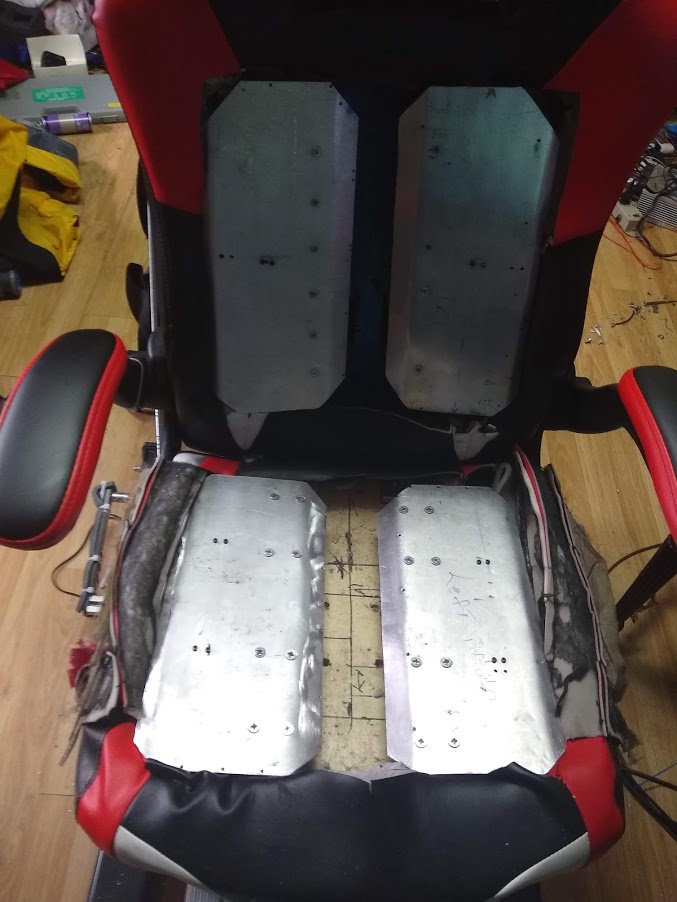

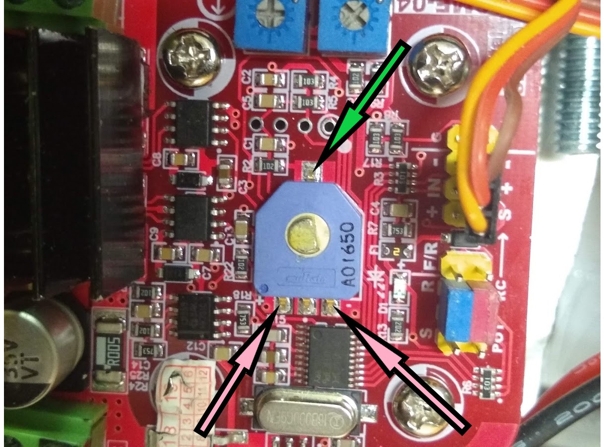

    happy to report the G seat is done...
    And it works.

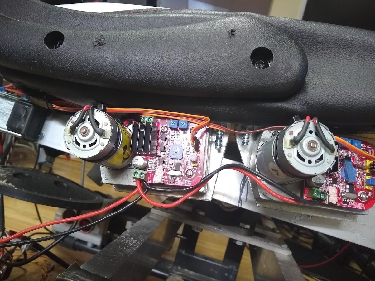

    I am using 2 of the 260kgcm servos per side on the heave paddles
    I did try using just one and it actually worked fine.
    Adding the second one just reduces the strain on the servos.
    When paralleling the servos it is important that they have the same throw and centerpoint. I was able to use a trim resistor to accomplish this.
    I soldered a small 50k ohm pot between the spot the green arrow is pointing to and then one side or the other where the pink arrows point.
    With this extra trim pot I was able to match both servos exactly.
    The doubled up heave servos have no problem pushing my 114+kg with authority.

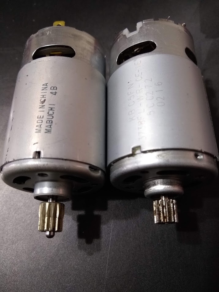

    Update:

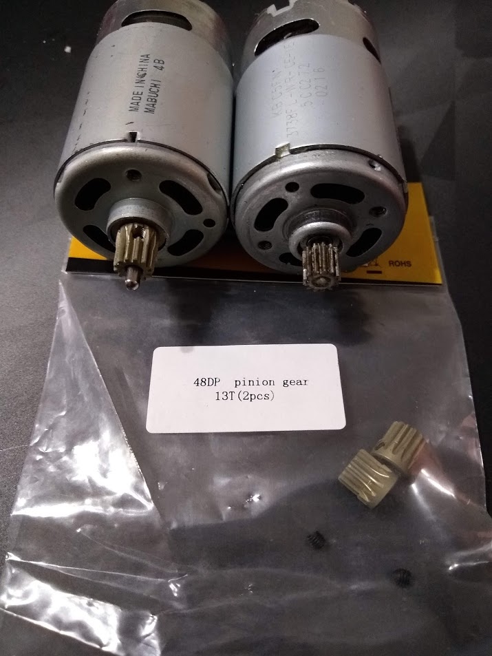

    The Gseat was performing well ..... Until I burned out a motor. :oops:
    Maybe I learned something from this minor disaster... I had one of the slower Servos that is rated @.5sec/60deg. And it appears to use the exact same RS555 brushed motor. So I swapped it out and the Gseat is running again..
    I did run some tests to try and figure out exactly what motor they use.
    The only thing I could really test was RPM/Volt.
    So this is what I measured.
    12vdc no load is 4900 rpm.
    18vdc no load is 7260 rpm.
    24vdc no load is 9600rpm.
    The rs 555 motor is a 5 pole design which gives it greater torque than the same sized RS550 motors.
    From what I can tell the motor is a Mabuchi RS-555ph-3255 Which is size 32wire with 55turns.
    The problem is finding this motor with a solid shaft and not cut with a flat.
    The original motor also has a pressed on pinion.
    13 teeth...
    The windings on the defective motor looked fine. As a matter of fact I completely unwound it and there was no discolored wire.
    I am guessing it was a wire attachment to the commutator that broke.
    The motor failed as I was enjoying an intense few laps at the Daytona Speedway oval.
    The motor that failed was the right side heave sway .
    So It was working really hard in the nearly constant left turn.
    The second servo on the right heave/sway side was not even warm.
    I am assuming there were some problems in my mechanical adjustment/pushrod geometry...
    A minor glitch that was easy to solve (because I had a spare motor)....

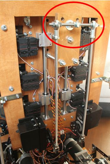

  7. MarkusB
    Jun 30, 2015
    552
    4,214Coins
    +597 / 2 / -0
    When reading your post, I also immediately thought of adjustment problems.
    When multiple servos are used in parallel with a rigid connection, there is always the risk that they are working against each other. Even with an accurate adjustment it can be that manufacturing differences between the servos lead to minor movement deviations.
    I used two servos for moving my seat backrest up and down, and the picture below shows how I mounted the rods in a way that movement deviations are compensated.
  8. T R Para
    T R Para i make stuff up
    Oct 18, 2018
    385
    Cincinnati, Oh
    2,441Coins
    +357 / 2 / -0
    AC motor, 6DOF
    Yes it is a problem I am going to have to take care of. It is complicated by the fact that the aluminum paddle is so long (front to back). There is lot of flex in 3mm aluminum plate.
    I found a new picture of the real Gs-4 seat and the heave paddles are much shorter than the surge. Mine are the same length about 350mm from the front to the back of the chair.
    I believe another problem is the pushrod attachment points are spaced about 150mm apart. There maybe a lot more body weight on the front attachment point than the rear.
    If I reverse the output position on one of the servos I can move the attachment point much closer together. But that would take several hours of work.
    Right now I am going to try and preload the rear servo a bit more than the front and hope it even things out.

    I see how your pushrod arrangement can compensate for any unevenness.
    Thanks for posting.
