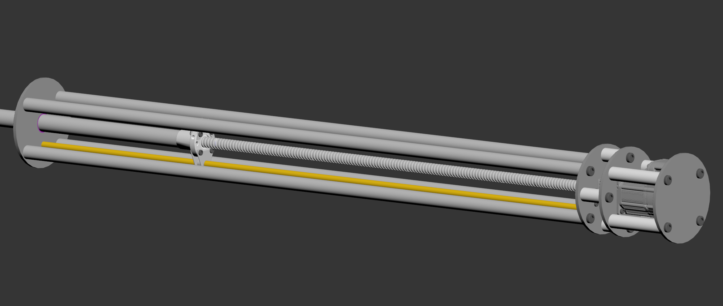

    I was wondering what motor is best for use with a linear actuator? im thinking about DIY actuator made of carbon and steel/metal with 800mm length of travel. Carbon fiber actuator like what @SeatTime did
    My budget is maxiumum 4000 but i want to try to stick bellow 3500 USD.
    Should i go the Brushless motor, DC or AC route?
    The frame of the motion platform will either be in carbon fiber or lightweight metal/alloy.
    Best regards
    Here is a animation of the actuator and the idea i have with anti rolling for the ball screw
    https://i.gyazo.com/9589cb0cac559baf64b7988386df88dc.mp4
    and a picture of it.

    I haven't built any actuators yet so take this with a grain of salt. I would reassess that very small diameter looking yellow rod that you're using to hold the ball nut from twisting. Any flex on that rod and you loose fidelity. I know ball screws are very efficient so there won't be a huge moment from them but it looks like that rod would be able to deflect pretty easy...
    Food for thought.

    What other considerations do i need to take care of in linear actuator? like limit switches? do they cut the power to the motor? how do they work? Do i need any potometers?
    @cfischer I was thinking about the bending effect soo i taught about maybe using steel and have the 2 steel rods to keep the bending effect to a minimum (at 0% if possible)
    Have anyone experienced with that method of using steel cyliders for anti-rotation/anti-twisting

    What material are you going to use for the 4 main rods you're using? Why not use them all as anti-rotation. At least one.

    Carbon fiber will be the 4 main rods, and there will be a big carbon fiber tube that will cover everything execpt for the motor. The 4 main rods are for structure integrity
    Good idea :) I will get back to the drawning board and see what solution i can come up with.

    Another question: Should i increase the diameter of the ballscrew? since its soo thin? just thinking soo i dont break anything and it colapses. The weight of the whole rig will be bellow 120kg i belive

    No not if it's all put together properly, each axis supports each other they are solid once all connected up to the platform and base
