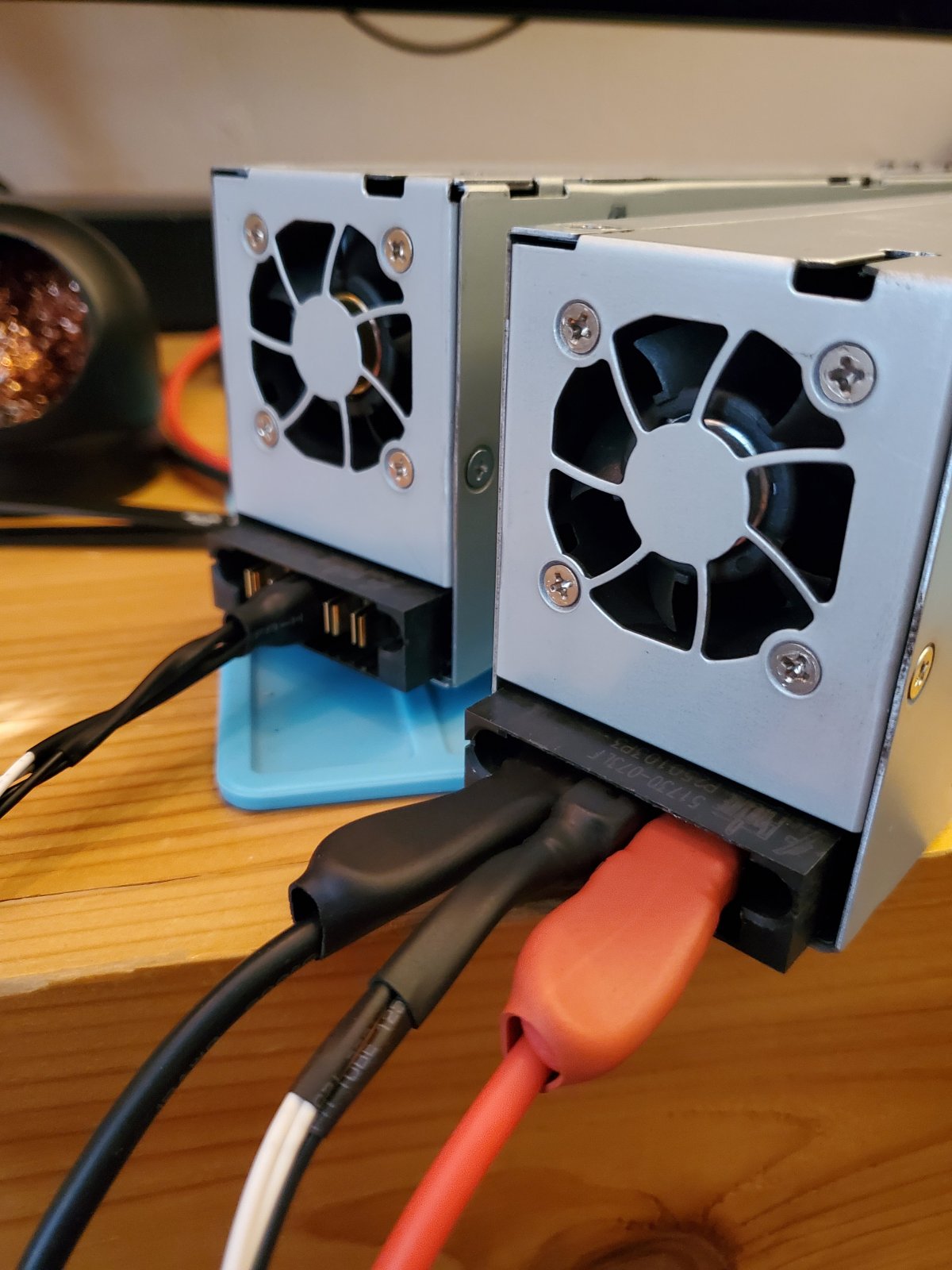

    Power supplies - (3) HP DPS-600PB these were modified like the tutorial found in the forum

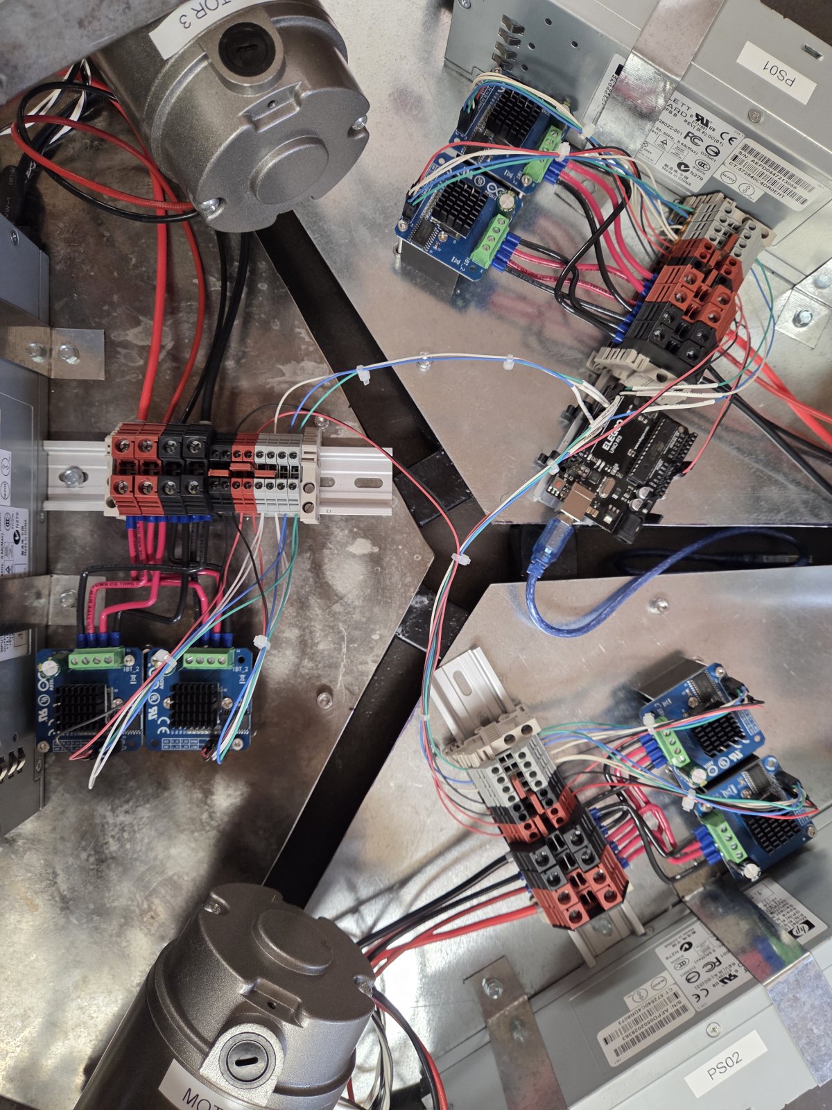

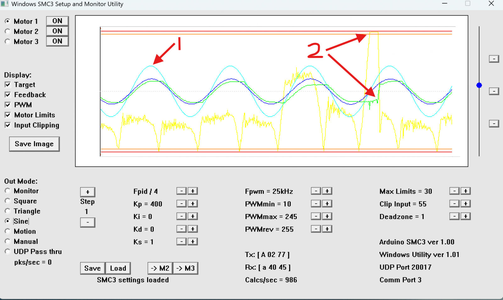

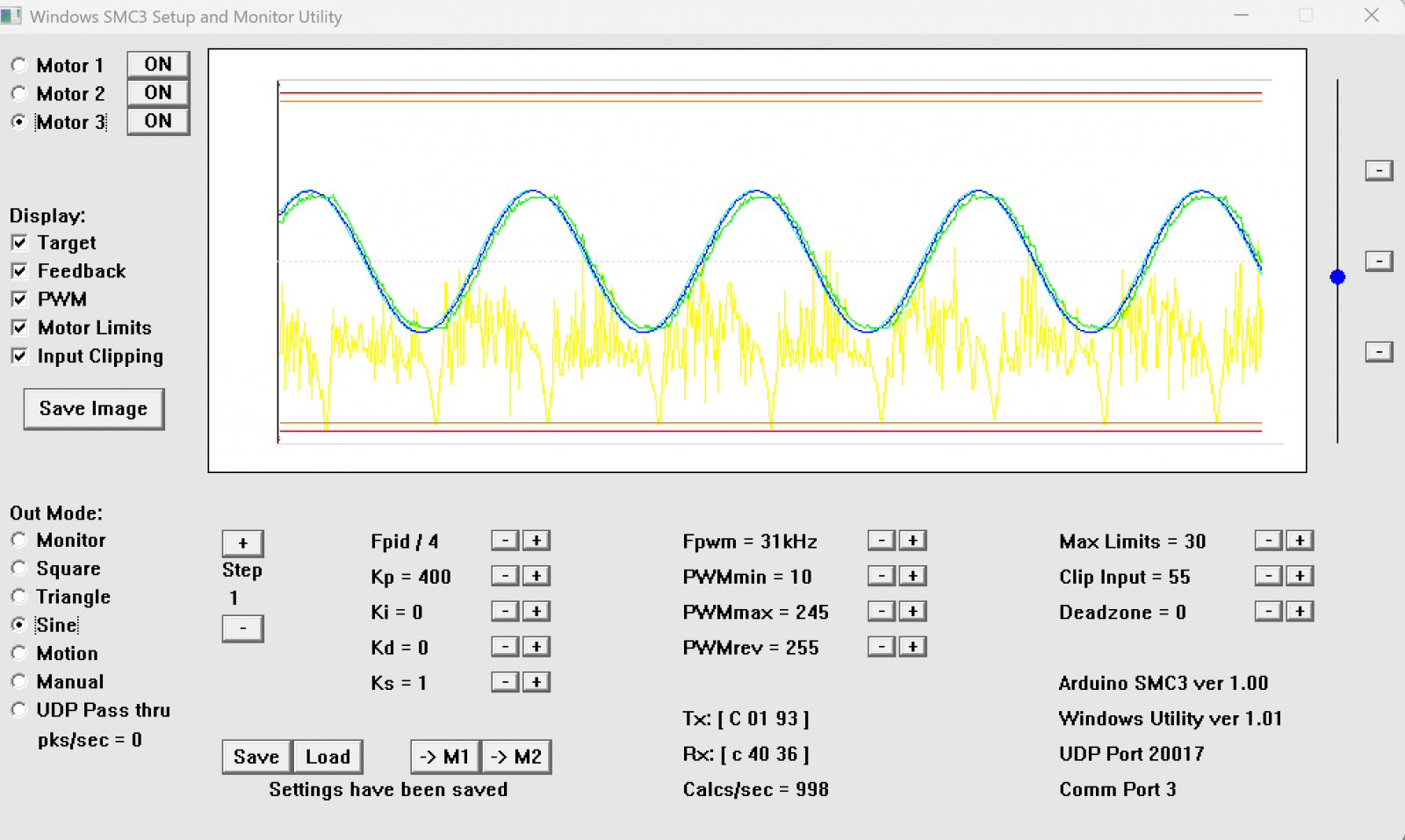

    • SMC3 downloaded to Arduino.

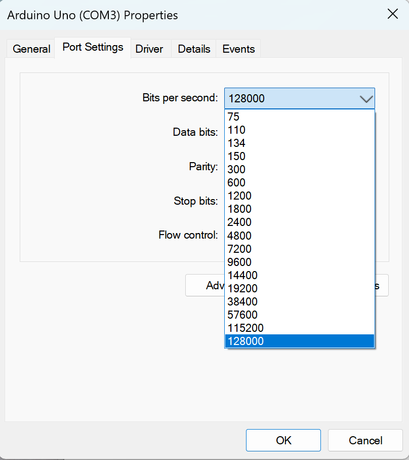

    • SMC3 Utilities v1.01 downloaded and port configured.

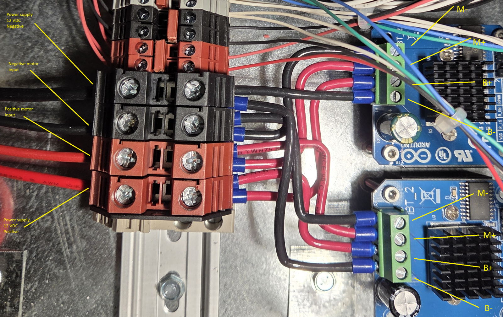

    • Wired up two IBT-2 motor drivers in parallel (the drivers run much much cooler in this configuration).
    • Tuned the motor via the SMC3 utilities and things seem to be running smoothly (well after I increased the FPWM to reduce the noise from these motors). However, I feel like there isn't much movement but perhaps I am expecting too much at this point in the project.

    Looks good, keep us posted on the progress !
    in my project, I tried with similar direct coupling of hall sensors first, but then changed to using gears. The increased detail of position measurement reduced jerkiness in the movement and motor noise as well.

    I went with 50:20, same as recommended in Momolic's guide. That gives full 360 degrees sensor rotation when motor turns 144 degrees (72 degrees up/down). I'm then limiting the motor travel to something like 120-130 degrees with SMC3 to prevent going out of sensor bounds.

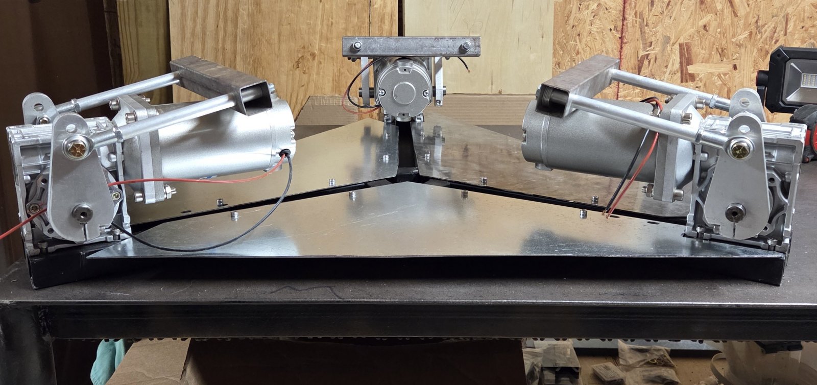

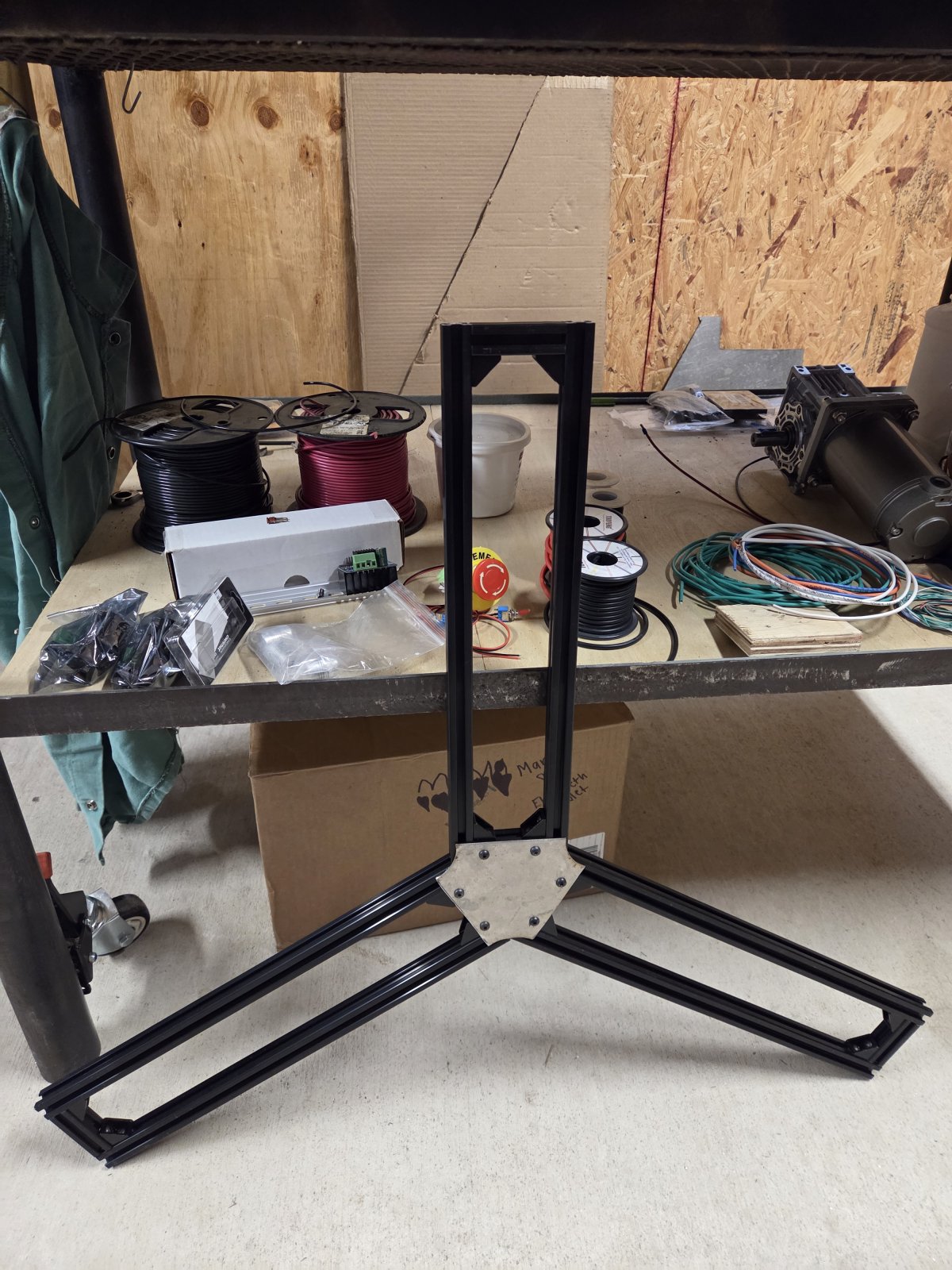

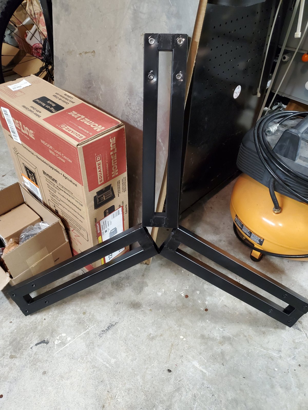

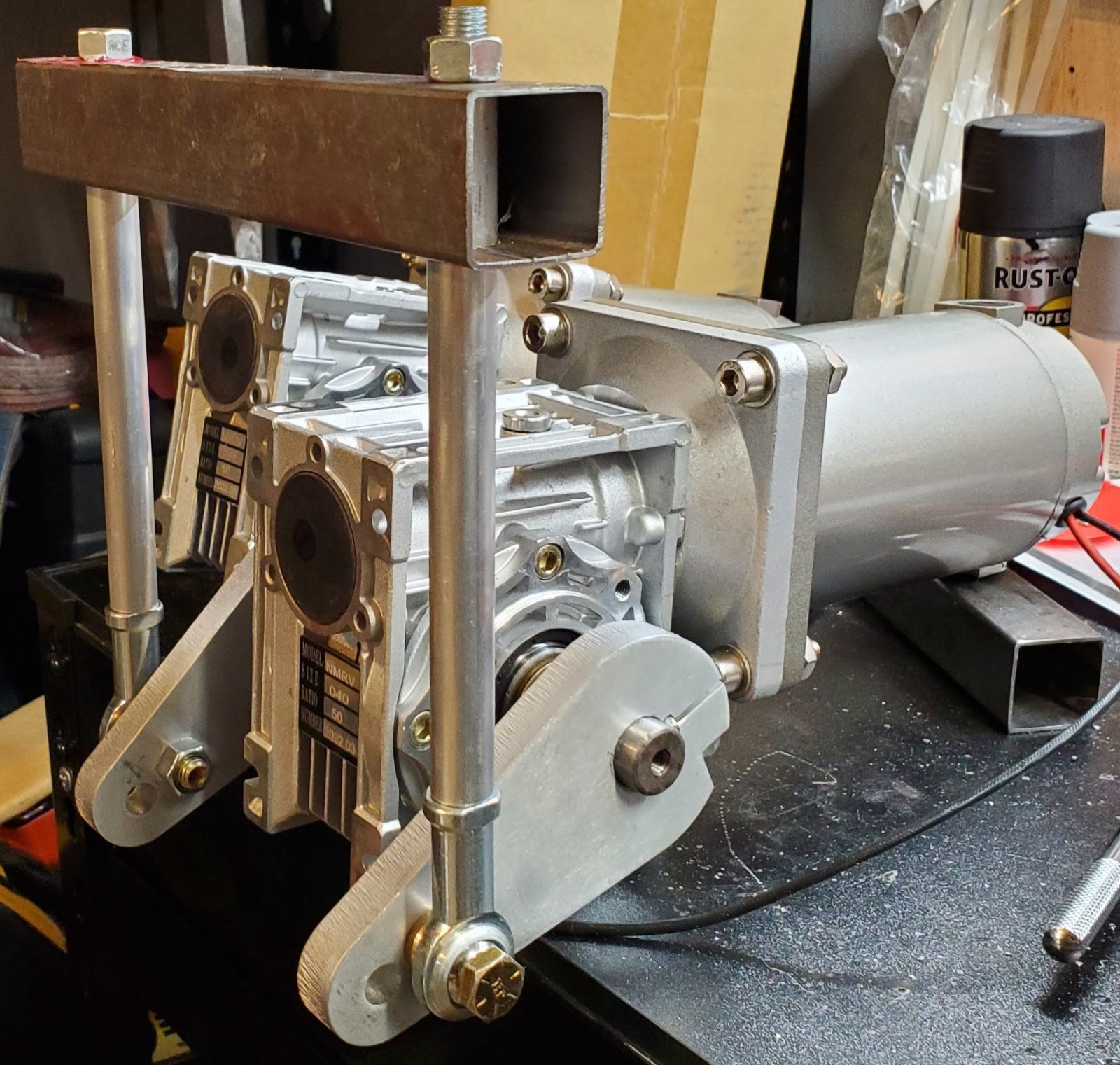

    Small update (even though it has been months :():
    One major hurdle I had to get over was my old computer was so outdated that my Fusion 360 account no longer worked a few months ago and I had to wait to save up and then build my own PC. This has subsequently also improved other aspects of working thankfully.

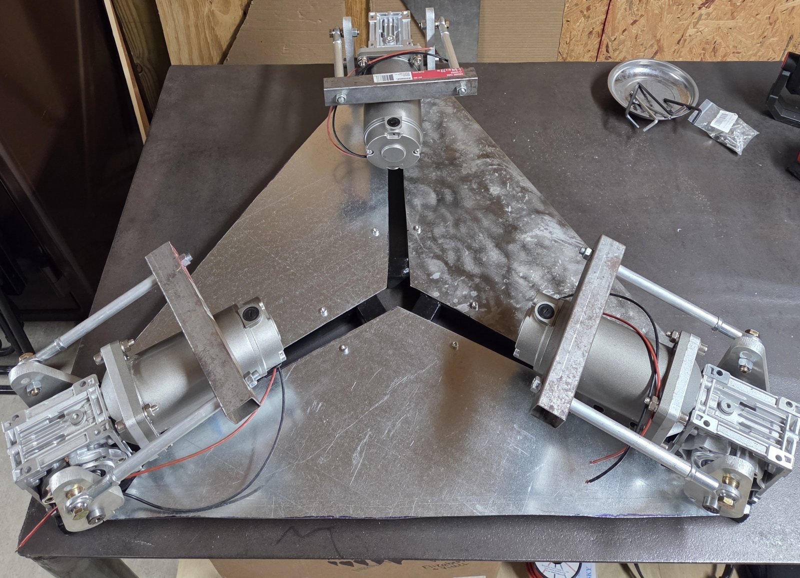

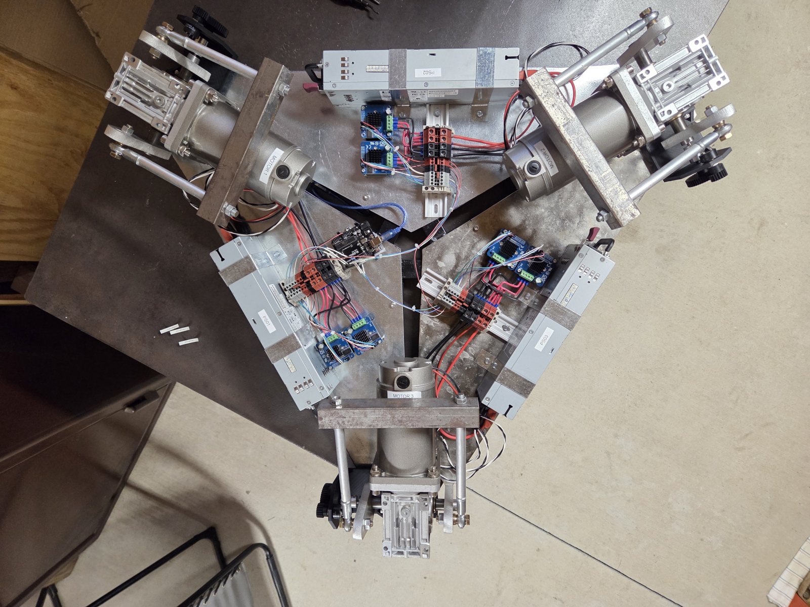

    I finally got the base together in order to mount the motors, however, it still isn't in its final stage. I have a steel sheet I will cut and weld to it in order to make space to mount all the controls and power supply's.
    I have designed the control arms that attached to the keyed shaft and have sent them off to be cut by water jet (should receive them this week). I tried different methods to do it myself, but I could ever get accurate results with the tools I have. I designed two attachment points for the lift arms at 70 mm and 85 mm for future preference on movement speed.
    The lift arms that attach to the control arms are also complete. I still need to drill out the seat supports that they will attach to and control. That will be a relatively quick step to do though.

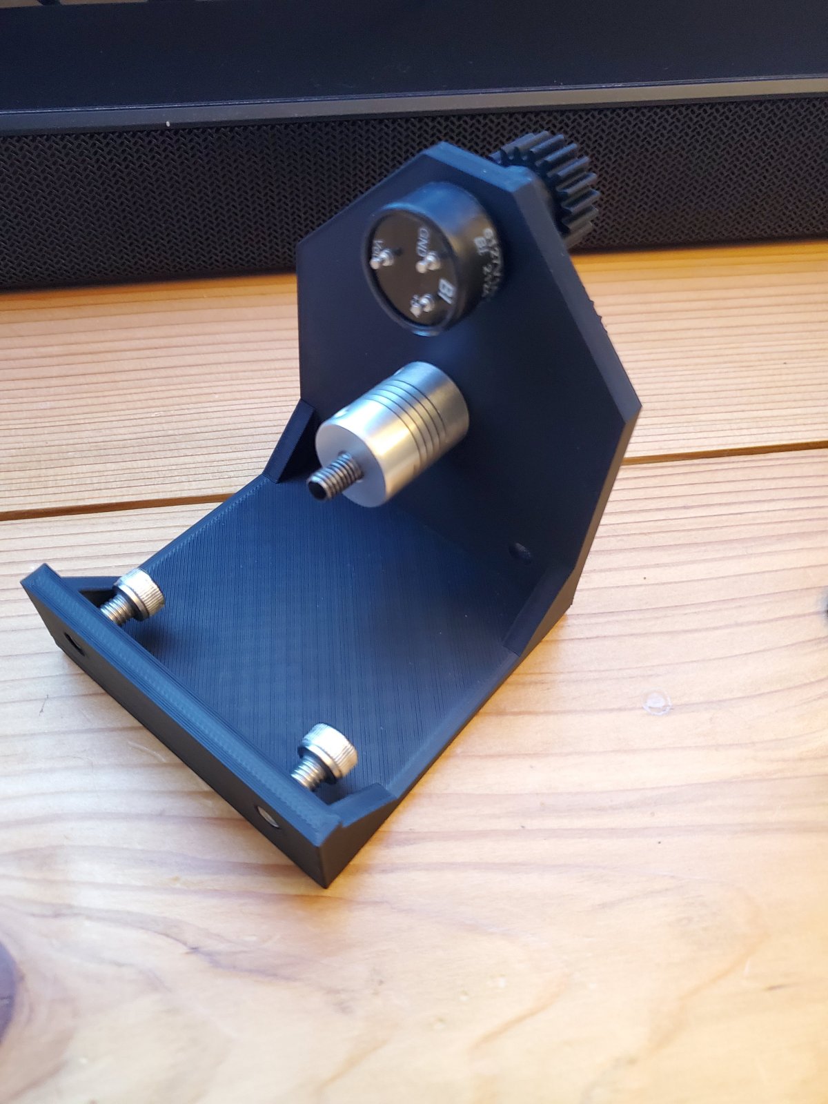

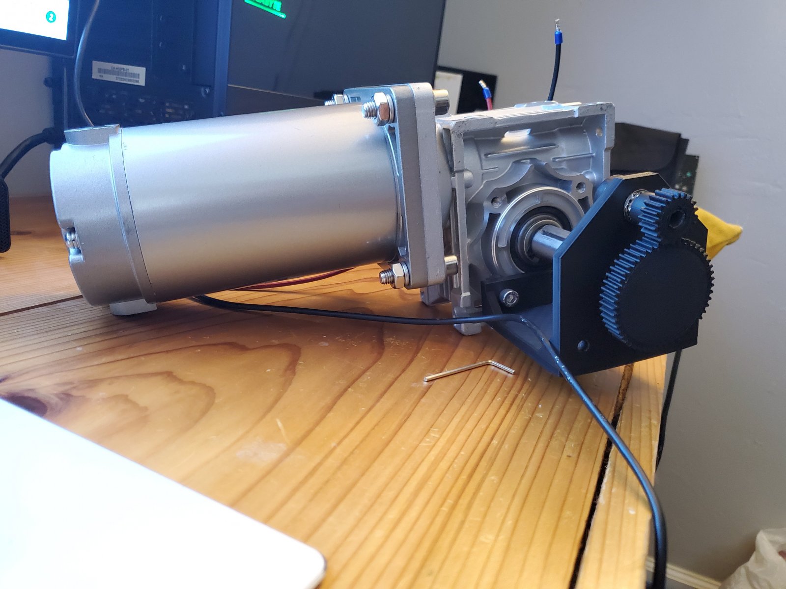

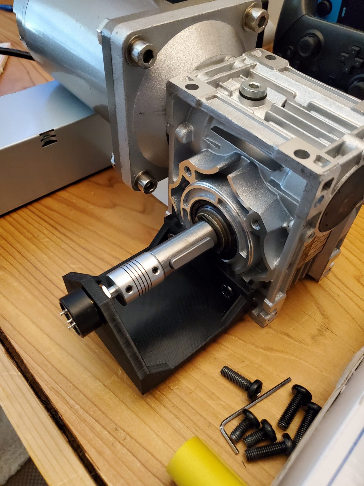

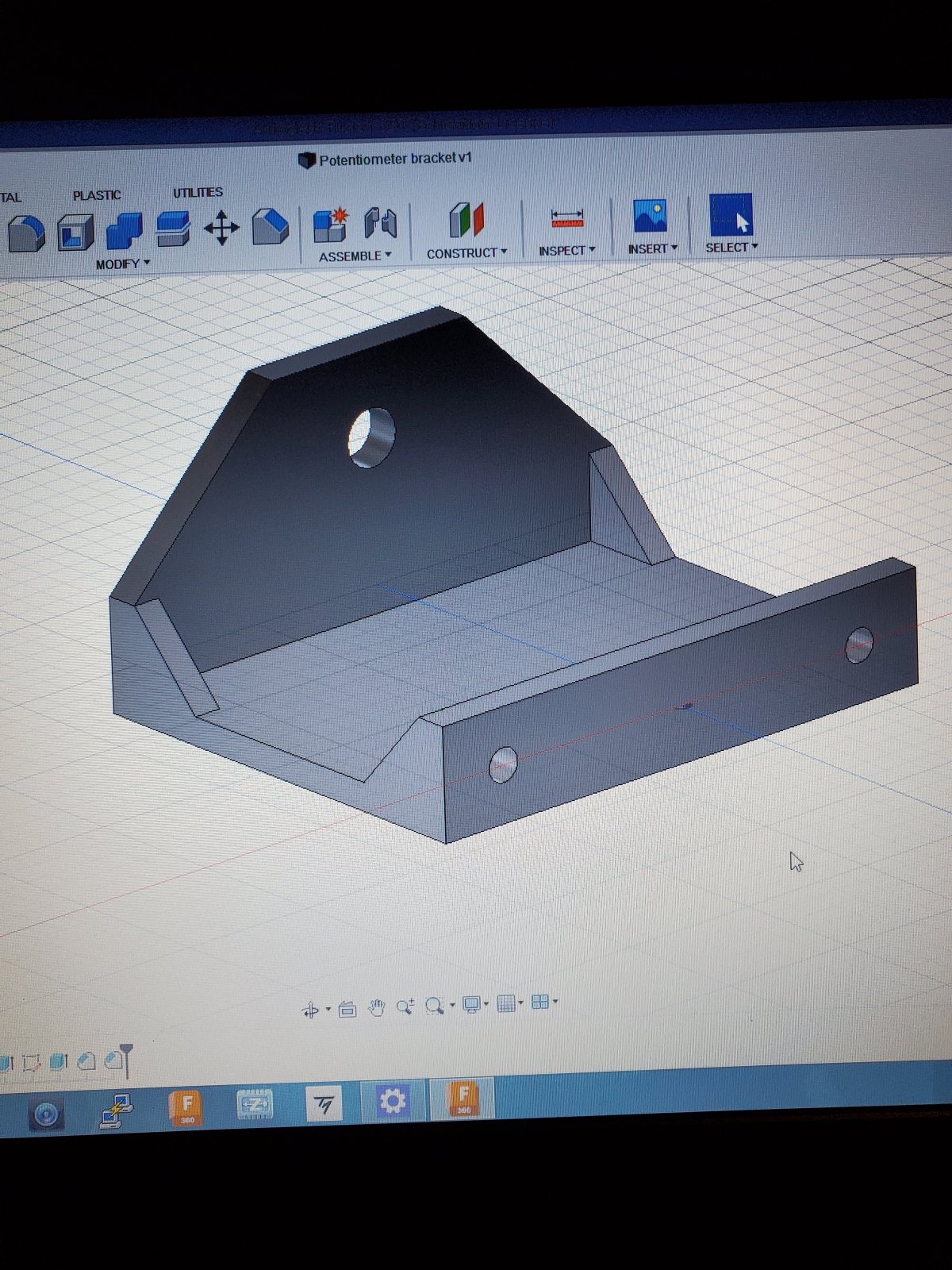

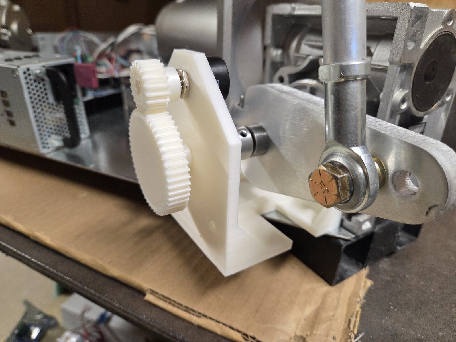

    Lastly, I have redesigned my potentiometer bracket to incorporate a gear reduction such that it can utilize most of the range of the potentiometer during the limited rotational movement of the motor shaft.
    Once I get the motor control arms in, I can assemble what I have done and do a little bit of testing before I start building the seat.

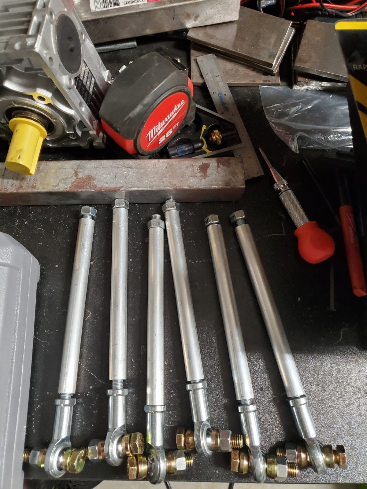

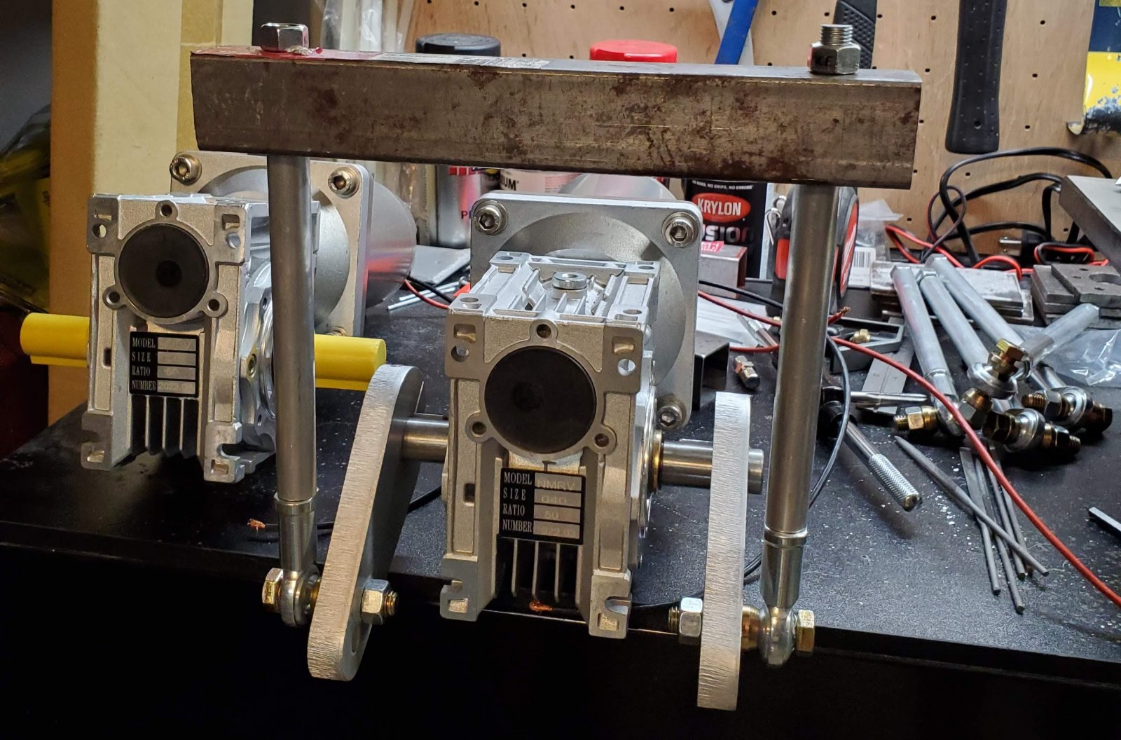

    Small update:
    Received the water jet cut control arms. Turned out pretty good but the tolerances were a little tight for the keyed shaft which left me with some minor filing. However, when two were installed on the motor I noticed that the keys on the shaft were offset slightly by a few degrees. This meant that the rods on the lift arms (that I precut to the same lengths) would be at different heights at any given point during the motor's rotation. To correct this, I used a level and added some washers inside of the seat frame support so that it wouldn't be cockeyed. The seat frame support really wouldn't care even if I had left it unlevel as it will incorporate a heim (rose) joint at the top of it anyhow, but it bothered me so...
    Not much of an update but I do as much as I can when I get a little bit of free time. Once I get a replacement drill bit (broke when drilling out the hole that provides the clamping to the shaft), I can finish the control arms and then move on to the rest of the frame and seat. I also need to add my 3D printed support for the potentiometer to test and make sure there's enough clearance during the desired rotation. I thinking I'll be cutting that close though.
