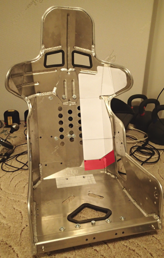

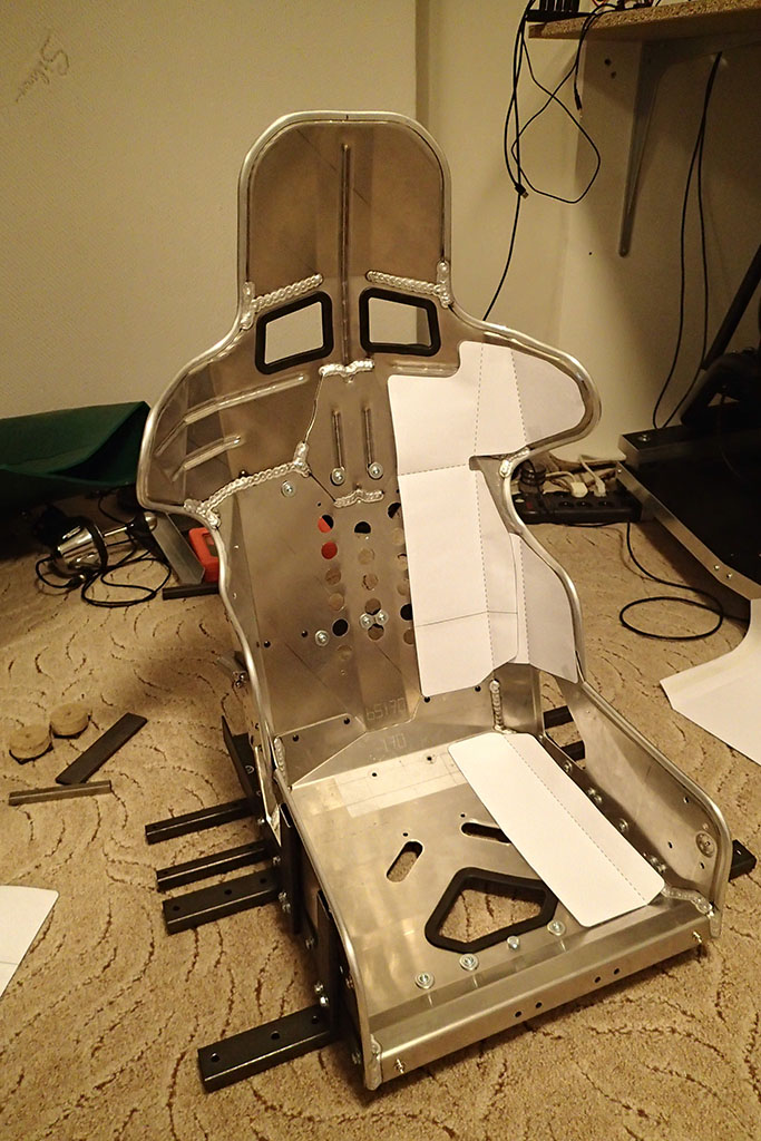

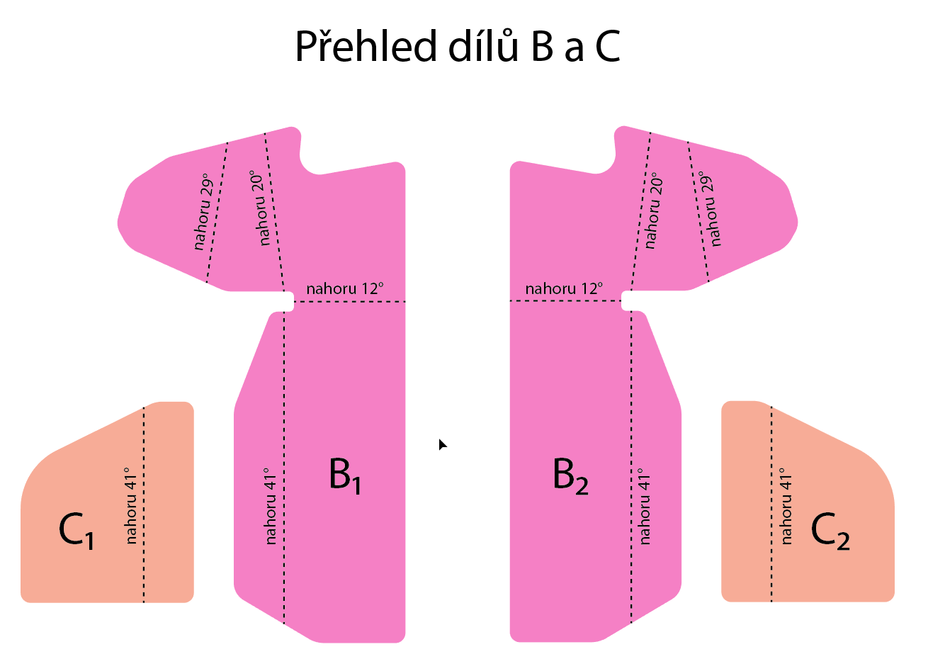

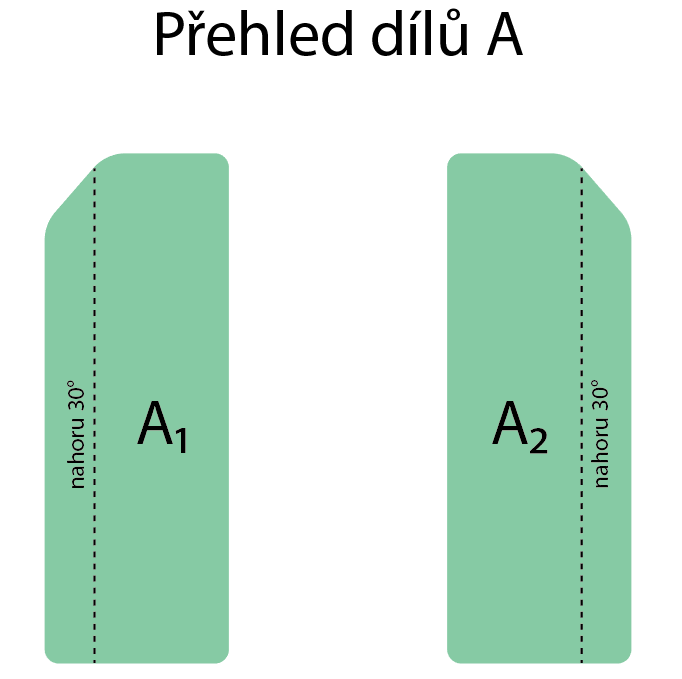

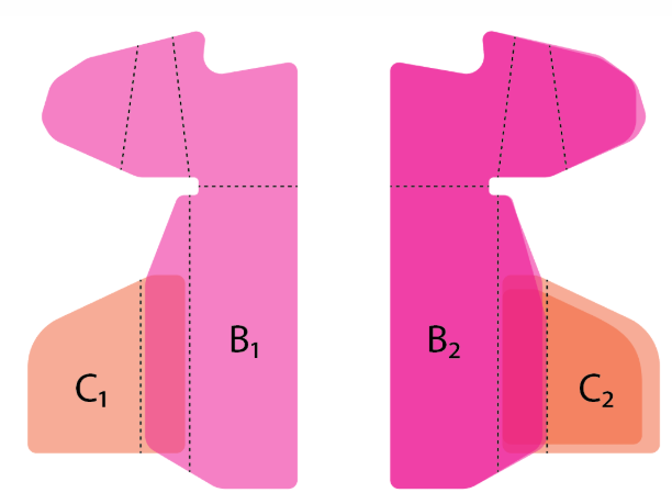

    I have done little bit of tweaking to the shape and I also corrected lines along which paddles will be bent:
    On the right side, there is overlay before / after. With side paddles I can push the size very close to the limits, as I can move it as necessary. On the main paddles, I'm leaving some margin for error.
    I would have question for current G-Seat users.
    Should I extend the back paddle more down to the butt? All g-seat projects I have seen has paddles above the butt it seems. Does it have a reason and should I do the same or it could beneficial to have the paddles all the way down.
    Only reason I figured, it could be because the butt wouldn't move, and it would overstress the servos and limited the felt effect, any ideas?
    Thanks.

    Hi Michal, I tried lowering the back panels temporarily on my DIY Gseat and found the effect underwhelming. I also think it increased the load on the servos. For both reasons, I raised them back up to a normal position.

    Thanks, I will leave it as it is then :) If it would give me trouble even like this, I can always cut more from the bottom myself.
    I have finalized data and sent query for manufacturing. I hope I measured everything correctly, I triple checked :)
    I asked for 4 mm aluminium material in order to be sturdy enough to handle the tactile without resonance. Maybe 3 mm would be enough, but I'd rather be careful here.

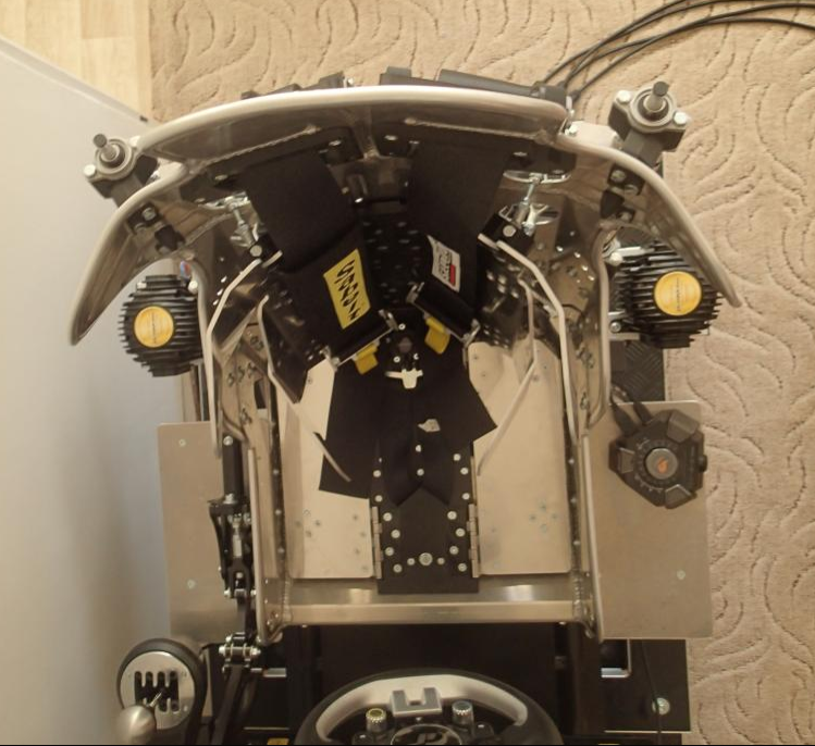

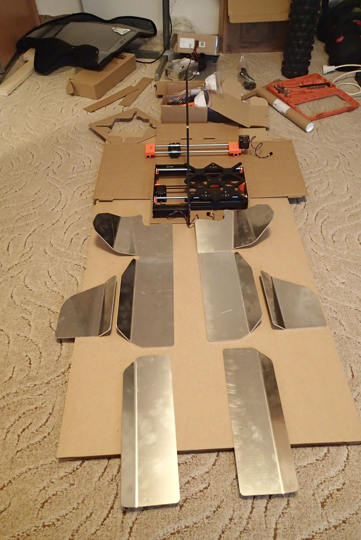

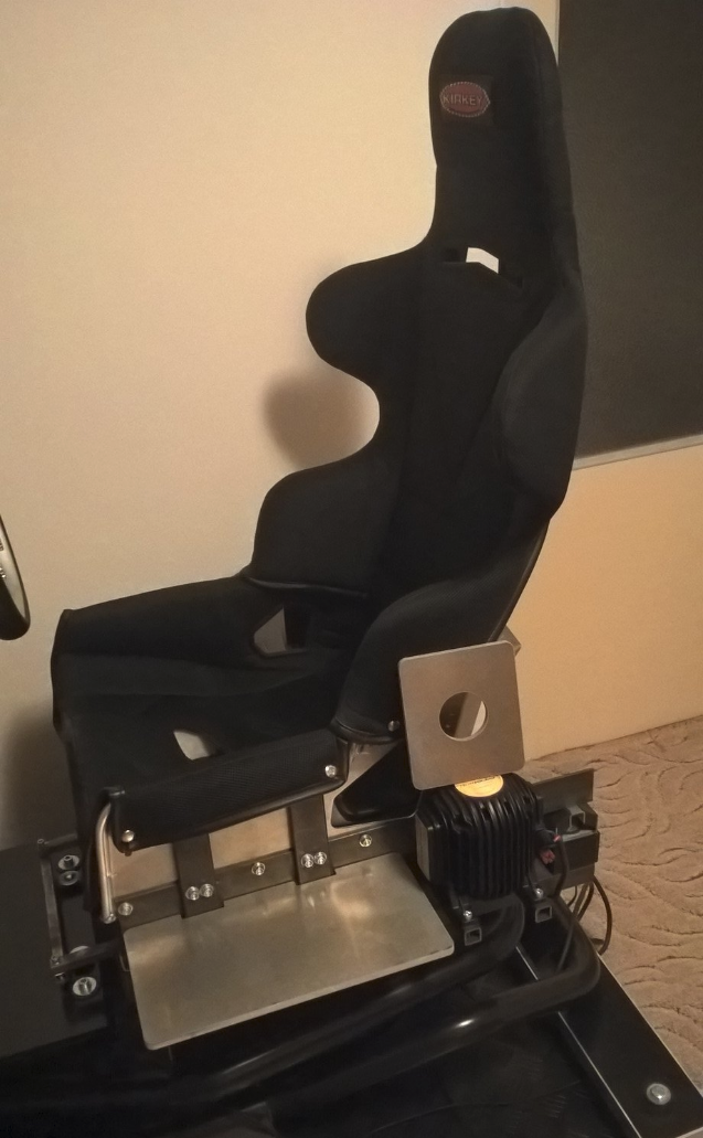

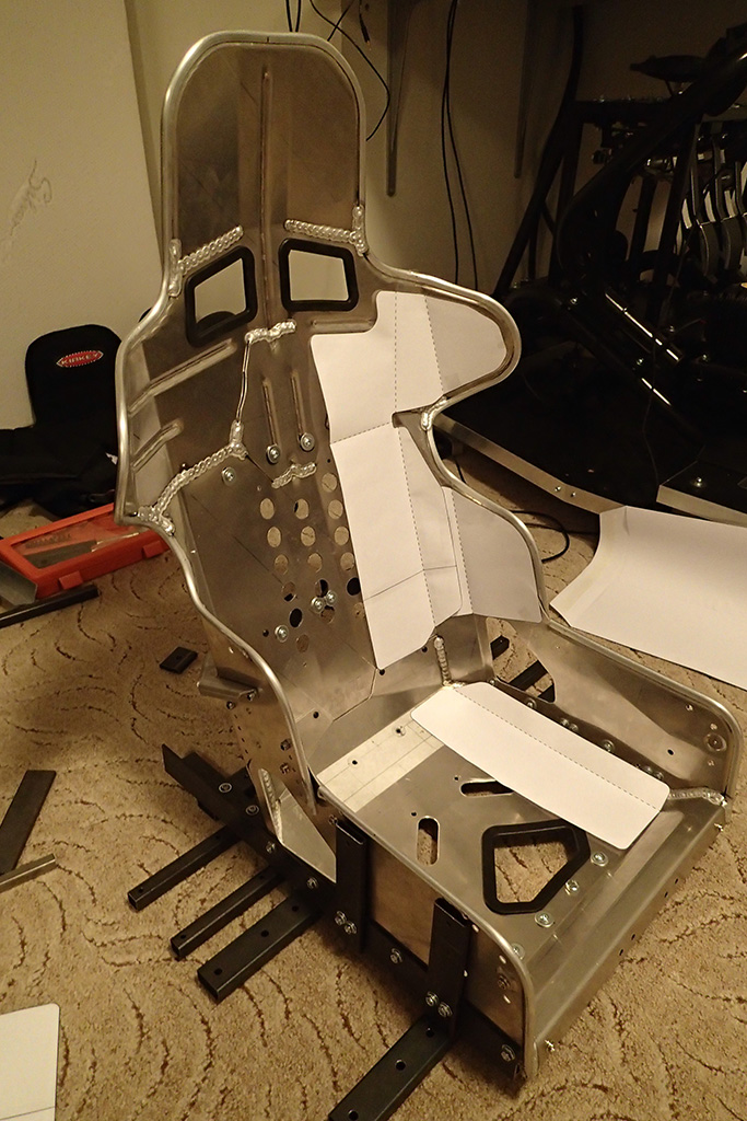

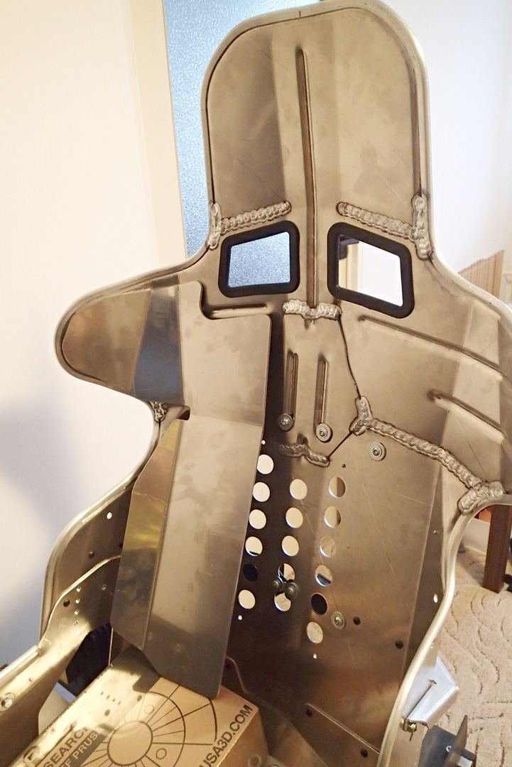

    So the paddles are here!
    Now I need to finish the 3D printer and learn with it to be able to attach them to the seat.
    I also got aluminium plates for peripherals. I probably should have gone for some irregular shape to make it look cooler and not so boxy though :) It's 8 mm aluminium. It will be easy to do flush mount attachment so it won't interfere with anything.
