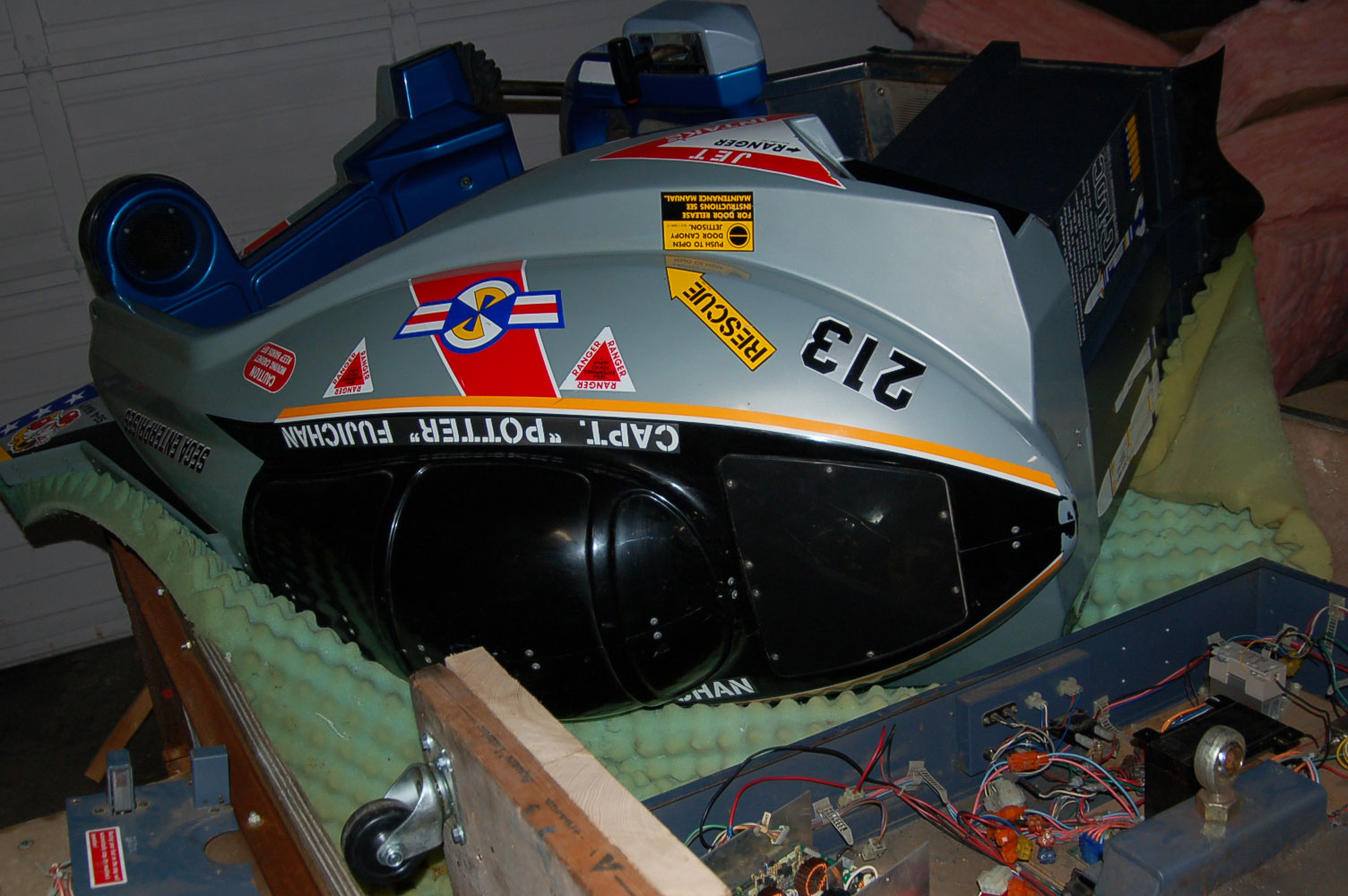

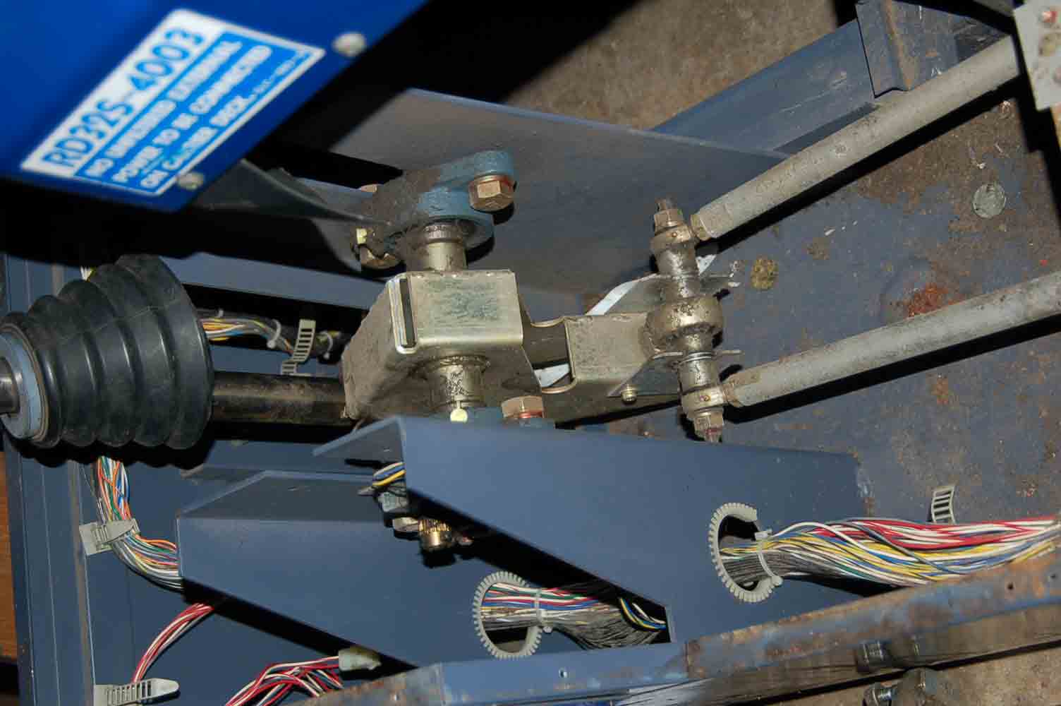

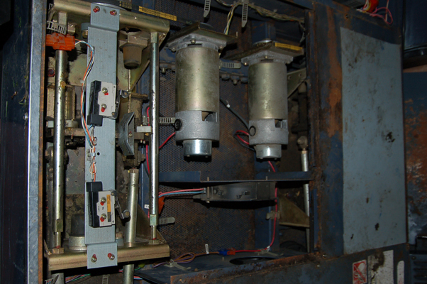

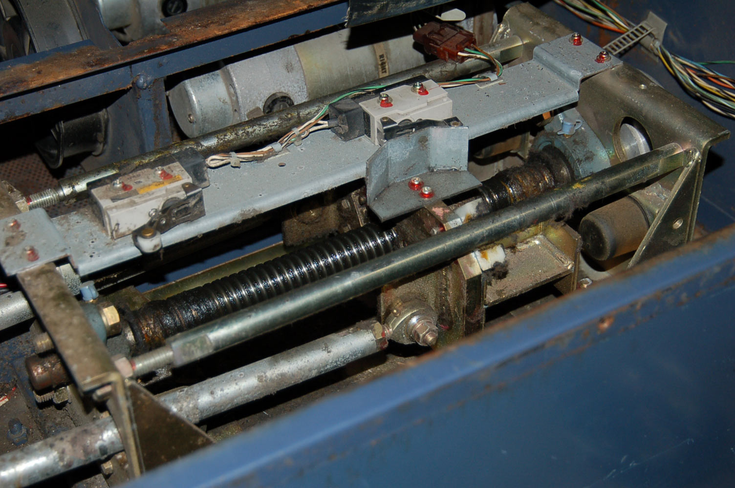

    I'm new to this community and looking for some help and ideas on my flight sim project. I'm converting a Sega G-Loc sit down arcade machine to a motion flight simulator that can run Falcon or Microsofts Flight Sim. The machine is currently setup with two large servo motors for the motion. The front of the machine has a swivel eye and the back is connected by two vertical rods. If the rods move together the machine changes pitch if both work oposite roll is produced. I have been told the motors are 90 VDC motors. I'm looking for some ideas on what to use for motor drives for these large motors. I'm also looking for ideas on LCD monitors. If you know of any sources for nice 18 or 19open frame LCD monitors that would be helpful. If you have any suggestions or ideas I would appreciate it.
    I finally figured out how to shrink down some photos to post. I need to do lots of cleaning on the machine and remove all the old electronics.

    My DIY dual simple mosfet h-bridge can handle voltages up to 50volt! So I believe you can use it to drive your motors as long proper cooling is applied to the mosfets and the current that the motors draw isn't too high (above 30amp for each motor).
    But I think I might design another one just for you that can handle 60amp by using parallel placed mosfets...!
    First check your motors to see how they perform on 12 and 24 volt and if this is not enouph you can try 48volt (four car batteries in series). Driving them in lower voltage will not harm them... In worst case they will not have torque...

    Edit: As the gearboxes are connected via pulleys and belts to the motors, the motors should be replacable without bigger issues. They could be replaced easily with some with less voltage requirement.
    Just in case you wont be able to find a proper driver.
