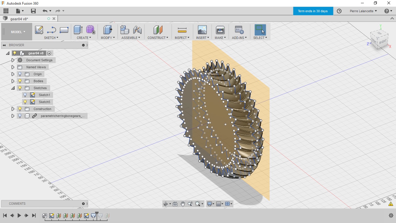

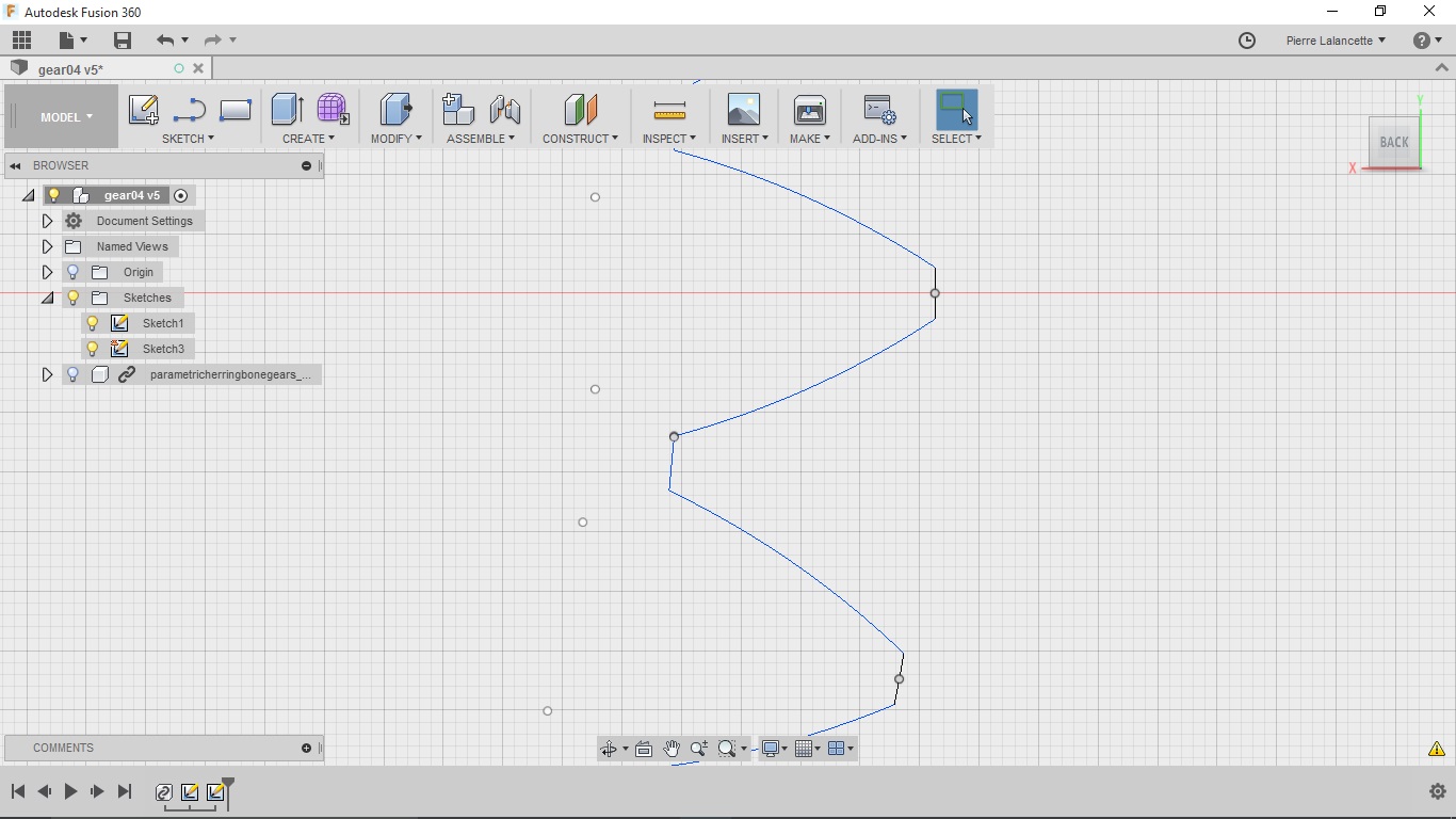

    Ok Fusion 360 Gurus, when it comes to CAD drawing, film 3D experience is worth nothing.
    How do I get to make the gear tooth to be in a V shape. I tried to select center vertex, can`t do. Try to move the 2 sides faces, it refuses. Try to switch to immediate mode, does nothing. Arg! This is so frustrating!

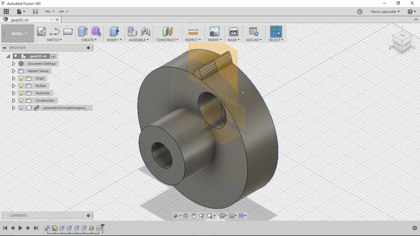

    @Pierre Lalancette - Well, I have a way to do it, but not sure how good of a gear profile you get. Probably OK but you can see.
    What I did was draw a circle for the gear body and a tooth using the sketch palette. I then did a circular copy of the tooth to make teeth but made twice as many teeth as I wanted. This was to get a profile that was each side of the gear even though it was just one side. Depending on the angle of the V that you want and the thickness of the gear, you may want more. This is still in flatland - just the outlines. I then created an offset plane up from the circle with teeth that was the thickness of half of the gear and did it again. Then I did a loft command and picked a single tooth profile on the bottom and a single tooth profile on the top that I wanted to loft into each other. I think you can also loft along a path if you want curved V sides instead of straight like I did here. That gives you a single tooth at an angle and all the other stuff you drew goes away. I then went back and did a circular copy of that one tooth around the axis to get one half of the gear but it's still just the teeth. Drew another circle to recreate the gear body and extruded it up through the gear teeth to create a single gear. To get the V-shaped teeth, I mirrored the gear across one of the faces. You probably want to join the two bodies but I was just seeing if I could do it. I then went back and made the hub hole, hub, and the other hole just using regular commands.
    Not sure if that's the best way - probably not. But it is maybe a way? :thumbs

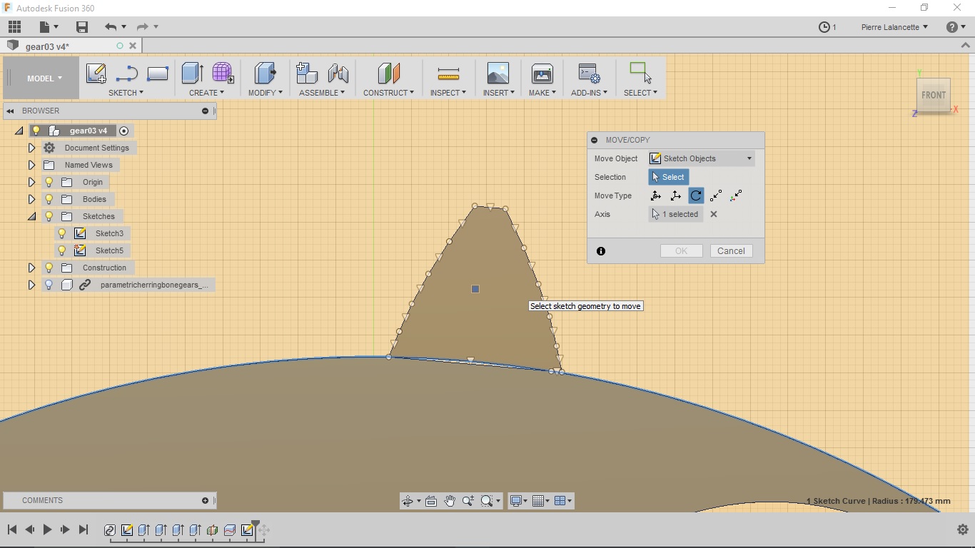

    I'm sure they are doing it on purpose. How can we make a software that wont be natural, totally not intuitive and will frustrate the user. Welcome to Fusion 360.
    I have a sketch selected, I want to make a copy of it. Press M, the move/COPY tool, but guess what? The COPY part of the tool is not there at all. I mean, it is too much to ask for a copy. Is it too hard for a computer to take faces/vertices/edges and to provide a COPY? This is not what computer are here for, doing repetitive task?
    Ok, maybe my sketch is not divided into parts that I can duplicate. I do another sketch, only for the gear's tooth. I was hoping to snap on my actual sketch as a reference. Noooooo, snap is only for the grid, other points are not relevant. Still, I do it. M again for the MOVE/copy tool. Now what? I cannot select my sketch, no mater where I click. AAAAAARGGGG!!!!

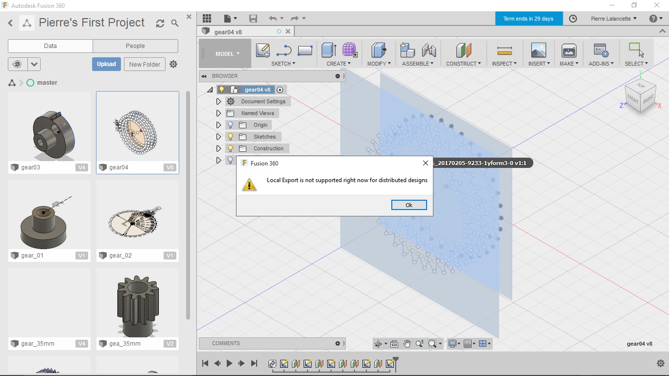

  10. Pierre Lalancette
    Dec 11, 2016
    1,006
    Tech Artist
    Quebec, Canada
    8,035Coins
    +945 / 6 / -0
    3DOF, DC motor, Arduino, 6DOF
    Like the picture I put here: Fusion 360 question(s)
    I was not able to repeat my simple gear sketch. When I redid it over, I could not move it. But it's probably my lack of knowledge.
    Making a gear is not the real problem for me, @Jerry Atrick , it is more the V shaped tooth that cause me trouble. I already printed a gear from a catalog as a test. Again, my lack of knowledge and my desire to go too fast is probably the cause of my trouble.

    Disable your Bodies, Work with the sketch only,..make sure you highlight All of the sketch lines your wanting..... I copy sketches all the time from one file to the next when needed....your missing something easy for sure. As i said before, give it some time and you'll love it....being freeware its not like your out much as other's have said. Keep at it bud.

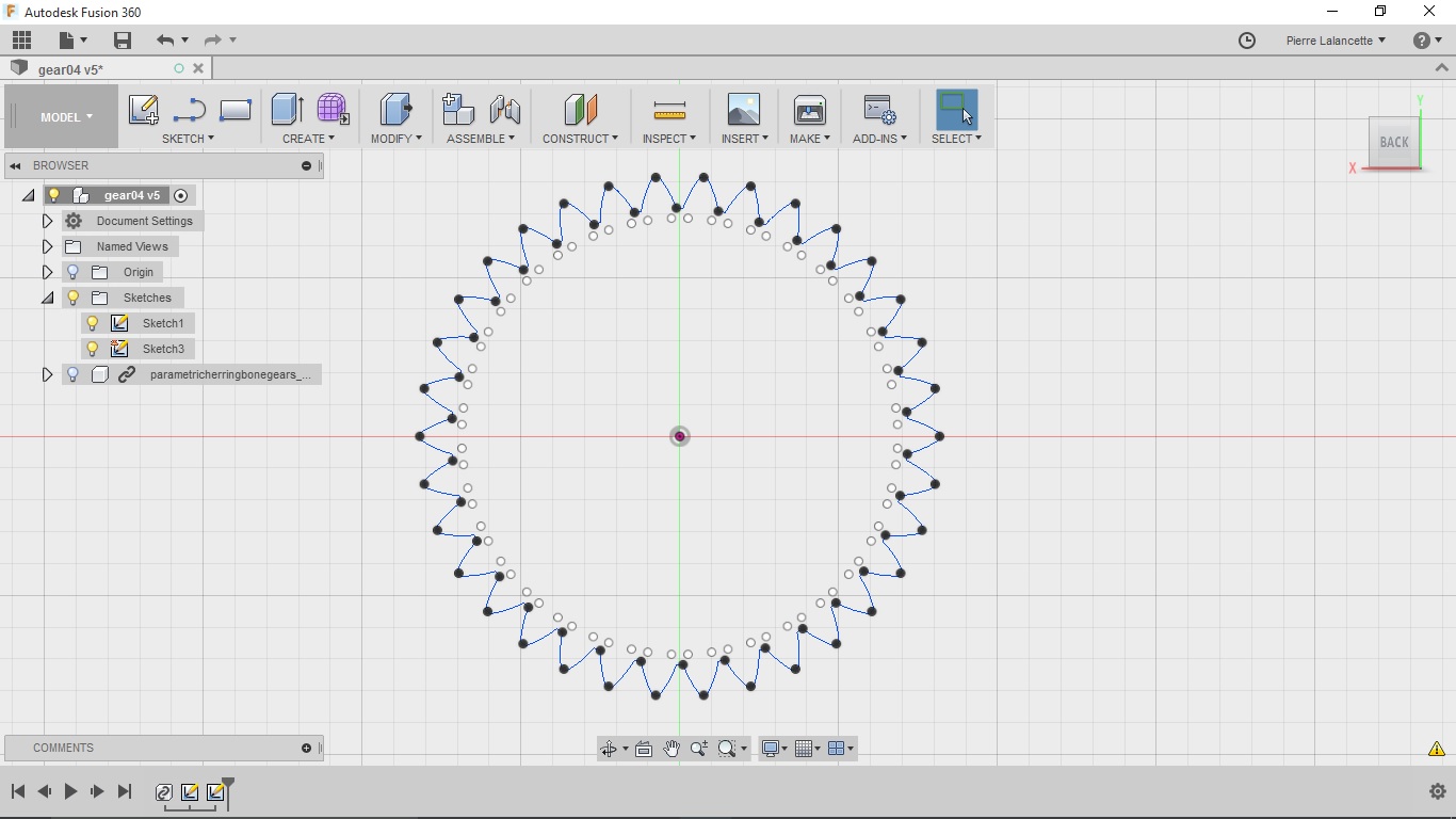

    I have my shape in a sketch, and I know how to select only the sketch lines.
    But I can't do anything with it. Simply because the sketch is not black, due to the curve, probably. But I have no idea how to make it black.

    How did you create your sketch? I've not used Fusion 360 yet but do have experience with AutoCad Inventor and I'd bet that you have a gap somewhere preventing it from becoming a complete polyline. In AutoCAD Mechanical you could attempt to hatch the area and it would highlight the open ends for you. Not sure if this function exists in 360 so you may just have to zoom in really close and check all points are connected.

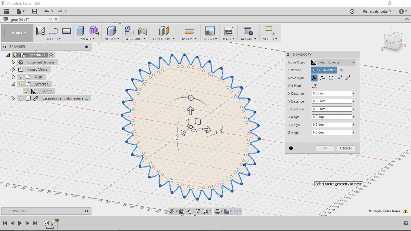

    I did. It took about 13 minutes on my poor little laptop. All the black dots disappeared one by one, exepted one. Still, now I can select the center body and extrude a gear.
    But what I need is to make copies of this sketch (that I can turn), so I can loft them all into a gear that has v shape tooth. So, I set the select filter to Sketch Curves and select all my curves, press M...
    Guess what? I still can't make a copy.
    I tried crt-c, crt-v, create a new sketch, extrude it and turn one face, sacrifice a chicken... Nothing worked.
    I could recreate the full sketch, connect the dots, but... Come on! There must be a better way.

    Almost there:
    The copy is in the right click over a selected sketch and use the command 'copy'. Then, you can 'paste' it in the same sketch and move it. Do a create/loft and select the faces in the right order. Then drag select the center sketch and press M to turn it. This is over simplify since all of this as to follow some rules that I don't really understand. I'll tried to do a tut over this, once I'll find linear interpolation in the loft. But it is 4h in the morning and I have to go to bed.
  20. Pierre Lalancette
    Dec 11, 2016
    1,006
    Tech Artist
    Quebec, Canada
    8,035Coins
    +945 / 6 / -0
    Seriously?
    We force you to use our cloud system!
    Political design.
    What a piece of crap.
