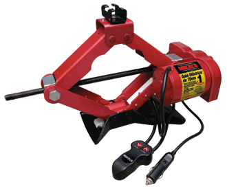

    hello friends :hi: , I saw this car elevator that uses that system and has an integrated 12 volt motor, it may not work but this model is to extend the ideas ... might be another model, or buy one without an engine hoist and put the engine wear, Greetings! :cheers thumb.png

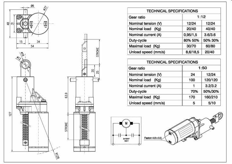

    Did you find a good deal for your ball screw ? do you have a link, please ?
    @Christianr3 : or you can have a look here OSLV http://www.oslv.com/microactuators/151-1-en.html
    110 € + tax
    but they are not irreversible
    and i was wondering about their low duty factor ...

    Well at 5mm/s way too slow, might explain the duty cycle.Motor range of torque to drive the screw when weighted.

    Yes, speed under load is the most important and often not given...
    in 24V and 1:12 gear ratio, it gives more : 18,5mm/s
    but I agree it gave up this approach because it was not enough
    I posted this because maybe someone knows a similar but better product ?

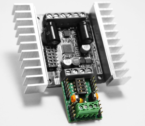

    Suppose this little drives wasnt around when ya needed it.
    http://www.dimensionengineering.com/products/kangaroo
    Will be my next choice on a build.
    I have one just need the funds to buy a sabetooth to begin a test, and yes you can by a usb adaptor and can be software set by its own config program.
