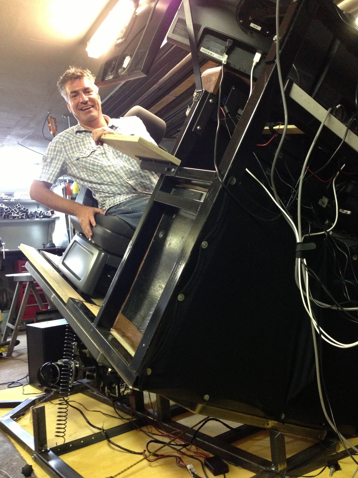

    Hallo Gemeinde,
    ich wollte mich hier mal mit meinem Projekt vorstellen.
    Aufgabenstellung war, eine Motion-Plattform zu bauen, welche in Räumen bis 2,40m Raumhöhe zu betreiben und trotzdem 20° Neigungen in unter 1,5sek. schafft.
    Außerdem sollte sie große Lasten über 300Kg stemmen können, da mein Homecockpit aus einer Stahlrohrkonstruktion geschweißt ist und für 2 Personen vorgesehen ist.
    Das Ergebniss:
    Viele Grüße aus Berlin,
    Roland

    Thanks to all of you for your interest. I will try to answer your question:
    The net weight of the platform is something around 500 kg.
    Unfortunately I am not a PC programmer thats the reason why I - unfortunately - cannot answer everything in detail.
    The sabertooth controler (2x 60 A) is drivern by the software of Ian Hopper.
    The wiring is exactly as per his drawing ( http://bffsimulation.com/sabertooth.php ). He did a fabulous job to get this thing running.
    Concerning more details I have to refer to my youtube videos showing the mechanical parts and drivers more detailed. Hope, that will help you.

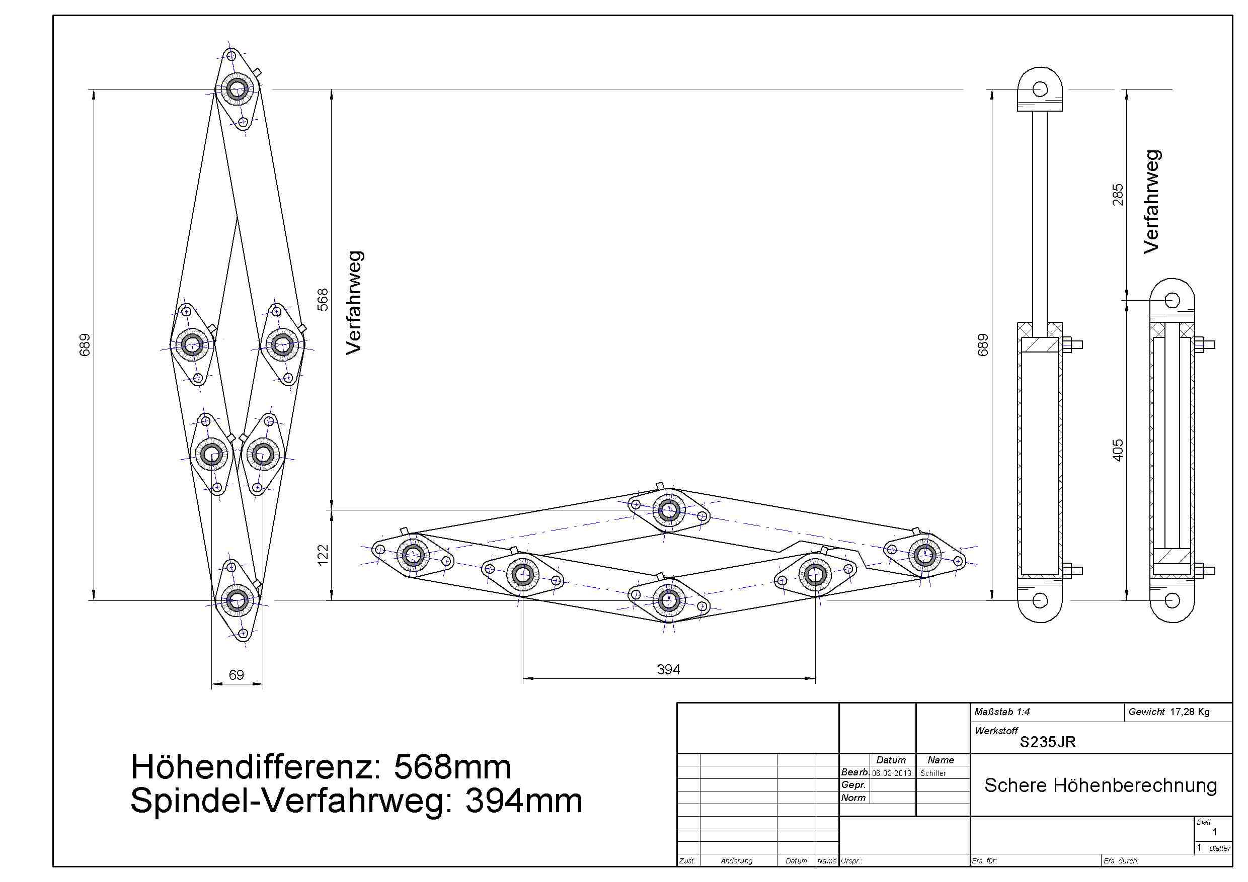

    In the drawing one can well recognise, how high and deeply the jack goes. In the comparison a hydraulic cylinder (or linear engine). Schere Höhenberechnung.jpg

    +1,973 / 13 / -0
    Beautiful!:) That´s an amazing comparison.

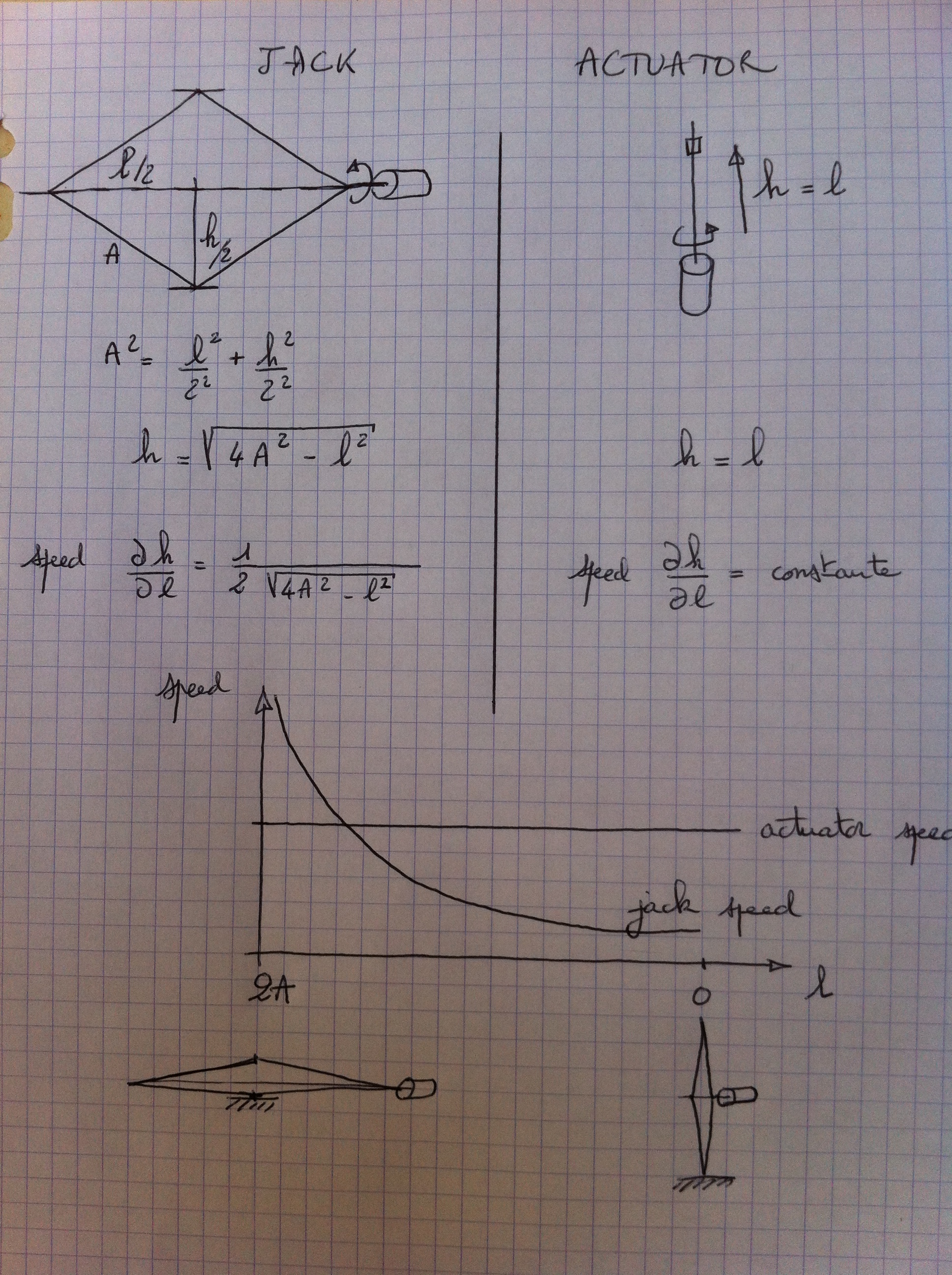

  16. RacingMat
    2,234
    20,902Coins
    +2,084 / 21 / -2
    yes, this is a compact actuator !
    but the drawback is that speed is not linear.
    Turning the axle in low position, moves up quickly. But as time goes, the speed reduces...
    So the electronic has to compensate this.
    The advantage is a nice and smooth movement ! It is well done !
    Did you machine all the pieces or is it an electric jack you bought and modded ?

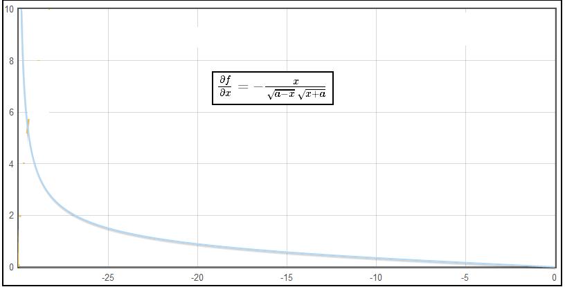

    +1,973 / 13 / -0
    Where did you get that formula Mat?
    Interesting thought! I am curious if chillermetall considered and compensated it.
    As far as i know he planed and construct the complete actuator by himself

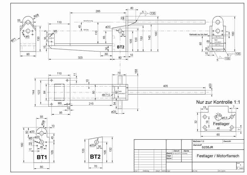

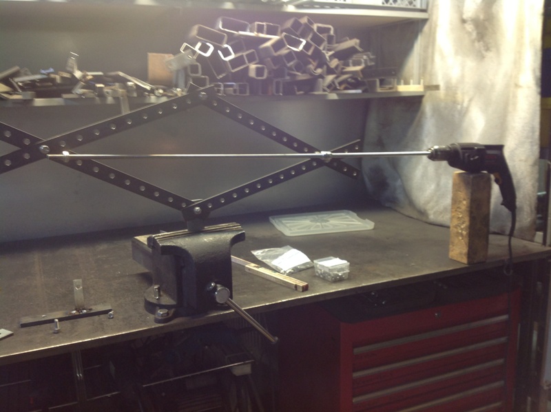

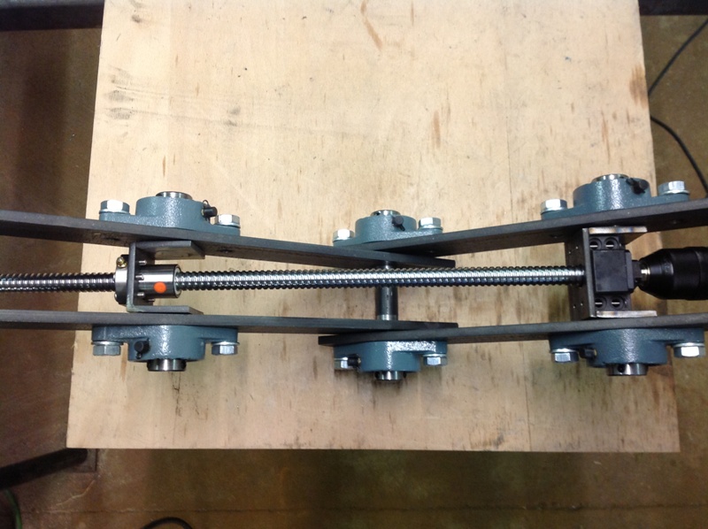

    All mechanical parts are from my production.

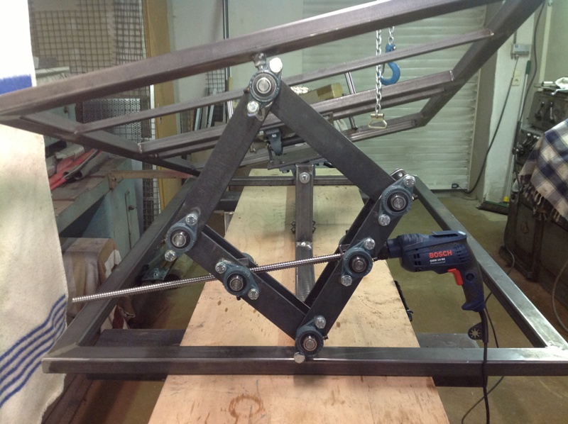

    First, I've experimented, such as speed and power are:
    Then I drew a design:
    At the end, a prototype was built:
    So Easy!

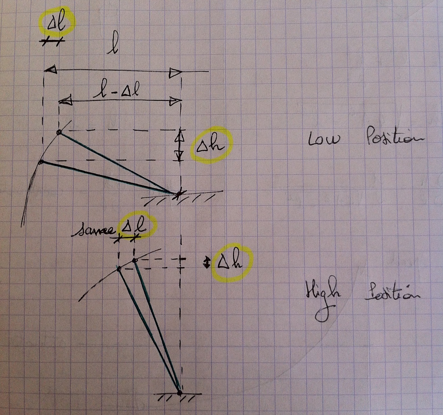

  19. RacingMat
    2,234
    20,902Coins
    +2,084 / 21 / -2
    1 motor turn will shorten the horizontal screw by 1 cm (<>L in my sketch)
    - in low position, the arm will raise very much to compensate this 1 cm minus length of the screw
    - once raised, the arm will raise few to compensate :
    Considering this, I calculated it like this : jack speed.JPG
    Could you tell me if you used ball screw or simple screw with a nut ? I can't see
  20. schillermetall
    schillermetall New Member
    Aug 5, 2013
    10
    Metallbaumeister
    Berlin
    9Coins
    +15 / 0 / -0
    I use ball screw.
    Simple crew brake too heavily dignity.
