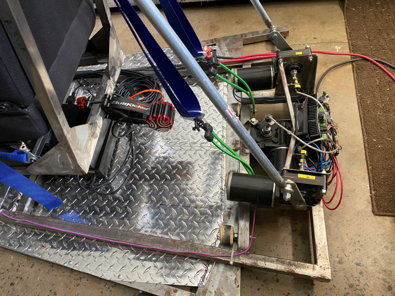

    So I added two buttkickers, (sorry only one is on this video) I bought a second sound card to feed in the telemetry data to them. I mounted one to the rear of the frame and one under my feet at the pedals. I turned all the effects off and then turned them on one at a time to tune them. I used (and paid the developer) for SIMhub and it seems to work just great. So here is a video of the rig from last week and me crashing into a wall.
    I have the overall Aseto Corsa effect set at 80 instead of the usual 89. This matches the power of the Formula lights car a bit better. In any case, I plan to get two more transducers so that I can have one on each corner.
    A quick shout review.. The transducers absolutely add to the immersion. If you dont have one, get one. DMAX

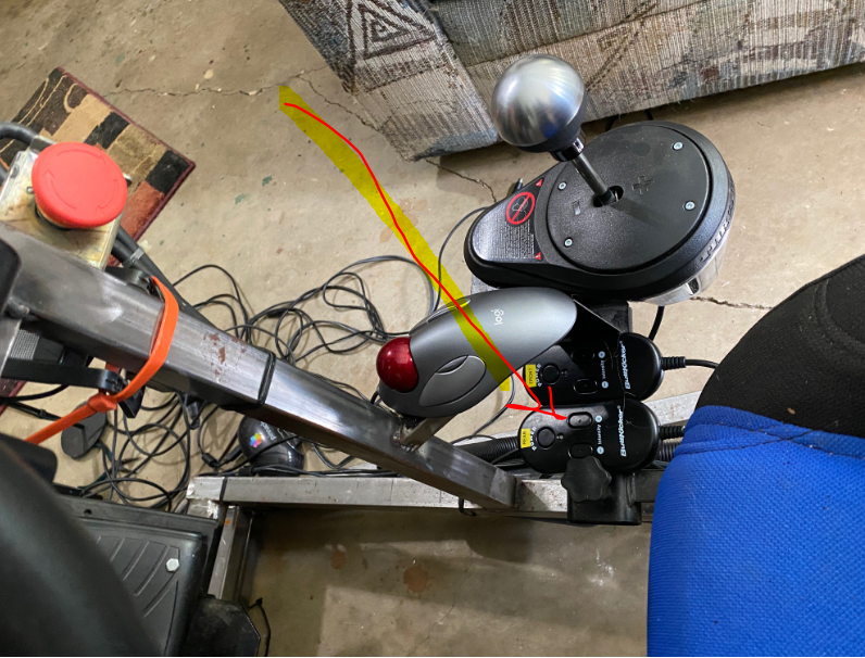

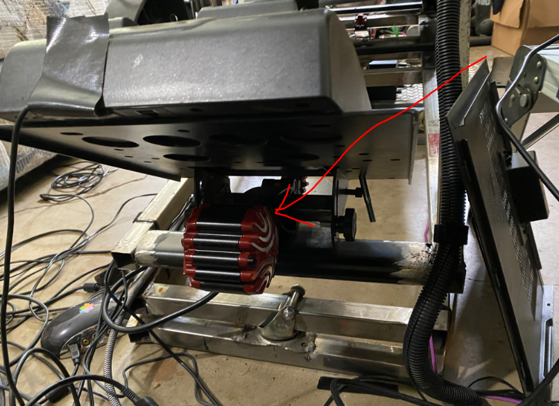

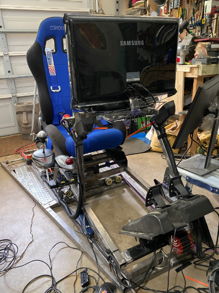

    Here is a few photos of the transducers mounted to the Rig. I had to weld a 1 inch bar underneath the pedals to mount the front one. When I buy the other two of them I think I will make them out-riggers. We will see. I have a computer upgrade coming soon so after that I should have the other transducers ready to go and will post an update on how they end up working.
    GAMER 2 mounted in the rear of the RIG
    Both Front and Rear Controllers mounted near the shifter.
    Front transducer mounted under the 2000 Driving force pedals.. (dont laugh too hard- Im getting some V3's
    Front view of the Rig.. Still in my garage (kind of like a car hahah) I still need to take it apart and paint the frame
