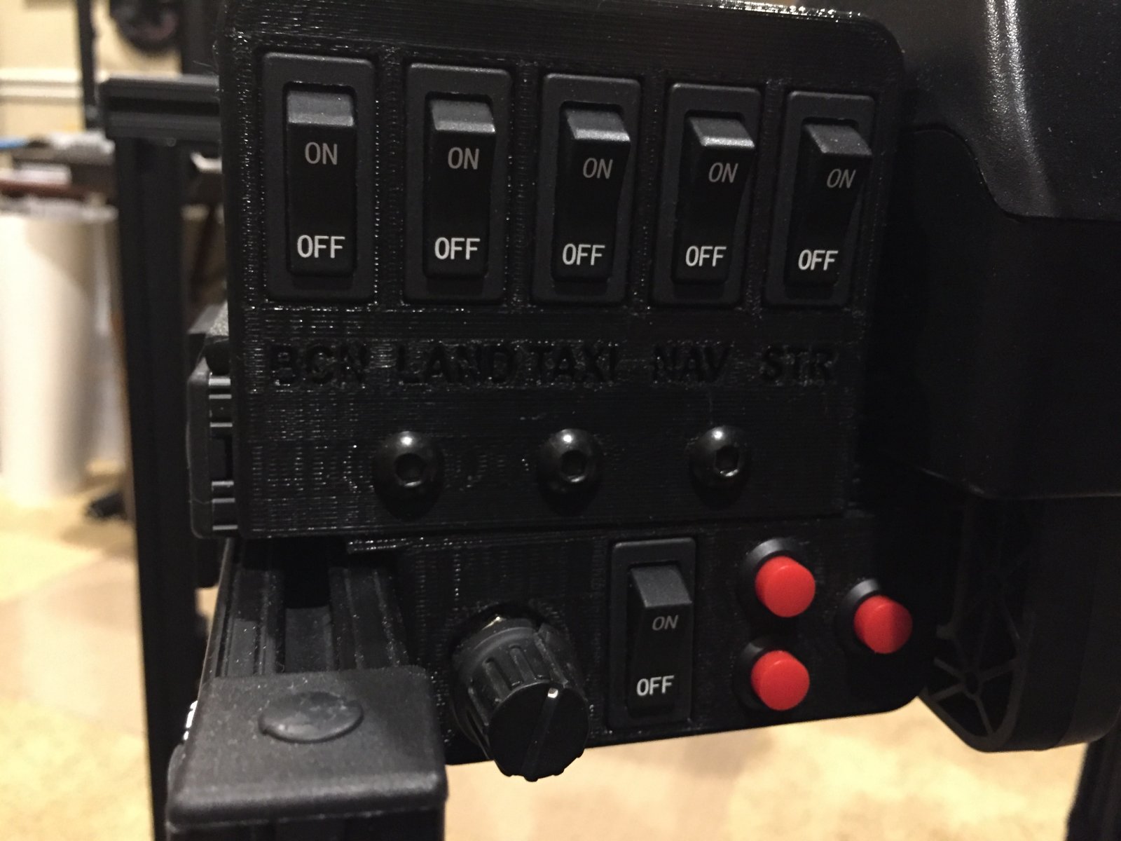

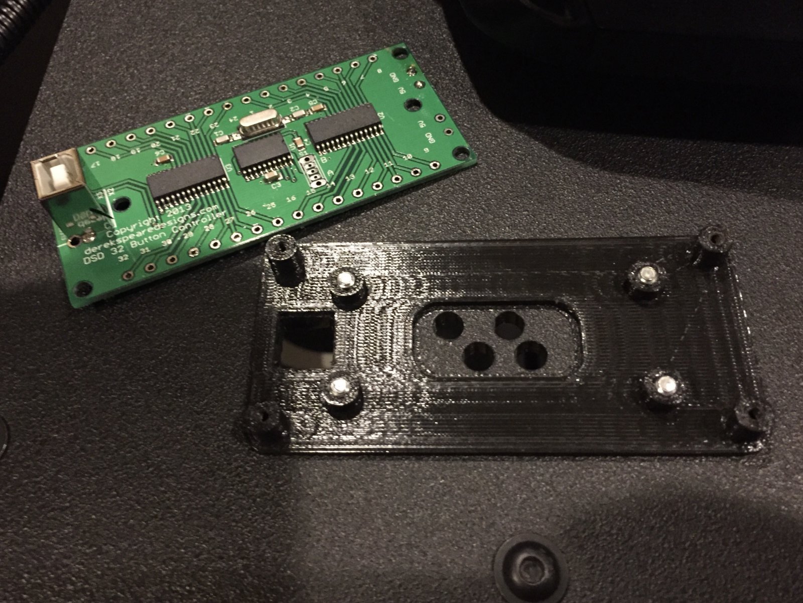

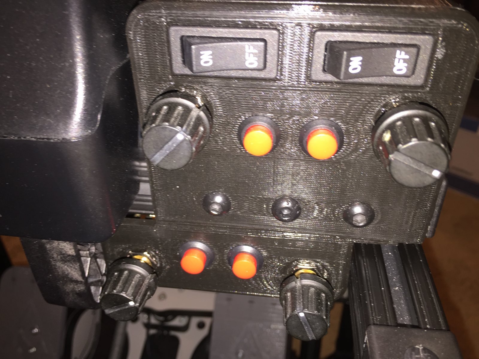

    Anyone running in VR knows how important it is to have knobs, switches, and buttons to control things especially in flight sims. I had a DSD button, knob, and switch box laying aound that I couldn’t use on my rig since it was big ad bulky, and the controls weren’t grouped intuitively.
    [Edit - swapping out for a Leo Bodnar interface. The DSD was never reliable and I’d have to switch things multiple times sometimes to get it to take and that was an immersion breaker, not to mention taking attention away from flying the plane. I suspect the DSD doesn’t have much software contact bounce mitigation but don’t know that.]
    I decided to rework them and mount them more to my liking. I'll post the stl files later but here are pics to show the concept. It’s not finished but this is the setup. I still need to add wiring. As a bonus, I accidentally threw away my wiring diagram from the original box but it was trivial. The only oddball bit was the knobs that are great for incrementing and decrementing settings. While testing the circuit I discovered there are a fair number of working additional terminals that were unused in the original box. 32 terminals with 10 used for the five knobs leaves 22 for switches and buttons.

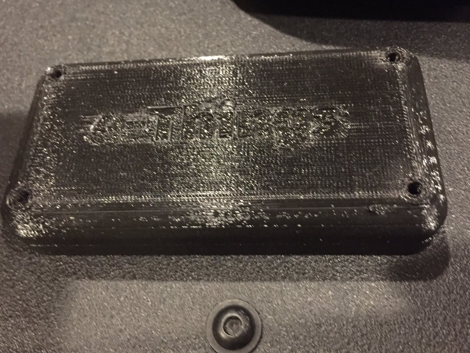

    I printed up a base and box for the circuit board, and boxes and mounts for the switches, buttons, and knobs. I think with FSUIPC this ought to be pretty handy. For those unfamiliar, you can do the same things with an Arduino. I just had this laying around.

    Thanks, Jerry! Still wiring up the switches but they will help cut the need to reach over and find the mouse to activate common controls. May rework with better switches and knobs later especially now that I know the other inputs all work even though they were unused. You think you’re finished and then you aren’t. :thumbs
    Edit - yep, never finished. I recently got a Leo Bodnar USB interface and some nice stacked rotary switches like you see on the Garmin units in FS2020. The Derek Spear Designs switch interface was never reliable even before gutting it to connect to custom switches. Also got a load cell interface to try to give my toe brakes a more realistic feel. Will update some more as those projects complete.
