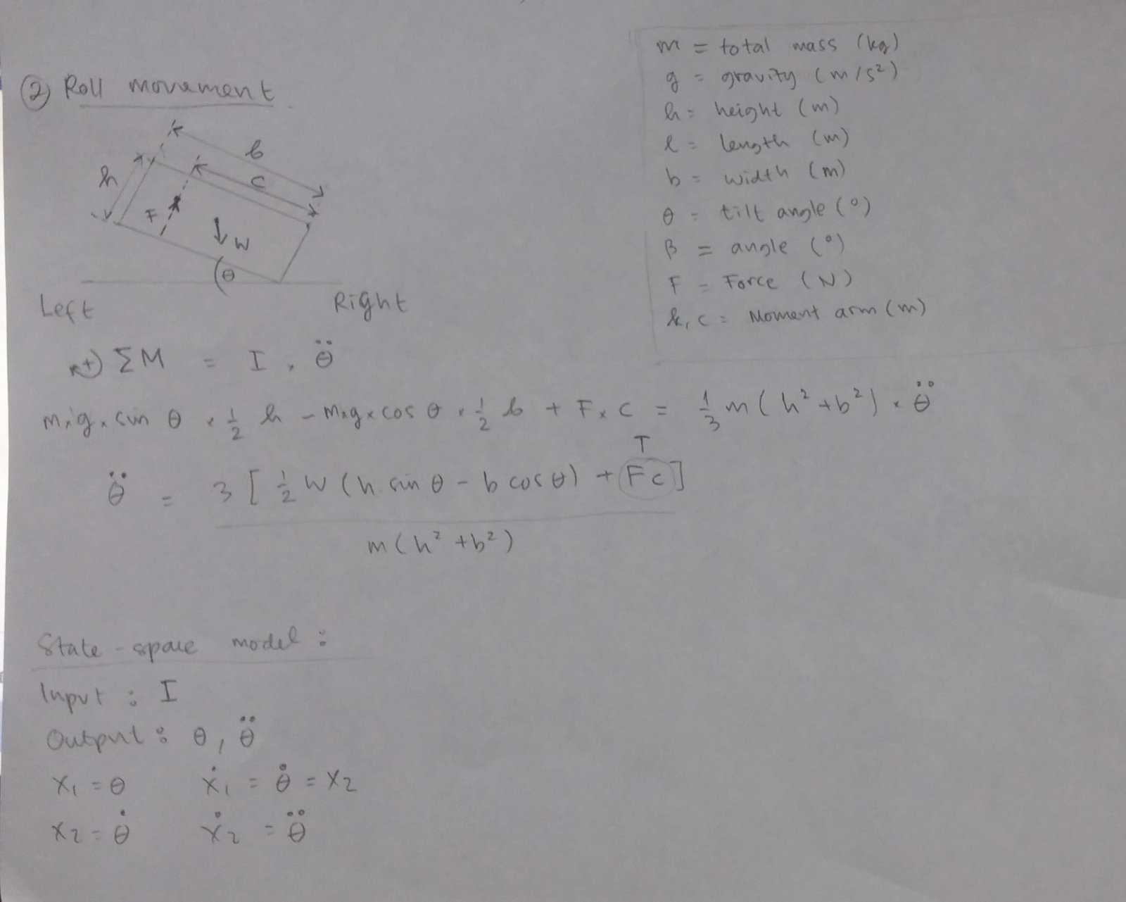

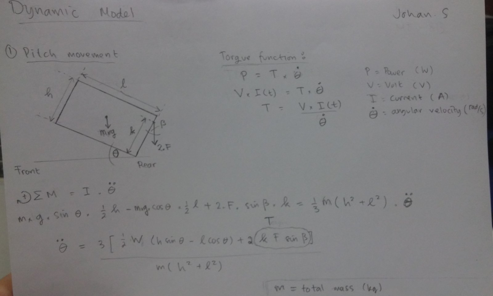

    Hi, my name is Johan. I tried to build using this concept but do you guys have the dynamic equation to analyze the movement of the chair? I used this as my thesis project so anyone please if you can help me. Thanks...

  10. pipis2015
    pipis2015 over-boost
    Feb 18, 2015
    221
    Athens, GREECE
    10,248Coins
    +272 / 1 / -0
    The movement of the chair depends on the characteristic of the motors, the inertia of the suspended mass, the arduino code that "translates" simtools data to motion.
    Most of the projects here are diy. Built on the go.
    Many of us have done some rough calculations to estimate motor power needed and determine the overall movement of the seat.
    Other than that I don't think that you can find more detailed info.
  11. Johan Soegiharto
    Johan Soegiharto New Member
    Mar 31, 2016
    15
    Jakarta
    203Coins
    My thesis subject is Designing and Constructing A Car Simulator Case: Electrical and Motion Control. I am a mechatronics engineering student at Swiss German University (SGU) Tangerang, Indonesia. It will help me a lot if I could get the dynamics motions for the simulator since I need it to be able to analyze the movement of the simulator before having it built. I have tried to design my own dynamic equation but it didn't make sense when I tried to make the state-space model of it. Thank you....
