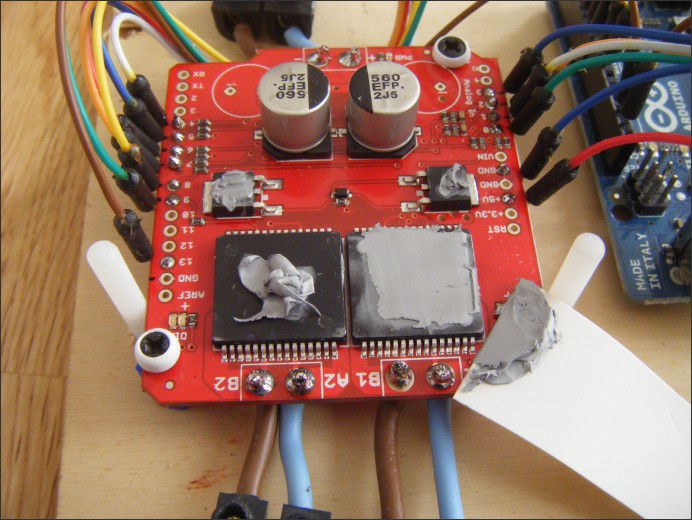

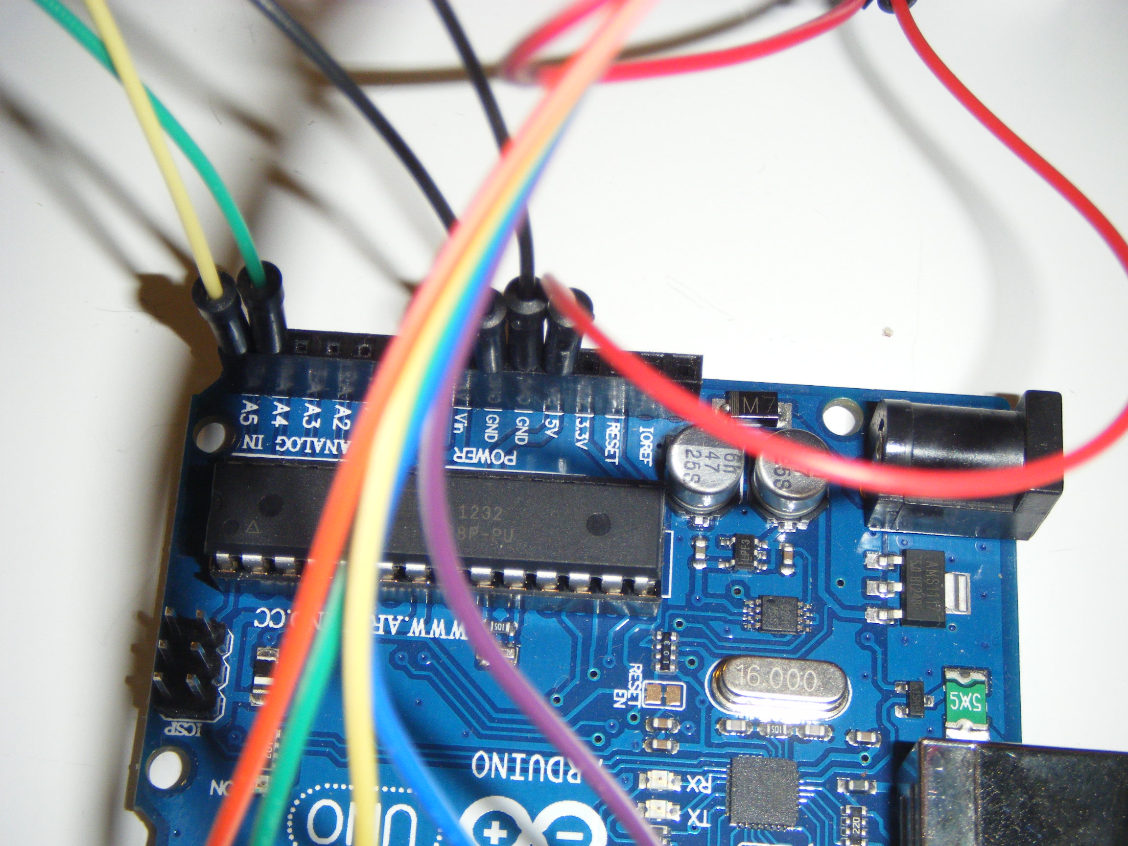

    Hi all, I saw this wiring and have a problem, I think pin A0,A1 on Arduino board are connect with pots for feedback position of 2 motor but in this picture (RacingMat's wiring), him connect them to A0,A1 of monster board, and I don't understand the function of pin A2, A3 here. Who know, Please hepl me. Thank you.
  5. Alexandre Kostik
    Alexandre Kostik Member
    Jul 2, 2014
    42
    realtor
    Brasil
    422Coins
    +18 / 1 / -0
    @kingh3
    see inside the Arduino code which port are attached pots ;);)
  6. kingh3
    kingh3 Member
    Sep 26, 2013
    42
    256Coins
    +10 / 1 / -0
    2DOF, 3DOF, DC motor, AC motor, SimAxe, Arduino, JRK, Motion platform
    int cspin[2] = {2, 3}; // CS: Current sense ANALOG input
    int enpin[2] = {0, 1}; // EN: Status of switches output (Analog pin)
    I saw, but I don't really understand. do you know why A0,A1 on arduino board connect to A0,A1 pin on monster board ?

    +18 / 1 / -0
    you are using this code ? follows part of it.
    racing mat code 2 dof
    #define motLeft 0
    #define motRight 1
    #define potL A5 "here is connected pot 1"
    #define potR A4
    "here is connected pot 2"
    // DECLARATIONS
    /* VNH2SP30 pin definitions*/
    int inApin[2] = {
    7, 4}; // INA: Clockwise input
    int inBpin[2] = {
    8, 9}; // INB: Counter-clockwise input
    int pwmpin[2] = {
    5, 6}; // PWM input
    int cspin[2] = {
    int enpin[2] = {
    int statpin = 13; //not explained by Sparkfun
    /* init position value*/
    int DataValueL=512; //middle position 0-1024
    int DataValueR=512; //middle position 0-1024
  8. kingh3
    kingh3 Member
    Sep 26, 2013
    42
    256Coins
    +10 / 1 / -0
    Yes, I use this code. I understand. thank you. ;)
  9. Alexandre Kostik
    Jul 2, 2014
    42
    realtor
    Brasil
    422Coins
    +18 / 1 / -0
    OK!!! always look for the code .... I burned a ard and a bridge h , for not having attention in the code !!!!:grin:grin

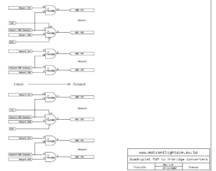

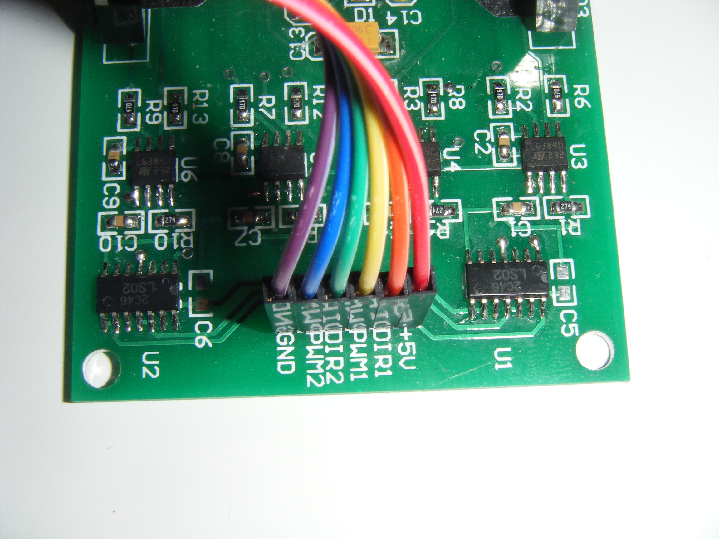

    Hello. I used a plate with logic circuit with the 74HC08 Thanos . I made a pcb and connected between the ard and h bridge.
    follows electric scheme
    sorry my english (google translator)
