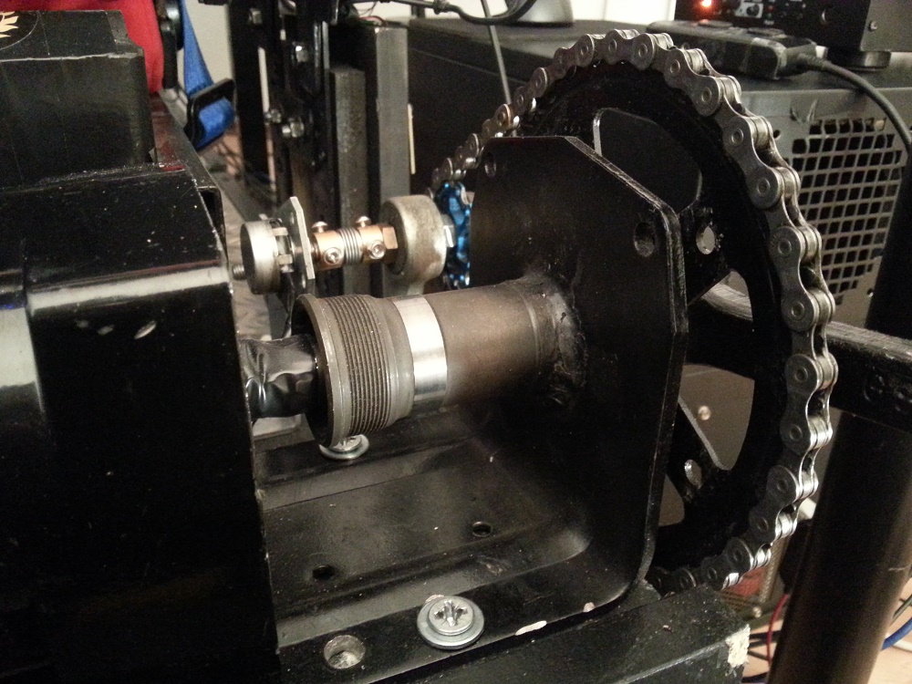

    I got to see your videos @Pit (your setup is whoaaa btw but I don´t want to spend that much money ;-) )
    You used some bicycle part there. What does the chain transition do ? Looks to me like the motors are connected to the big gears anyway?

    BTW the most expensive parts are the projectors. Winches are chap, Arduino and MMs as well. PSUs are even more cheaper ;) The chain transition moves the potentiometer. How the winches work I explained you by PM.
