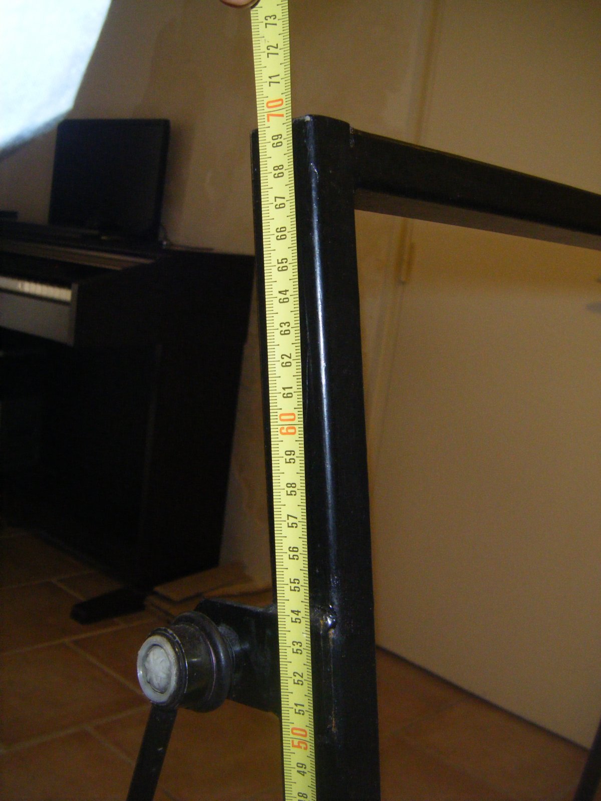

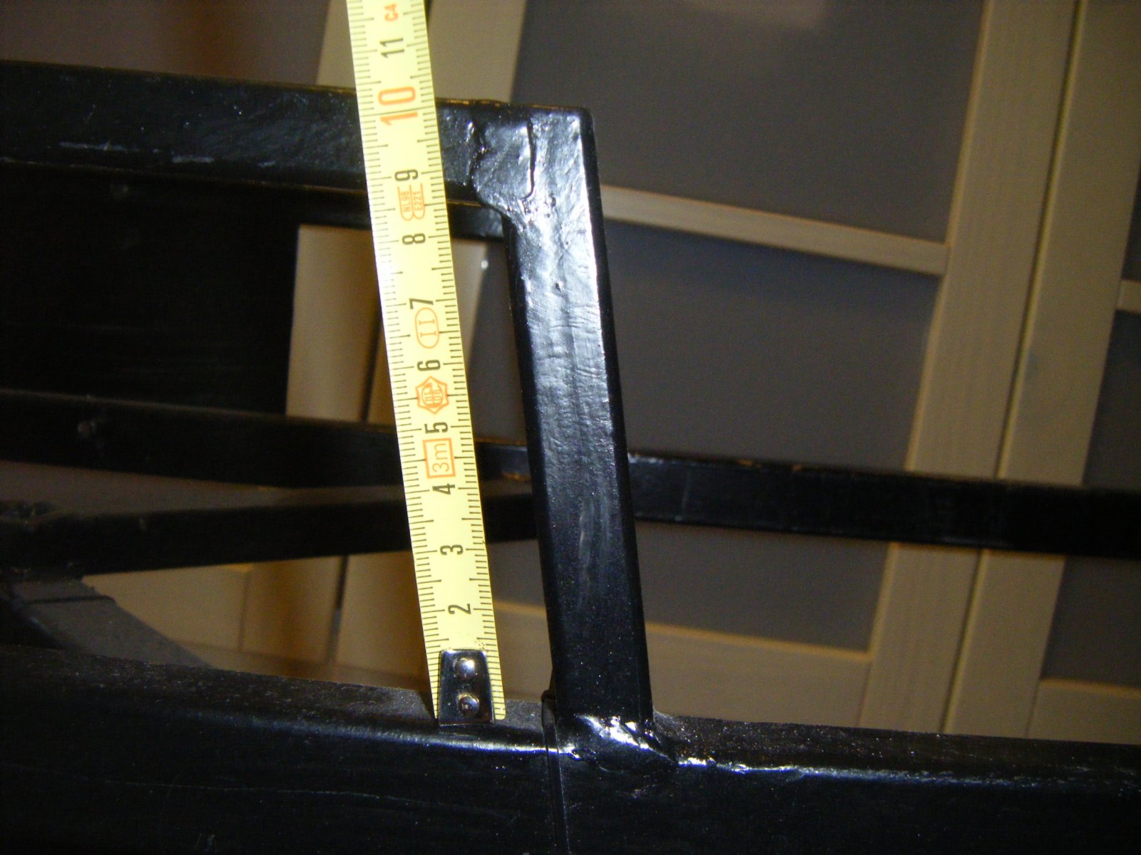

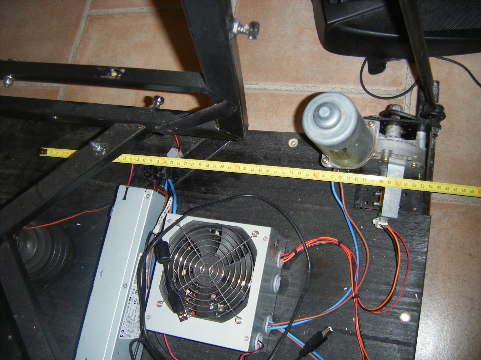

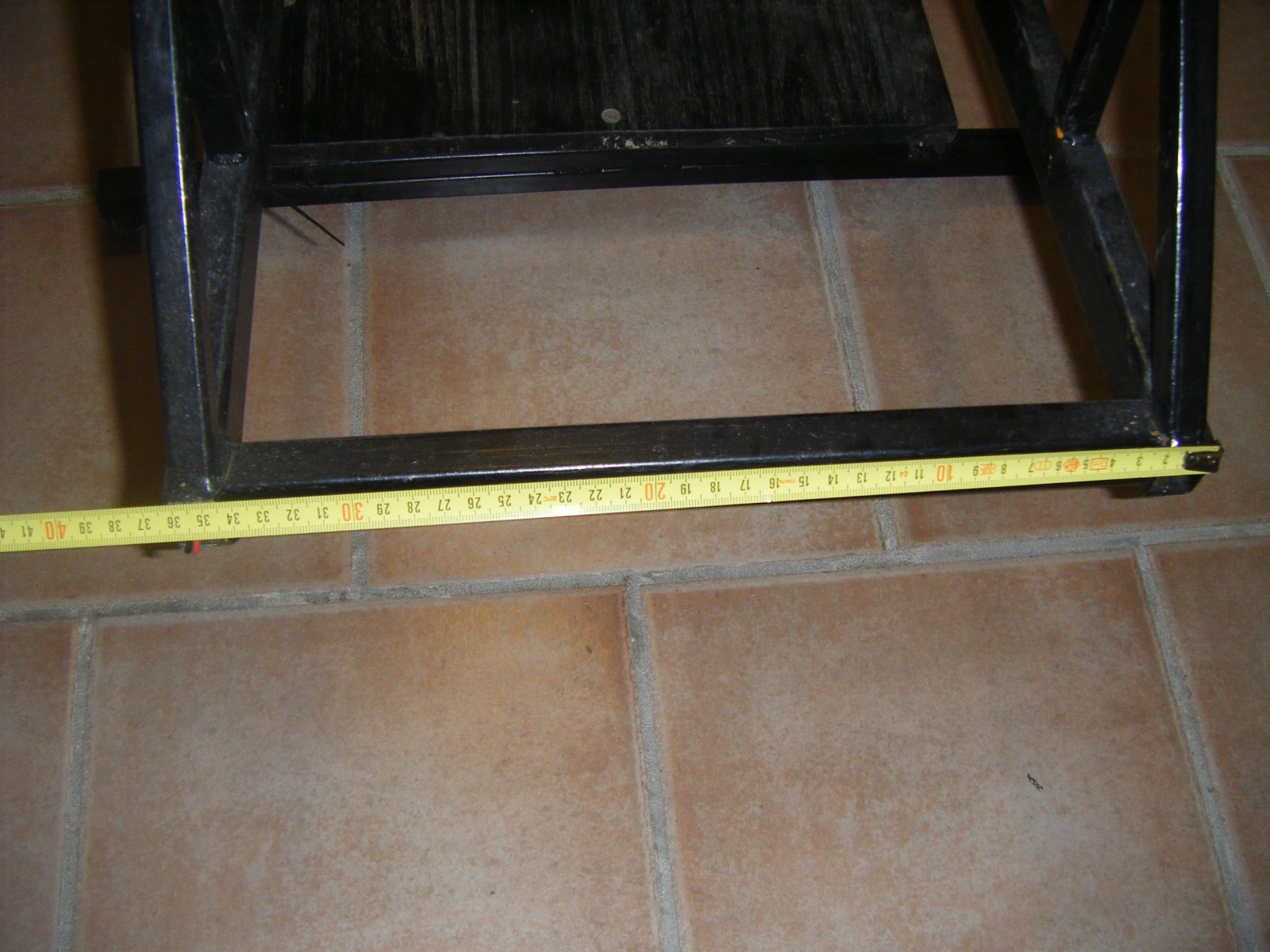

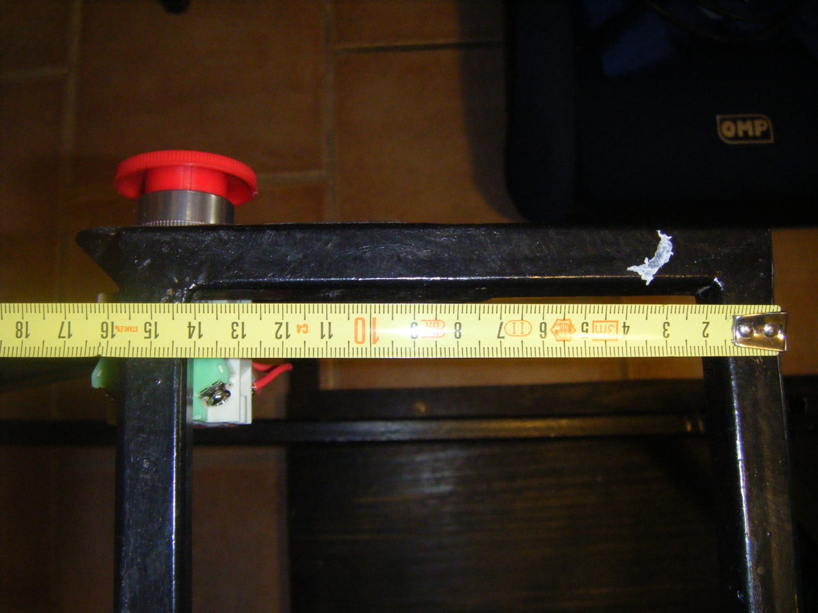

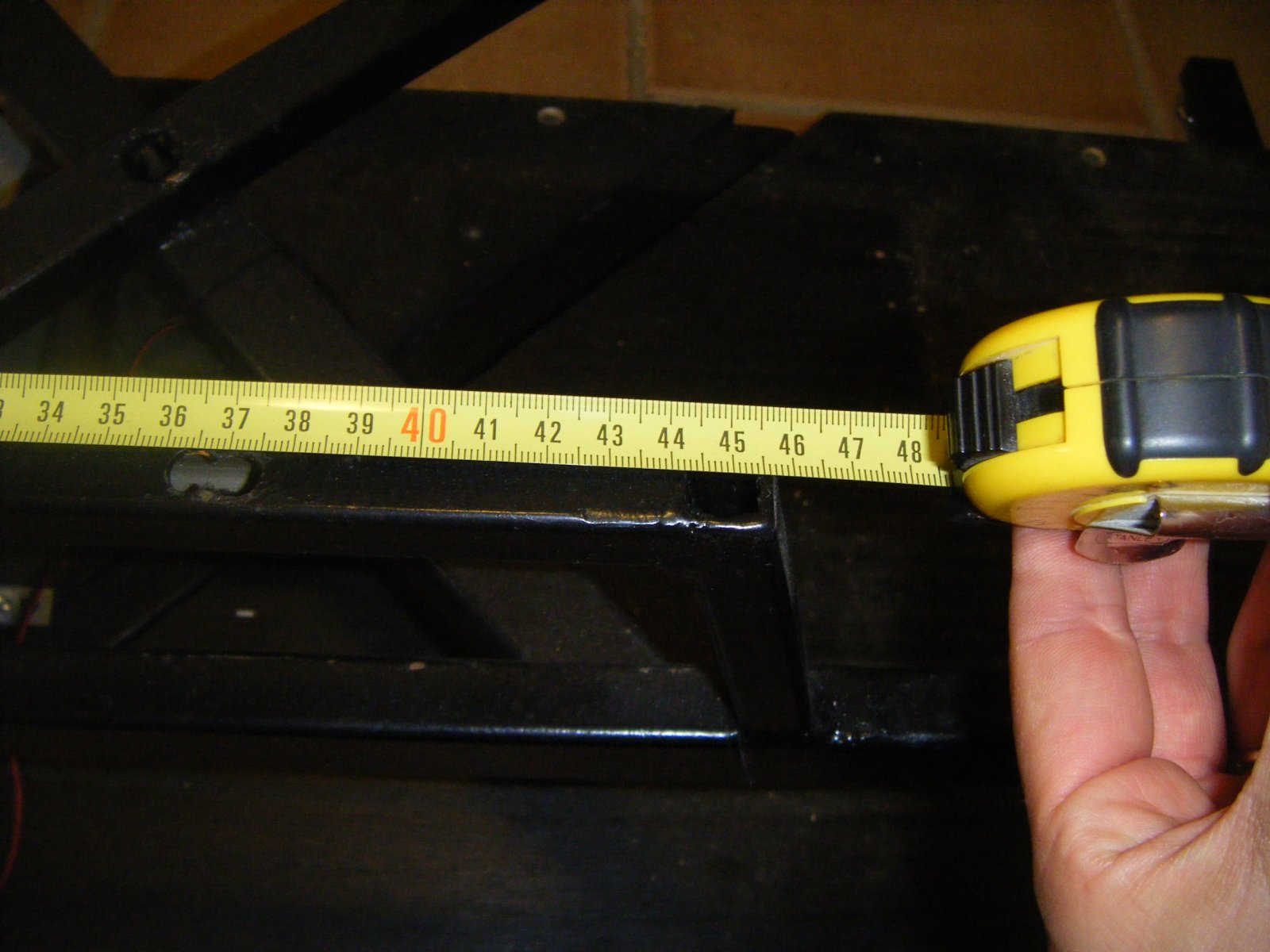

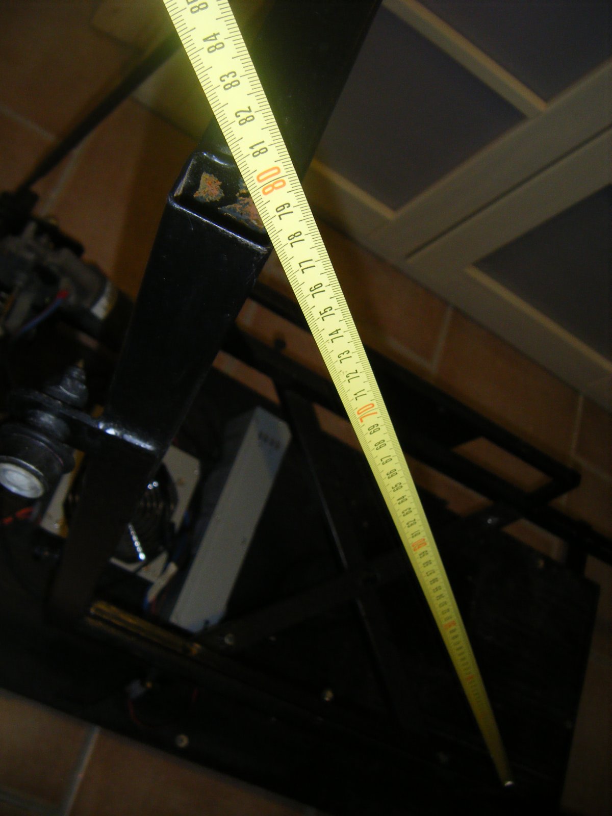

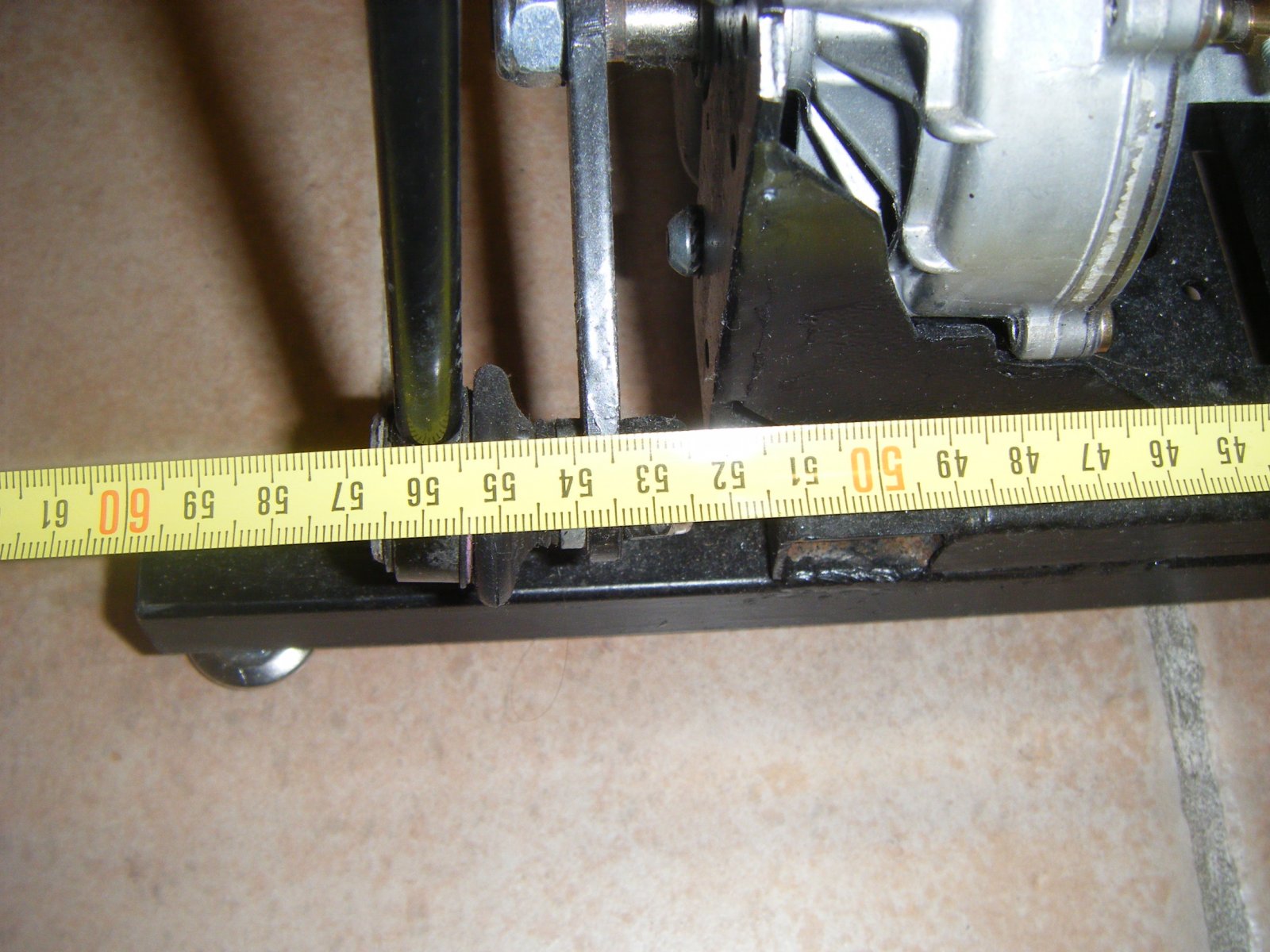

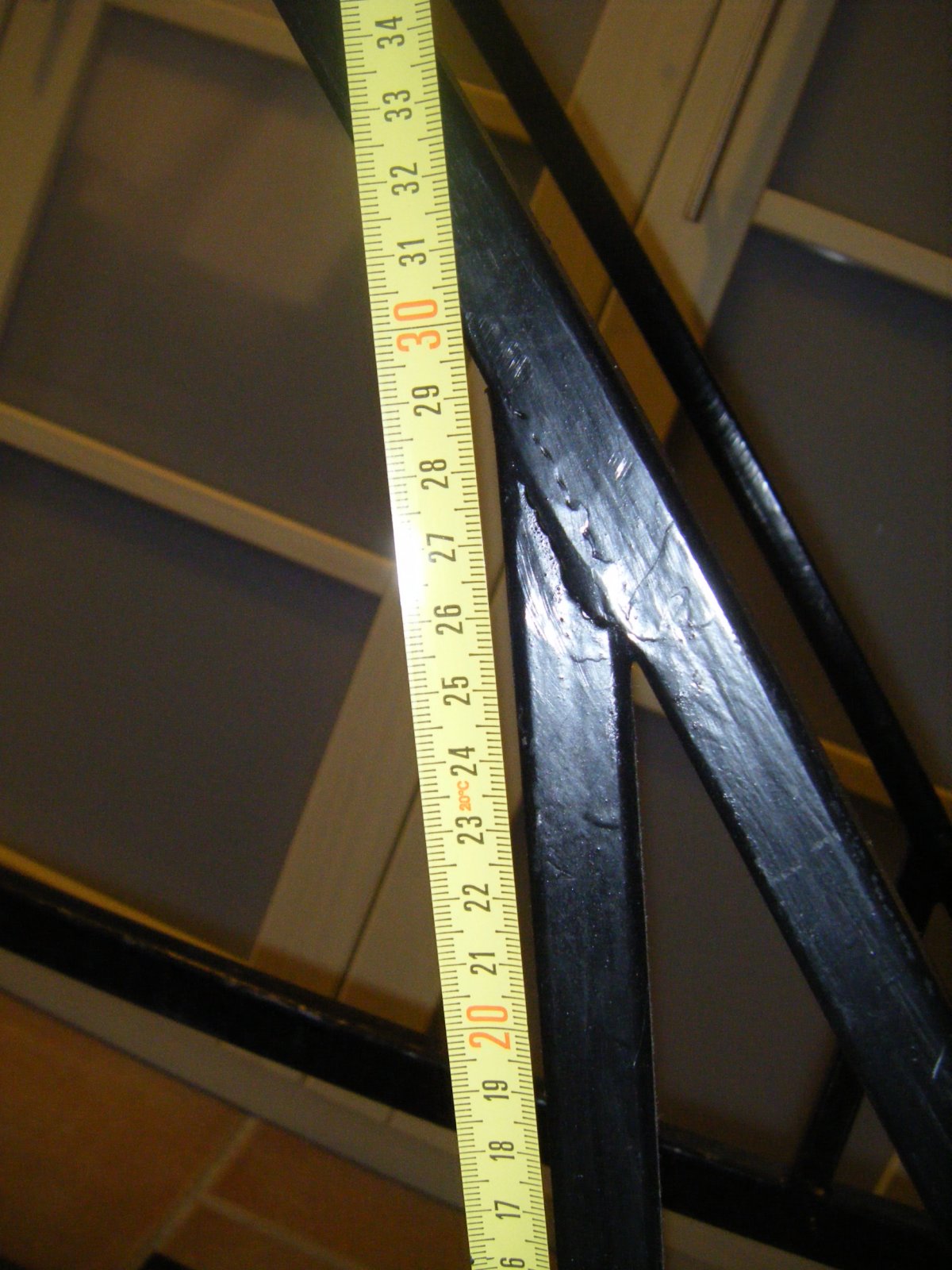

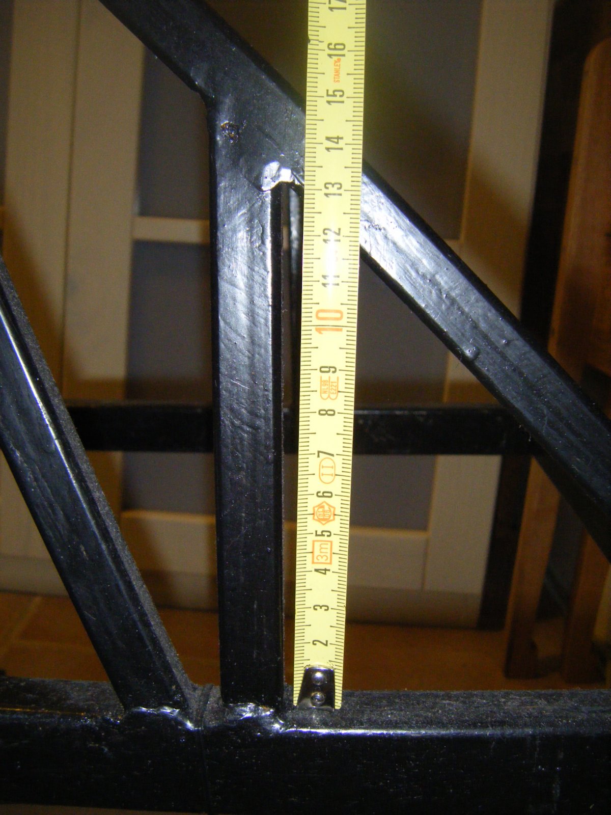

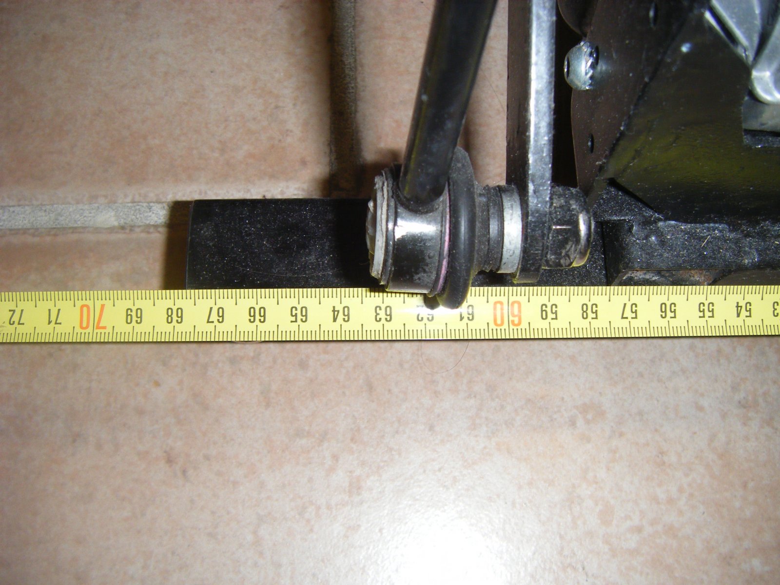

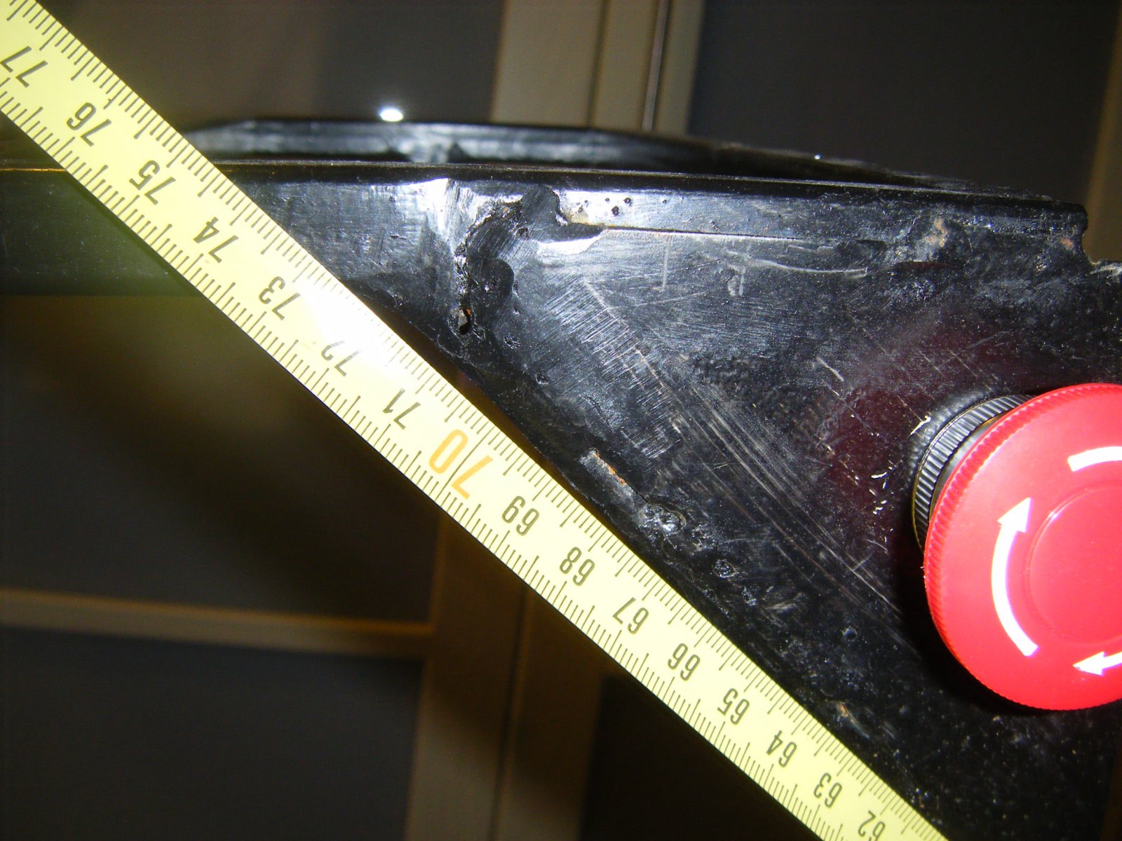

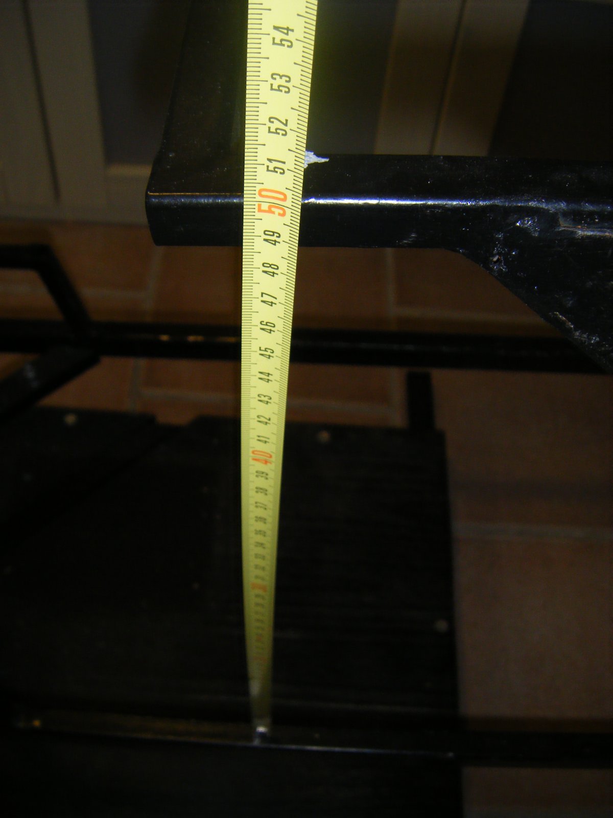

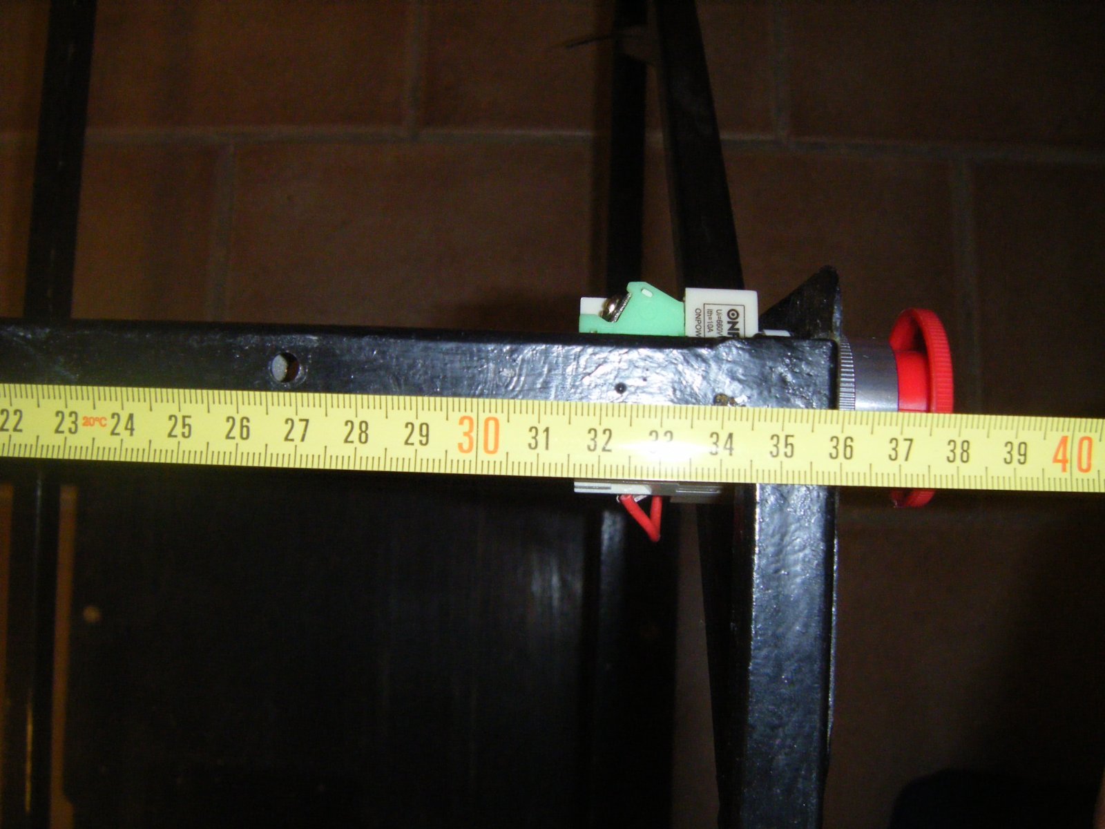

    @vthinsel
    some pictures for dimensions
    dimensions 2DOF (14).JPG dimensions 2DOF (3).JPG dimensions 2DOF (2).JPG dimensions 2DOF (1).JPG dimensions 2DOF (6).JPG dimensions 2DOF (7).JPG dimensions 2DOF (4).JPG dimensions 2DOF (5).JPG dimensions 2DOF (11).JPG dimensions 2DOF (10).JPG dimensions 2DOF (9).JPG dimensions 2DOF (8).JPG dimensions 2DOF (13).JPG dimensions 2DOF (12).JPG
    it's a kind of brainteaser chinese-puzzle but if you take your time, I hope you could find all you need!
