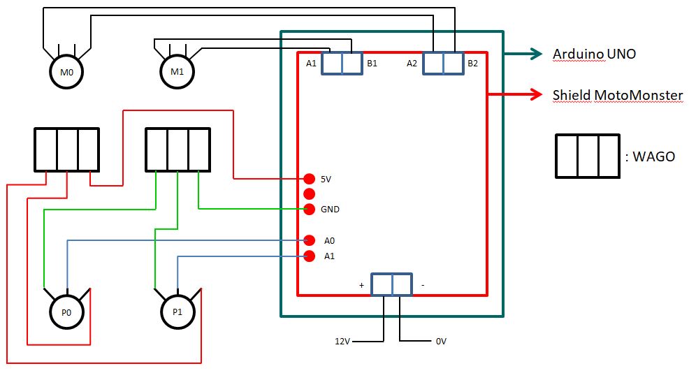

    Hello Guys ! It's been... twenty days...
    I didn't have the time to work on my system since the last time, but here I am to continue.
    @RacingMat, Following your message,I decided to restart my tests. I'll try to explain in details what happens in my system. Notice that I didn't change a thing about how works the code (sometimes I add some Serial.print() --> Not a problem).
    My potentiometers are not mounted onto the motor, I decided to do tests before coupled it. Attached, I transfer a schema of my system (Not a photo cause it's a bit messy for now...).
    I have a problem at the beginning :
    In fact, whatever the value of DataValue is, the range [0-300](with potMini = 208) don't allow the motors to move.
    Furthermore, the range [815-1024] (with potMaxi = 815) allows the motors to work.
    The part concerning the Tolerance is working whatever the value of DataValue is (if DataValue is 512, motors are not working until their potentiometers are <492 or >532), etc...
    It's hard to do a video of the system because I would like to catch the system and the monitor if possible to show you the problem...
    Explanation (try) :
    . Setup : Potentiometer = 512; potMini = 208; potMaxi = 815; no mouvement,
    . When I increase the potentiometer up to 1024 --> Motors are working CCW,
    . When I decrease the potentiometer down to 532 --> Motors are working CCW,
    . When I decrease the potentiometer down to 492 --> Motors are in the Tolerance part --> No mouvement,
    . When I decrease the potentiometer down to 300 --> Motors are working CW,
    . When the potentiometer is lower than 300 --> No mouvement,
    . When the value of potentiometer decrease lower than 300, I need to increase the value to 532 to make the motors work again.
    This seems totally weird, isn't ? Did I explain it clearly ?
    Can it be a problem concerning the shield ? (I ordered one more shield three weeks ago to try another one but not received yet)
    Do I miss something ?
    Waiting for your response, Cordially.

    the first step is pot not attached and no command from serial monitor:

  10. RacingMat
    2,237
    21,050Coins
    @UserBas: it's works perfectly!
    now you can link the pot to the motor shaft.
    Just check that when face to face, pot and motor should turn opposite ways. That's normal, with middle position order in memory, it's the way it will self stabilize (if pot goes in one way (say under a great force) then the motor goes opposite way in order to go back to middle position).
    If it's not opposite, swap black and red wire of the pot.
    This test is mandatory: if not done, the motor will go full forward and break the pot. If unsure, try with a loosen connection that will slip if wrong. :)

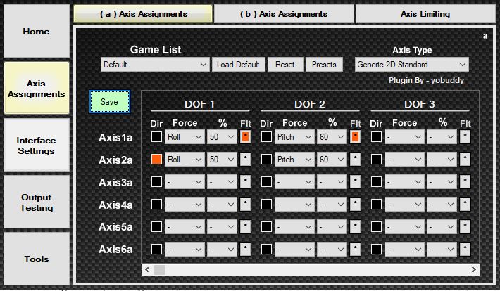

    Hi @RacingMat !
    Overall, yeah, the system is working.
    I went to the next step (link the pot to the motor shaft) and I just had to swap my wires to make it work perfectly.
    I'm actually stuck at the "Output Testing" step.
    In fact, when I'm moving cursors, nothing occurs, no motion.
    I already configured my "Axis Assignments" (Default) and my "Interface Settings" (pictures enclosed).
    I probably missed one step, but i don't know which one...
    I continue my researches !
    Thanks for your time !

    before using Simtools, did you manage to send position through arduino serial monitor?
    Now without any game running ! send orders from Arduino serial monitor :
    type the following strings in Hexa and press Enter:
    R7FL7F
    -> it should move the playseat/motors in horizontal position
    increase the angulation
    R64L64
    go farther cautiously
    R3FL3F
    you have to be able to move from 1 position to another

    I ordered (on Output Testing) : Roll -60; Pitch 48 and Surge 74 (I had surge 20% Default' DOF)
    Nothing occurs early but after 2 minutes, my motors did a little mouvements, then stops. This behavior happened several times (without touching values) anytime.
    It seems like the connection works but I can't control motors.
  15. RacingMat
    2,237
    21,050Coins

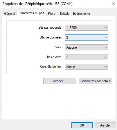

    no, the connection doesn't work... there is something wrong in the setup.
    some screenshots are in french, are you sure it's your screenshots and not from the tutorial? :rolleyes:

    Any idea where the problem can comes from ? :think
    Maybe they are in french because I'm a French guy ?
    Why would I send you screenshots that would not help me ? I started asking for help since early April without real success and I can assure you that I want it to be finish as soon as it can be... I'm stuck so close to te end (at least, I think) and I think I did (almost) everything like you guys said in the pasts tutorials. It feels like I'm powerless here.
    I'm gonna try on another computer, maybe that could change something.

    If your serial monitor tests which are OK, are done with the same computer as Simtools, it's only a matter a setting up Simtools now. And yes you're close!
    - you can try R3FL3F as "startup output" to see if motors are moving.
    - you can try a basic test with FlyPTmover
    You can add you location on your profile, it's always a wonder to see where people are from :) far far away or really close!

    I already tried to replace the "startup output" as you said and nothing occurs (I'm sorry, I should have told you before). Furthermore, I had the same problem on my other computer, so I decided to come back on the initial one.
    I don't know what happened during the change but... It's working...:thumbs I'm really surprised ! Nothing changed ! Maybe tomorrow, it'll not works, but actually I'm satisfied.
