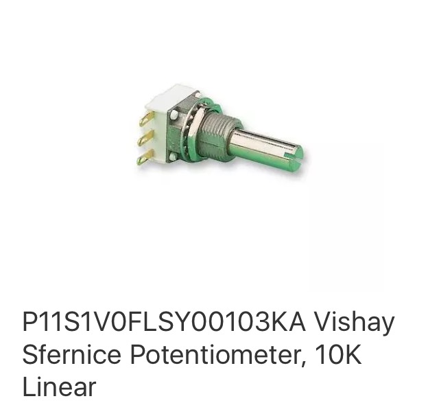

    I do not know if understood my question I and calibrated potentiometer and the motor to rotate in the same steering, if the potentiometer goes right engine goes right and likewise the contrary, I send orders from my arduino with RFF,LFF and commands received very well, even from the simtool. what and proven with the game and receives the data very well, the problem is when along the potentiometer and motor. and order a new potencimetros of recommending yourself to see if the problem is solved.

    I think I have understood ;-) that's a rooky mistake
    reverse 0V and 5V of your potentiometer and try without mechanical coupling: hold your pot by hand "like" it would be coupled.
    Please post a photo...
    - Send an order
    - See how the motor turns (cloxkwise or anticlockwise)
    - Turn by hand in the same way... the motor should slow, stop and turn backward
    - if not (motors keeps turning full speed), reverse the 0V and 5V of pot

    Hi friend, sorry for writing so late but I did not get my potentiometers arrived now that they arrived and I echo what they told me and it worked. Revive all the orders and stop in time works well, but now I have another problem, what happens now is that there are moments that I do not receive order has to move one first and then the other if they move both at the same time they stop and I do not know why . Help me, thank you for everything
  6. RacingMat
    2,233
    21,085Coins
    so the code is good eventually! ;)
    What is your power supply capacity? I suspect it's too low...
    can you please post pictures of your sim, it would be far easier to help you

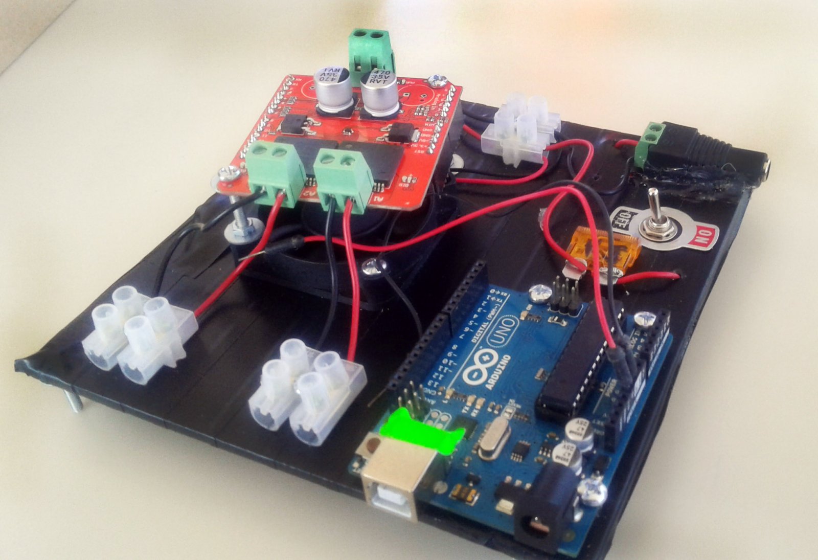

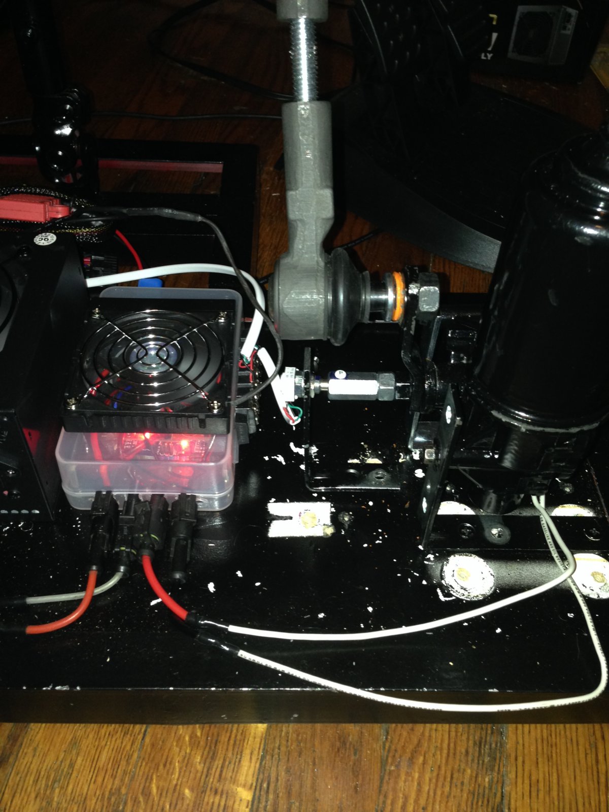

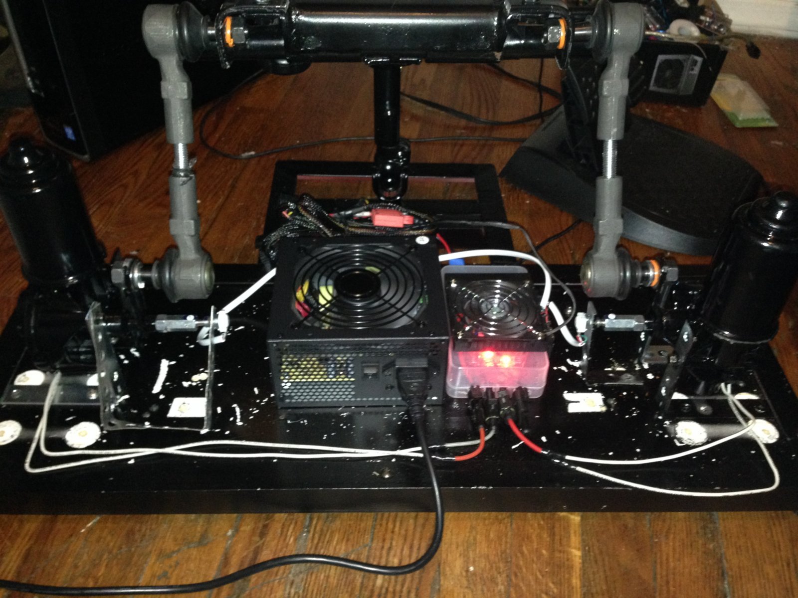

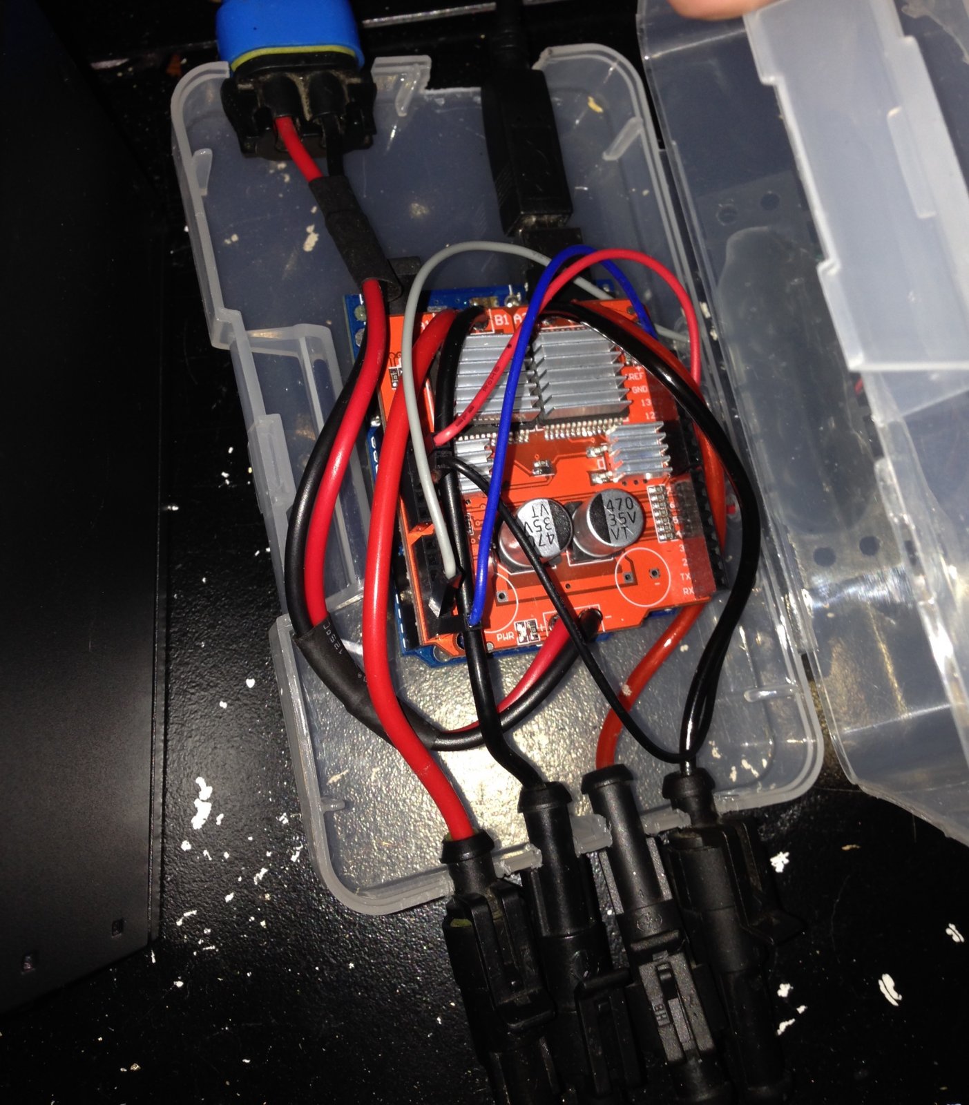

    Hi That way I have everything , I do not know if it looks good. image.jpeg image.jpeg
  11. Everh
    Everh New Member Gold Contributor
    Sep 19, 2016
    13
    Yonkers NY
    134Coins
    +0 / 1 / -0
    image.jpeg image.jpeg image.jpeg My components are: arduino one, motor monster potentiometer P11 and two motors image.jpeg

    Hi - those heatsinks look a little small - cooked one of my motor controllers - ended putting fan heatsinks to combat this.

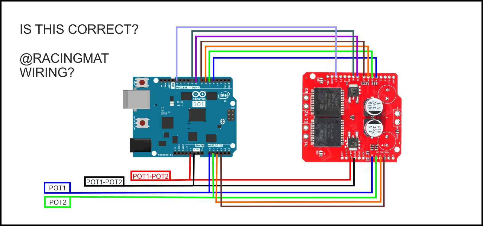

    Hi, @RacingMat, I'm building a 2DOF, I'm still in the wiring process between Arduino-MM & the pots. I just cannot understand very well the wiring. And how the pots are connected. I'm not mounting the MM on top of the Arduino, I would like you to help me to check if the wiring diagram I created is correct? I designed it following the pictures you posted only, but I still dont know if 100% correct, merci!!
    here is my components to wire.
