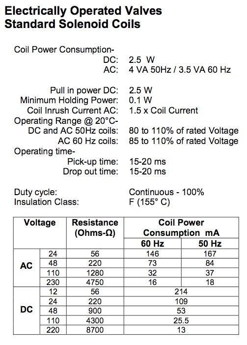

    I found some 5/3 valves for a great price here (R450 = 45 Euro each). Check it out here: http://www.kuhnke.co.uk/datafiles/solen ... 3_iso1.pdf
    response time quote from their website: Kuhnke Series 75/76 Solenoid operated valves satisfy most pneumatic system design requirements. Valves use an air piloted solenoid system complete with a red manual over ride lever for testing circuits. Air pilots are standard throughout the line. Coil systems consume only 2.5 watts of power and operate in 15-20 ms making the valve line compatible with most electronic controller outputs.
    Seems ok....?

    the supplier says that the German made Kuhnke valves have a 25ms response time... is this ok?

    BTW guys... here is an extract from the technical PDF file on those German Made Kuhnke Valves:
    http://i25.photobucket.com/albums/c97/burisch/TECHINFO.jpg
    And I emailed the guys in the USA, here is part of his reply:
    Ryan;
    Sorry the technical specs were left off of the web. But anyway the pages are attached. The operating time (Pick up or drop out) is between 15 and 20 milliseconds.
    Regards,
    Bob Hobmeier
    Kuhnke Automation Inc.
    P O Box 1369
    Wayne NJ 07474
    Tel: 973-633-0690
    Fax: 973-633-7230
    email: kuhnkeusa1@aol.com
    www: kuhnkeusa.com
    Guys think maybe these valves will be ok? Why I am keen to use these valves, is price is good, and if I were to import those other STC valves, shipping is really expensive.

    The Kuhnke valves seem to be ok. Do you have a supplier in your country for them? Just asking because you are complaining about the shipping costs for the STC parts.
    Make sure that you'll order a matching model. 5/3 middle closed with G1/8 connector.
