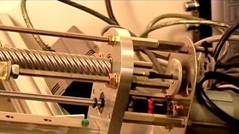

    Hehe, if you noticed his words on the mechanical stops... simply he doesn't use any!!!! He implements these stops by blocking the motor from further turning when each end-stop position is reached based on the encoder status!!!!!! Its brilliant!

    Exactly (BTW DFP and G25 using it as well and DFP has also mechanical stops) but if he dont sell his (a dont talk about AC servos) FF board i must use FF from DFP. But When DFP calibrate it move to -450° then +450 change endstop and goes to -120° and to 120° so i must do two endstops. And still i am not sure how will DFP electronic react to diferent nubers of steps from sensor ..

    hmm, a roller transmission wouldnt be able to trasmit enough torque. Have a look at the small contact zone, that only works due to friction.

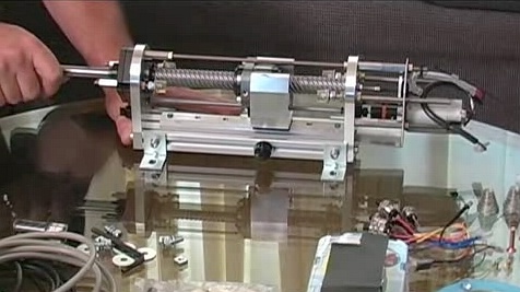

    So i was right 8) there are two screws ...

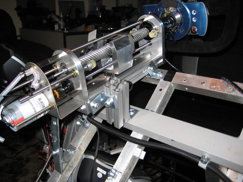

    Nice work from frex,a rollerscrew and a big ballscrew (expencife but very interesting)
    A good idee for a rotary actuator that stays within 2 and 4 o clock ,with acme screw for full lock
    and a turned sqaure axel for 60 degrade turning gided with bearings.
    My speed problem with acme screws is gone this way.

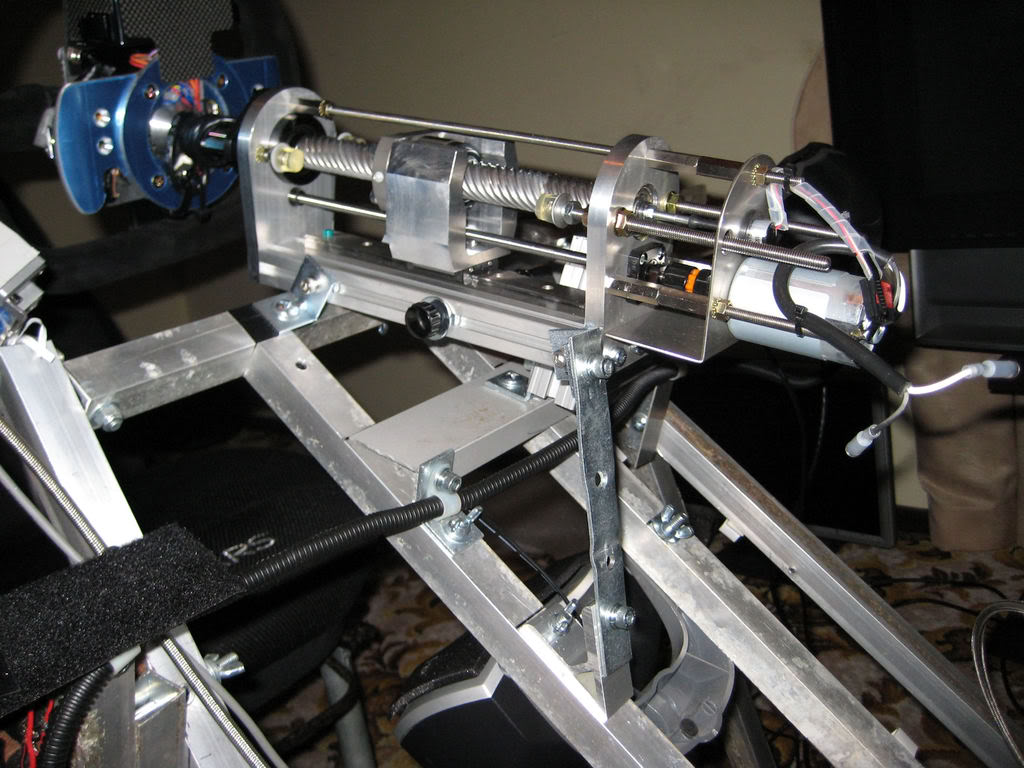

    Somebody posted new pics.

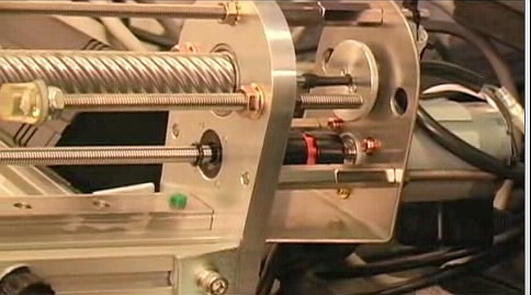

    WOW they use really small pitch on smaler screw, that is why it is so expensive. With more powerfull motor it could be less expensive and more friendly to do it DIY :D I wonder if it is really so quiet and lag free.

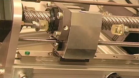

    I think the smaller leadscrew drive is one of the cheaper components on it. The big ballscrew drive and the ball bearing rail slide are the components that should make you dizzy.
    Great product, but its hardly possible to rebuild it for the average hobbyists imho.
    Keep in mind as well, that Frex purchases those individual parts for a fraction of what european or american guys have to pay for them.

    Its surprising but from certain point price rising really ugly. Make big ball screw is much cheaper than make really small (make small balls, everething is smaller, but tolerance isnt change that much). If you use more power full motor you can use bigger smaller screw, ball bearing rail slide you can replace by rail slide from furniture (i really dont know exact englis terms) it isnt so precise and so on but price is really good. On the end it wouldnt be so nice, clean and PaP but for certain better than DFP or G25.
    BTW Few years ago who would say that you will be successfully building motion kokpits and now ... :D
    EDIT: from ebay http://cgi.ebay.com/THK-HRW27-Wide-Line ... dZViewItem and you have ball bearing rail slide
    http://cgi.ebay.com/ISEL-25x10-Anti-Bac ... dZViewItem
    http://cgi.ebay.com/EMCO-F1-Anti-Backla ... dZViewItem with this two screws you have gear nuber 10/2,5=4 if you add some gearbox ...
    only price of ballnut is really non DIY :D
    EDIT2:http://www.worldofcnc.com/products.asp?recnumber=104 nice price for example C7 Rolled Ballscrew Spindle C7 MDL40x40 £13.20 for 100 mm :D and you can have i=16 with powerfull motor :D

    Well, you're right, it may be possible to save some money, if DIY, but it will be expensive anyway. And just in case the pitch of small and big screw is clear, you will be able to make a realistic calculation. But If one has to do some trial and error with the pitches, it will get expensive very fast.
    I am not sure currently, if the small screw really has a ball bearing nut. Imho it rather could be ACME.
    Like I said, I wont touch such a project before someone comes up with the screw pitches :)

    I know what you're mentioning. In fact they are very precise these days, as they are guided with balls as well.. Good hint!

    They use them in DIY CNC machines, and yes there are normal and precise typ.
