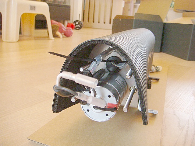

  4. tronicgr
    tronicgr
    It could be a linear motor system on the bottom, but it would have to be very compact and its another thing... I don't see any cables coming out of the bottom, where it should be this motor!
    (another enhanced photo of the motor...)
    Thanos

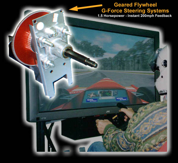

    Hi
    they are not the only one.

    That system is, from what I see, more a rumbling system, than Force Feedback device.
    Do you have a link to the manufacturer?

    Well, cyberspace, the company who invented/sold the RnR promoted it as Force-Feedback device as well, though it was joystick controlled in the end.
    But the wheel you linked has Force-Feedback obviously. It can be seen in this video.
    Regards
    Christian

    Hy.
    Ye you are a head of me with the video.
    They made it far more easy than Frex.
    Regards Ad
  12. egoexpress
    egoexpress Active Member
    Dec 13, 2006
    3,839
    Germany - Frankfurt/M
    421Coins
    +10 / 1 / -0
    But their system does not support more than ~280° whell rotation, while the Frex one is multiturn.
    Not really comparable.
    But for those who are satisfied with restricted wheel rotation, like for F1 or Dragsters, it will do the job.
  13. adgun
    adgun Active Member
    Jan 28, 2008
    538
    mechanic
    Netherlands
    5,801Coins
    +138 / 4 / -0
    Hi Ego
    It isn,t difficult to give it adjustable steer clearence.
    one little gearwheel on the steershaft with 10 tooth for example and a 32 tooth for the end locks
    when the big wheel have allso 32 holes you can put two pins in it for the lock
    and it,s easy to adjust the clearence by putting the pins in different holes.
    regards Ad
