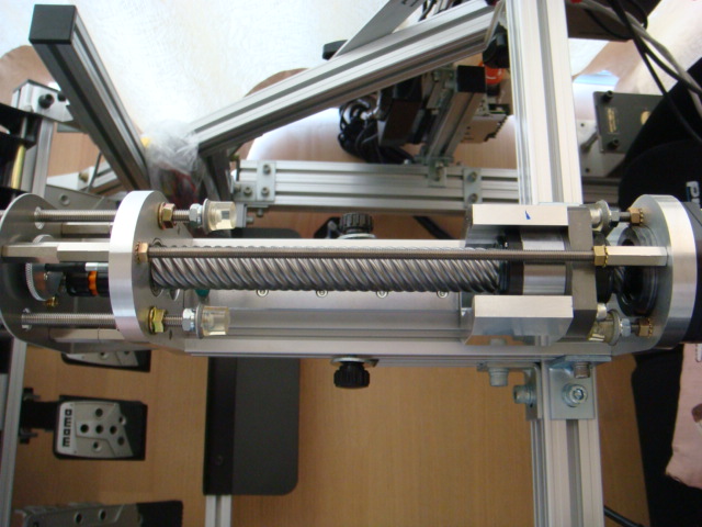

    From the pictures it looks like Ego/Tronic you guys were correct...
    The screw is fixed and the sled/nut just seems to be used against the end stop bolts at each extreme.
    The motor *looks* like it's geared directly to the screw with a very flimsy looking gear at the back. No giant motor hidden inside ;-)
    Perhaps my interpretation if those images is wrong but I can't see what would mean that there was no backlash or that the ffb was so massive as everyone says?. The motor and associate cogs look very small.
    We really need to see some more detail at the back of the unit where the motor is and the end of the screw is being driven. It does look like there is something else there and it's quite hard to make out where the drive is coming from.

    Though it is really impressive, there is no miracle under the cover :D
    Like I thought, there is a spindle to restrict the wheel movements. But instead of a lead-, they are using ballscrew-drives, which makes it alot more expensive.
    On the left side I am able to see a motor coupling (orange), while the silver colored toothwheel looks like an encoder wheel, which is connected to the motor shaft.
    A detail pic of the coupling housing (left part) would be helpful.
    The rail behind the spindle is imho just a lead for the slide, which is conneted to the ballbearing nut. It's purpose (slide) seems to be to protect the nut against rotation.
    Perhaps the slide is equipped with some rollers inside to reduce friction, as well. But I am not sure in this point.
    As the motor is placed off-center, there must be some kind of transmission to the spindle.
    Its not visible, but I think it could be a friction wheel, with a transmission of i>1.
    And in the end there is no megatorque motor used at all ;D

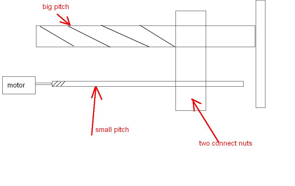

    They could have two screws one with big pitch (the bigger one) and second with small pitch. Like on the picture

    With system witch i draw it would have no backslash (if they use pre tension nut (i dont know correct translation)) even if they use normal nut it would have really small backslah.

    You are right, it could be made that way. But wouldnt pre tensioned nuts produce alot of friction and wear?
    As well from the pov in the picture it does not seem that there is another ballscrew nut behind the visible one. Do you think it could be a leadscrew nut for the motor spindle?.

    Well who knows what they mean by no backslash ... (ballscrews witch are using on CNC with 5 mm pitch could have backalsah 0,01 mm or less ! and tensioned could be regulated). Another ball screw (with small pitch) must be very small (and pricely :D ) so it coud be inside that central aluminium console (you can see on the picture that holder of nut continue to that)

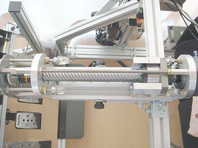

    Here is an enhanced photo of it...
    Still not much can be seen about the motor transmission but I'll try to ask clarkii2 for a better photo of this section. It can't be another smaller screw aligned with the motor... it would make difficult to backdrive it by hand! I should ask if he is able to rotate the wheel easily if not powered to confirm this!
    Regards, Thanos

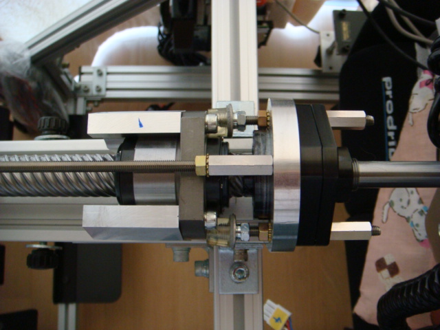

    Ball screw with standart pitch can be rotated by sliding nut very easy. But on yours en. picture it isnt really looks like that there is another ballscrew :(

    Internal recirculating isnt problem every nut has it.
    I am still thinking that motor moves with nut not the screw. Because if they powered screw and nut is there only for endstop its REALLY wasting money!

    Ik looks like Ego is richt ,i think olso that the nuth is sliding on the groundplate
    They writhe you can mechanicly adjust the steering clearence 1080 degrade max to what you want
    I think they do that with the left 2 screws on the upside, you can see on one of the first foto,s they are long enuff.
    On the last picture you can see on the left side that the alloy gearwheel is conected to (probbely the planetairy gear)
    and to another shaft under the roller shaft with orance coupler,the two gearwheels are then for compensating different
    pitsch from the shafts,otherwise it wont turn.(for Mambo,s drawing)
    It looks there is a bearing under the rollershaft on the left side, but i dont think there is a smaller shaft.
    I want to see a picture on the richt side to, it looks like the roller and steering shaft aren,t in line also.
